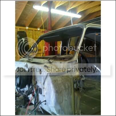

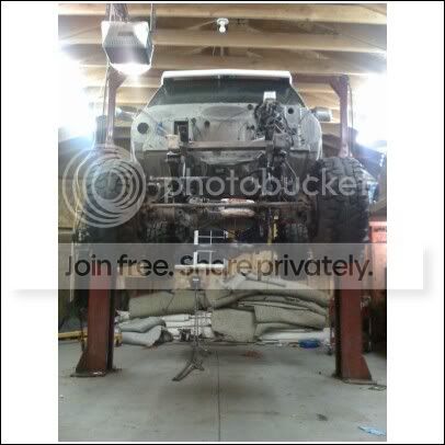

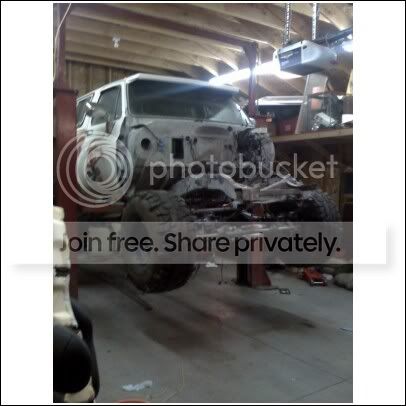

AHhhhHHh so nice my buddies evo finally finished and his garage is now mine .... what a good friend to have that happens to have a full hydraulic lift!!!
My vactaion starts tomorrow i have the garage and a week to really get cracking on this project!
Rust!! Oh my god its unvbelieveable how long it is taking to derust this pig and i got the tank off the other day and the whole ass end is rusty there is too many places i cant get to i give up its time to haul this thing to the sandblaster!
I spent all day with naval jelly, 2inch grinder , 4" angle grinder ... i didnt even get the inner frame section preped good enough for paint so hopefully a blaster has an opening tomorrow or the next day so i can actually get this show on the road.
Once the frame and cab are painted up i can do the shackle flip, install the new bds rear springs, the inboard shock kit, ford shock towers and slap the bilstein 5150's on and i will actually feel like ive acomplished something.

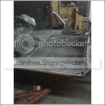

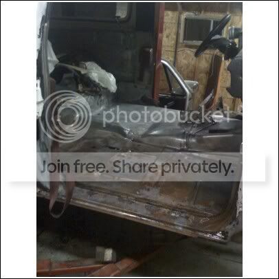

rust like this that i can actually get to isnt so bad to fix up and doesnt take too long
there good as new! except for a few sheetmetal rust holes ill need to patch

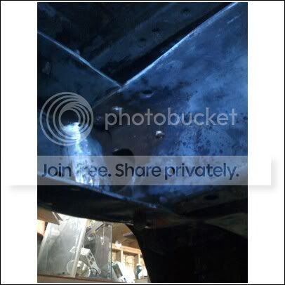

heres a problem just for example i cant reach that rust up there .. i spent about an hour and a half with naval jelly on that spot and the pits nearby it ... the rust just laughed at me .. so i bought a cup style wire wheel and took the guard off the grinder and attacked the spot but the main prob is the pits are still holding rust .. its spots like these and all the other countless places that i cant get a grinder in that made me throw in the towell!
angle grinders are the ****, but they can't reach everything...
I always buy 5" wheels for my 4 1/2" grinder, they can usually reach further.
Sand or soda blaster can get them :D

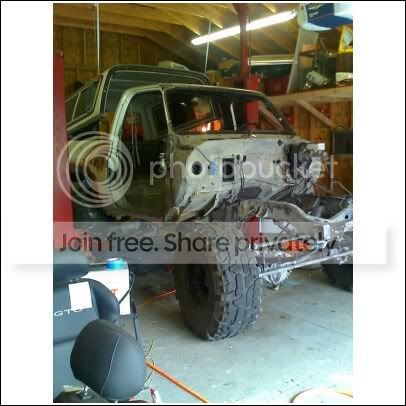

here is where it sits right now
completly striped and ready to blast ..body is sittin on hand tightned bolts so the body can come off while down there ...
they are going to plastic blast the body panels and sand blast the frame ..when it gets back it will be time for paint !
