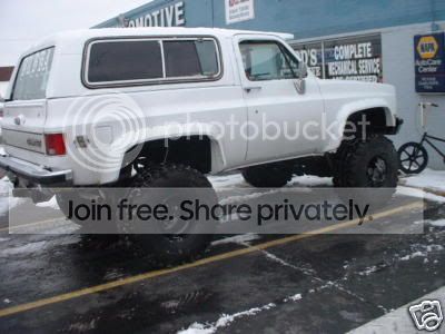

Ok so heres the blazer as i picked it up it came with 8 inch skyjacker lift, corp 14bff rear and dana 60 front disc brakes ord x over steering 350 sbc chevy with 3k miles on it mated to a th400 tranny then to np205 tcase .. the front and rear driveshafts are custom cv jointed and can extend or compress about a total of 10 inches ior so there was a recipt for 2400 bucks on these babies !

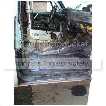

First thig i did was survey the rust .. it wasnt too bad but still tons of work to do i started stripping the interior which had herculiner done to it but i could see rust coming through it so that plus the fact that laying sound deadning on top of that meant it had to go ... i started with the ole wire wheel and 3 hours later the tail gate wasnt even done this stuff doesnt like to come off ... i tried laquer thinner .. no dice .. i tried a heat gun ... slightly better but still worthless ... i finally found something that worked AIRCRAFT STRIPPER!!!
Ill tell you this you cant layit on thick enough the more the better so 3 gallons later here is where im at
The entire interior was covered in herculiner and bondo this took a lot of work to do and im on my 5th wire wheel!
I found 4 rust spots that need sheet metal patches nothing to serious ..

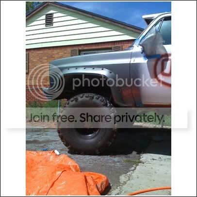

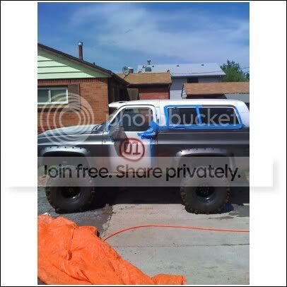

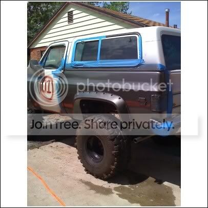

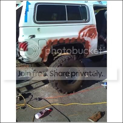

Next the body the inner wheel wells were a rusty mess and the front fenders were cut terribly and banged up so i ditched em and got new inner and outter fenders but first i shot some panels to decide which color i wanted to use
I went with the color on the front fender.. the paint is ppg single stage polyurethane .. the frame and body will be shot with epoxy primer then the body with the gunmetal grey and the frame with a gloss black
After i decided on the color i striped the body apart, ditched the cheesy flares and filled in the screw

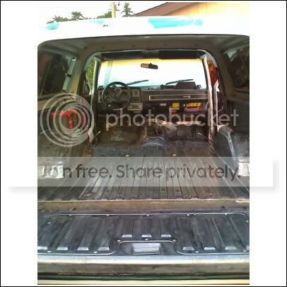

As the interior is almost done ill be doing the sheetmetal repairs and filling in the random screw holes through out the tub... its amazing how many there are prob 50 at least wtf!!!

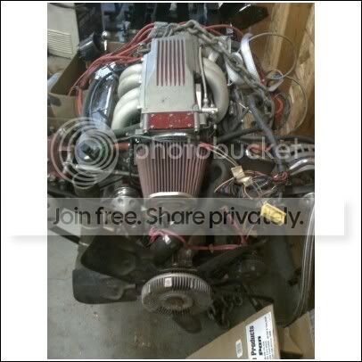

I started thinking bout fuel injection i had a recipt for the motor i knew it was a crate motor and was put in feb o8 and had about 3k miles on so my plan was to get a tpi setup for it ... The more i researched the more i understood how much this was gonna cost .. there was maf or map there was new system or ebay then there was the issue of if it had the ecm or didnt and if it had the wiring harnesses ect ect... it was a ton of stuff not simple like i thought ... so i considered a tbi setup .. but i wanted good power then i considered a 454 swap .. much looking around to no avail .. i put the motor on the backburner till i found this motor for sale browsing here on ck5 :p
MMMM pretty :p this is a 400 sbc with map sensor tpi ecm and all wiring harneses pulled from Hoppers K5 he was parting out (Thanks man) This was perfect for me because i got alot of other stuff i needed with it Ac comperssor, condensor and evap canister.. Aluminum radiator tranny and oil cooler

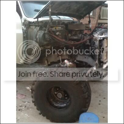

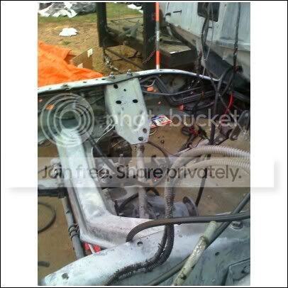

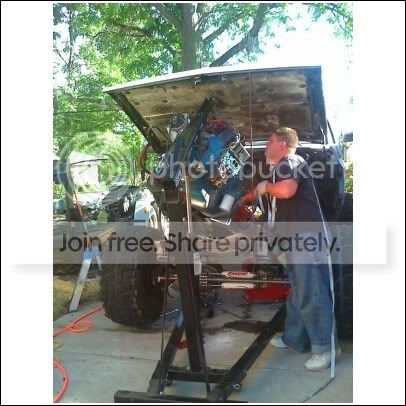

So with the engine problem solved may as well pull the old motor out !
(which is what i spent my saturday doin)
Bye Bye old almost new 350 sbc :p Thats my buddy fish in the pic im doin all the work at his place its nice to have buddies who have 900 sf garages filled with every tool imagineable and a hydraulic lift :p

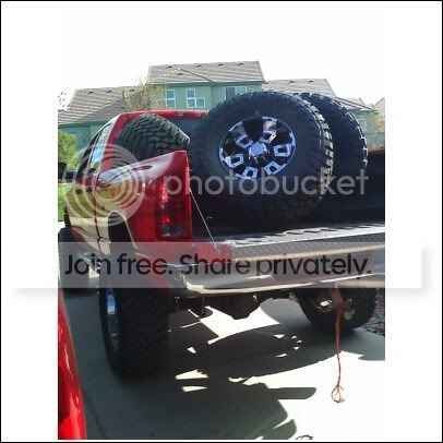

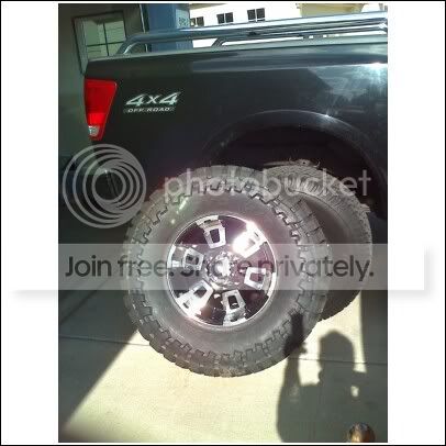

For the wheels and tires i went with diamo 18x10 aluminum wheels with 38x15 x 18 toyo mt's
As i will be daily driving this rig i liked this tire for both its on road and off road user reviews
The 2nd pic is of my tire leaning up against my buddies titan with 6" lift and 33's hahah makes his truck look puny !

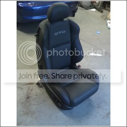

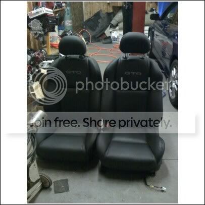

I debated alot on the seats and have been ebaying for about 2 months now getting outbid on the tahoe seats i wanted but i decided on these seats for 04-06 pontiac gto they are power on both driver and pass and are heated plus in 2 months ive seen tons of light grey and tan tahoe seats but only 1 set of dark charcoal which got bid to stupidity
Ill have to fab up some kind of adapter in which to mount them.

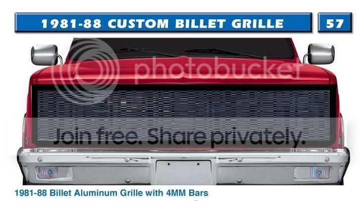

Ill be also building a custom grille i mocked up a rough idea of what it will look like im going to run the grille over the entire front end covering everything .. the center of the grille will be a perforated aluminum sheet and the bottom lights will be converted to hid's while the tops will be swaped out to 6" xmitter bars
So here is a frontclip like my blazer
This is the design im shooting for a big ass grille that basically covers the entire front end the grille material will be a perforated aluminum kinda like the grilles on gmc yukon denalis but with a smaller hole pattern

Looking good! Um .... Whatcha gonna do with the flares?
I tossed them they were beat up and cracked and cut terribly .. Im still undecided if im gonna run flares or not on the finished product id kinda like to run a less extreme kinca flare that wont find a way to get ripped off the body as flares like to do

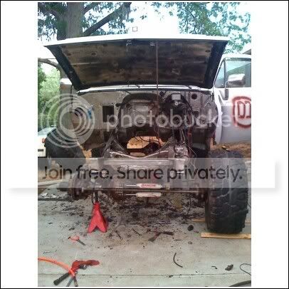

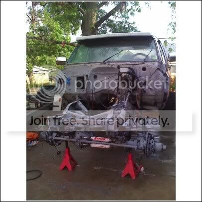

Gettin real close to frame and interior paint.. been grinding and prepping still and i should get the garage tomorrow and I decided ive gone this far may as well pop the body off the frame!

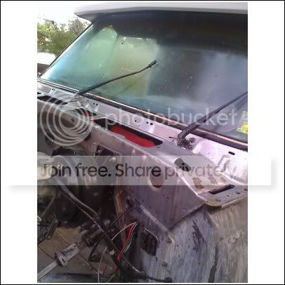

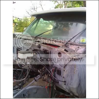

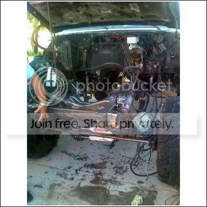

Startin work up front on the firewall removed the evap blower shroud and discovered the po yanked the evap core :mad: bah so i ordered a replacement shroud with the evap core .. cant live with out ac ! Theres my favorite chemical there ... aircraft stripper !

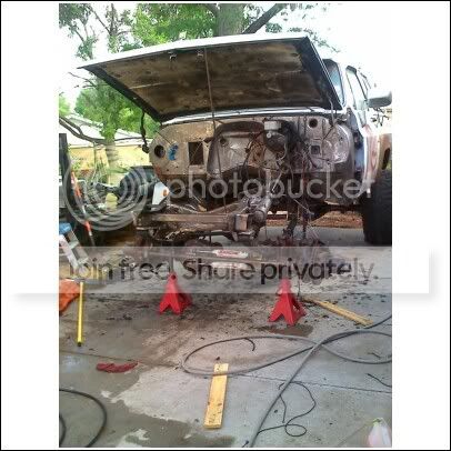

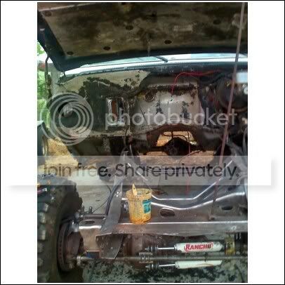

So on the inside of the frame theres alot of brakelines and brackets and various other stuff that makes ginding impossible so what i did was slather it up with loads of aircraft stripper and then i blasted it with a 2600psi pressure washer .. thi method worked great other than taking a shower in a caustic chemical that is
theres a shot of the inside after blasting... i could literally watch the metal rust when the metal started drying so i sprayed everything down with a diluted solution of about 1 part naval jelly and 4 parts water this took care of the flash rust and kinda protects the metal in the meantime.
Next i yanked off the hood and vent covers and slathered the cab under the windshield in aircraft stripper
And heres where i left off tonight the grayish color your seeing is after the misting of the naval jelly solution dries .. i start my week vaction tuesday and hope to be painting by thur or fri and then i will be fabbing a completly new fiberglass dash and center console!
