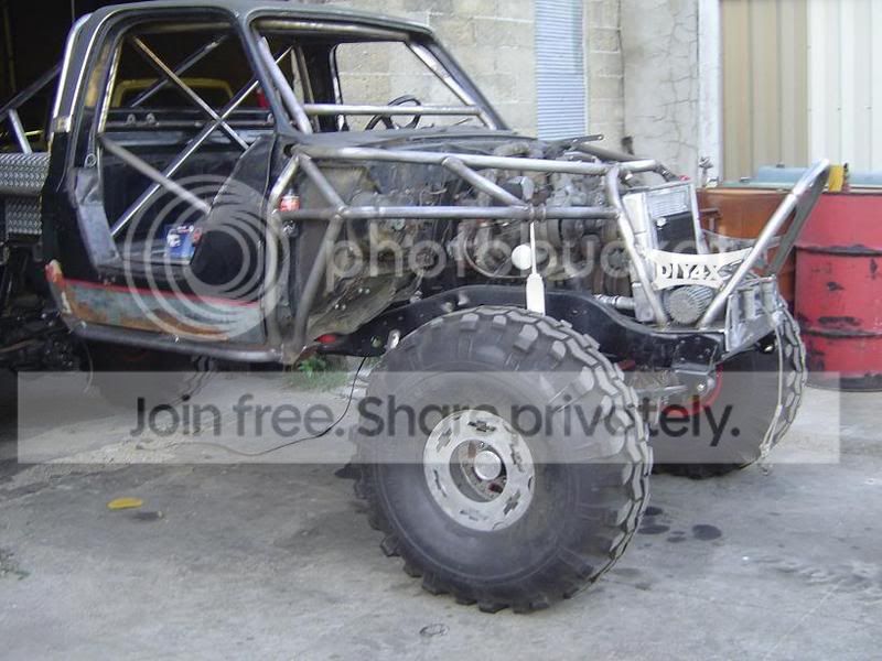

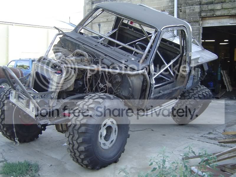

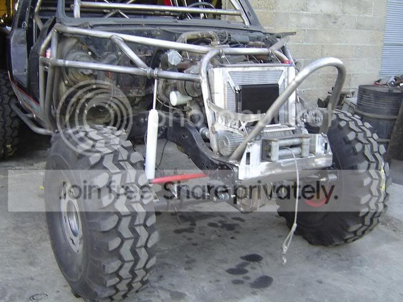

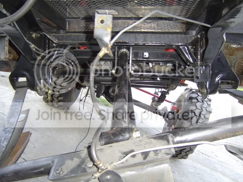

Brett those braces look awesome...I take it Kert came up with the idea then:wink1:
Drey said:
Hey as long as Blue is sitting outside we keep getting rain...I made that comment to my dad tonight and he said to leave that ****in truck outside till the corn starts to turn then:haha:
It was a joint idea. We drafted several things before we came to that.

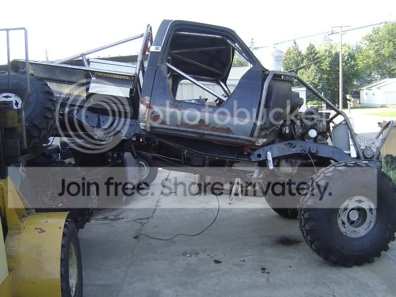

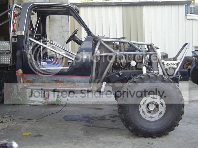

44" under tire without Wraptor
45" with the Wraptor installed.

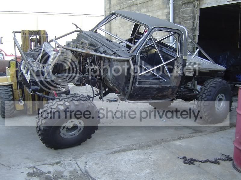

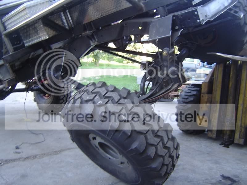

muddermilitia said:
Beautiful! Those are 56" springs in the back with the long side forward?
I'll field this one for ya stomper,
Ford 57's with the long side forward. Couple leafs added to the pack to shore things up a bit. They are stupid soft!!!!

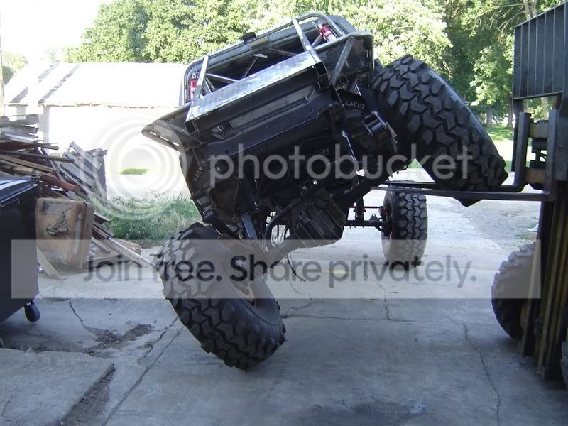

Chaddy said:
What kind of flex do you have with your drivelines in? Are you gonna have to strap it?
Don't have the drive line built yet, but we'll be build long slip so we don't have to limit the travel.
We'll be doing inner fenders and hood along with a little bit of this and that but the front is about done.
Yea, that is the Wraptor cross member.
