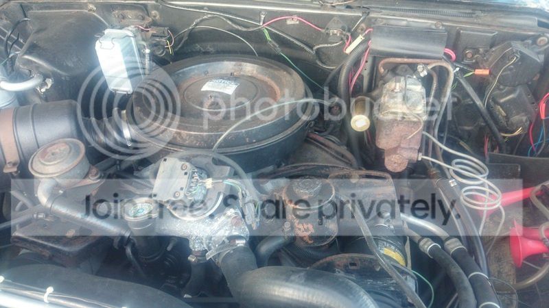

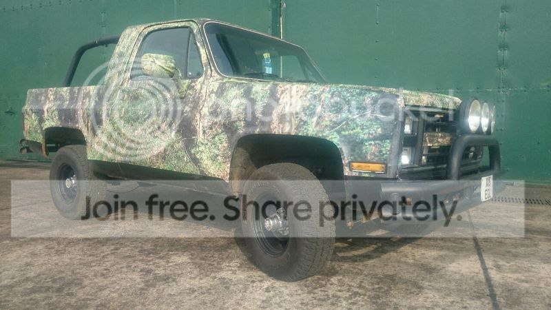

Hiya all, just picked up my first Blazer over here in the UK, got a Mustang and an old Dodge so thought it was about time I add a Chevy to the yard :waytogo:
Has been mucked about a fair bit before I got it, been turned into a pickup and a bulkhead welded in, also was used as a shooting truck so has been covered in camouflage vinyl wrap :eek1:
Motivation is a pretty tired 6.2 diesel, its running a NP208 and the drive train looks pretty standard. Haven't managed to ID the transmission yet, cant find the tag, but assuming its a 700R4.
Body tag says it had decent options originally, a/c, cruise, HD towing pack etc.
At the moment it goes OK, kinda :rolleyes:, uses some oil, transmission is slipping in and out of lock up in top at 60+, doen't like starting that much even though its not cold - normal sort of stuff :doah:

Cheers guys :), yeh, they used the car for shooting so the roll bars were a rifle rest as well - could have mounted a 50 cal for the size of them!!
They also made the front and rear bumpers/nudge bars, which probably weigh as much as the truck lol

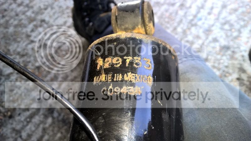

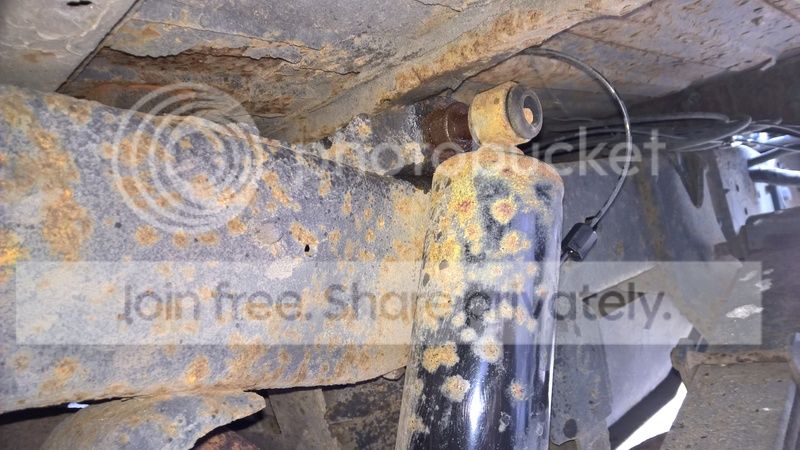

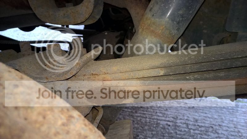

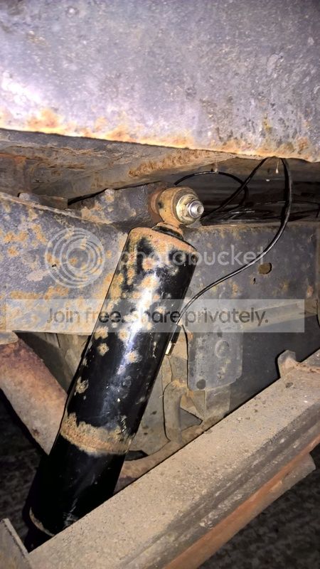

It has got air assisted shocks fitted, look like Gabriel Hijackers? Springs look standard complete with a snapped leaf :doah:

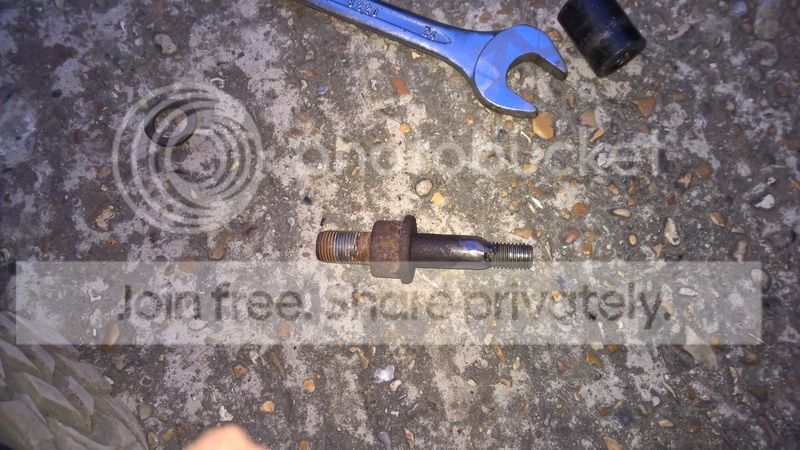

Also the shock was hanging off the top mounting bolt, turns out someone had stripped the thread. Didn't have a bolt similar size so cut off the stripped thread and welded a new piece of M10 on.:rolleyes:
This thing has had a lot of plating on the rockers etc althought the main chassis rails look good, the inner wings are all shot though.:frown1:

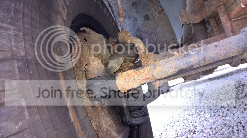

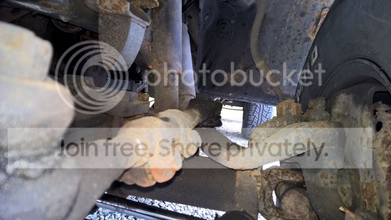

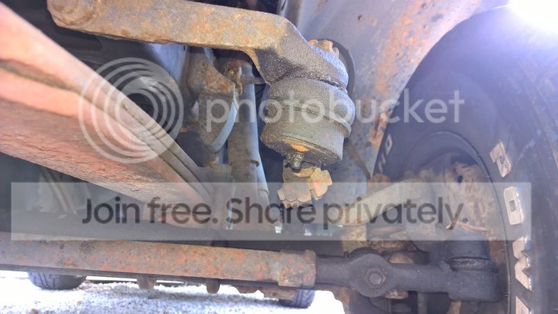

So question for you guys, need to figure out which parts I need to order as the setup seems different to what my Chilton manual shows. I have 1 straight bar across the front connecting the two hub, then a tie rod from the Pitman arm to the back of the drivers side hub assembly. Need all 4 ball joints, plan on ordering Moog but as I will need to get them shipped over from the US I want to make sure I order the right ones!
Any help with part numbers/descriptions would be great :waytogo:

IIRC the tie rod is a long bar with a tie rod end attached, an adjuster sleeve and a short tie rod end. Mine was fine so I left it alone.

Sounds a similar setup, 1 long bar connecting wheels with an adjuster at one end (pic 3) then a drag link from Pitman arm to the steering armj on the hub with a ball joint at each end.
need all 4 as they are all badly worn.

If it's a 10 bolt front the pn#'s will work for you.
BTW, I'd do axle U-joints while you're at it too. They're pretty much in your hands already...just good insurance. I did mine with forged Spicer's while I was doing ball joints et al.
Yep, tierod is the long one. Draglink is the short one.
Ball joints will take some work doing.
Like Glenn said, inner bearing seals and U joints. Also look into replacing the axle bearings inside the spindle (not wheel bearings, those are different, but probably need changing/ greasing too) Ditch the needle bearings for these Longfield Axle pieces: https://www.trail-gear.com/TG/prodInfo/image/301694-2-KIT_ID.jpg
Also, check the frame for cracks around the steering box. It happens often and is best checked with the box off (like when replacing everything else :) ) The steering shaft going from the column to the steering box can also have some play in it.
