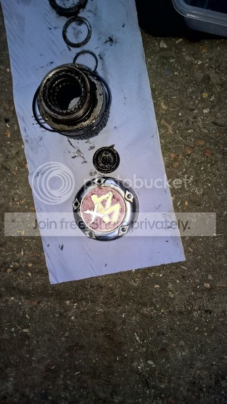

Pulled the freewheeling hubs, do these look like standard fitment?

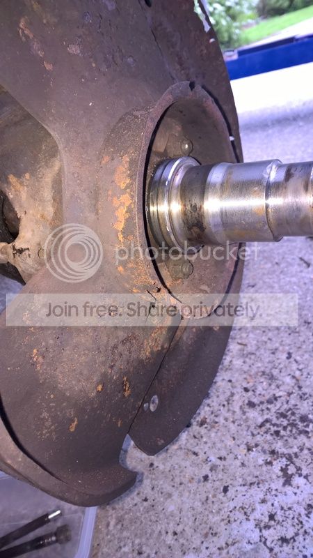

Got the hub off, retaining nuts/lock rings had been hammered to pieces by not using the right tool, looks like some wear on the spindle and inner hub bearing as well - will see how well this cleans up

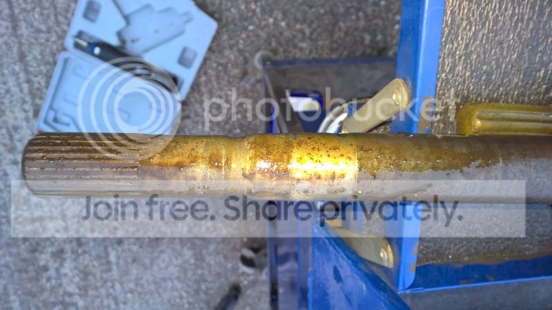

Then pulled the drive shaft. The UJ is actually quite solid but rusty as hell, rather more worryingly when the shaft came out it had a very watery oil mixed with grit on it:doah:
Figure the diff cover seal has gone south - will open all that up to have a look another day.

A bit of fine emery paper should clean up the spindle seal surface, unless it's more deeply scarred than it appears in your pics. Hopefully that gritty slush on the shaft is more from the inside of the tube than from the inside of the diff.
It would be a good idea to make a rake with a similar radius to the inside of the axle tubes so you can drag the accumulated gunk out before re-assembly. Doing that can be the difference between having leaking inner seals later, or not. The inner seals are a pain, as you could imagine.
