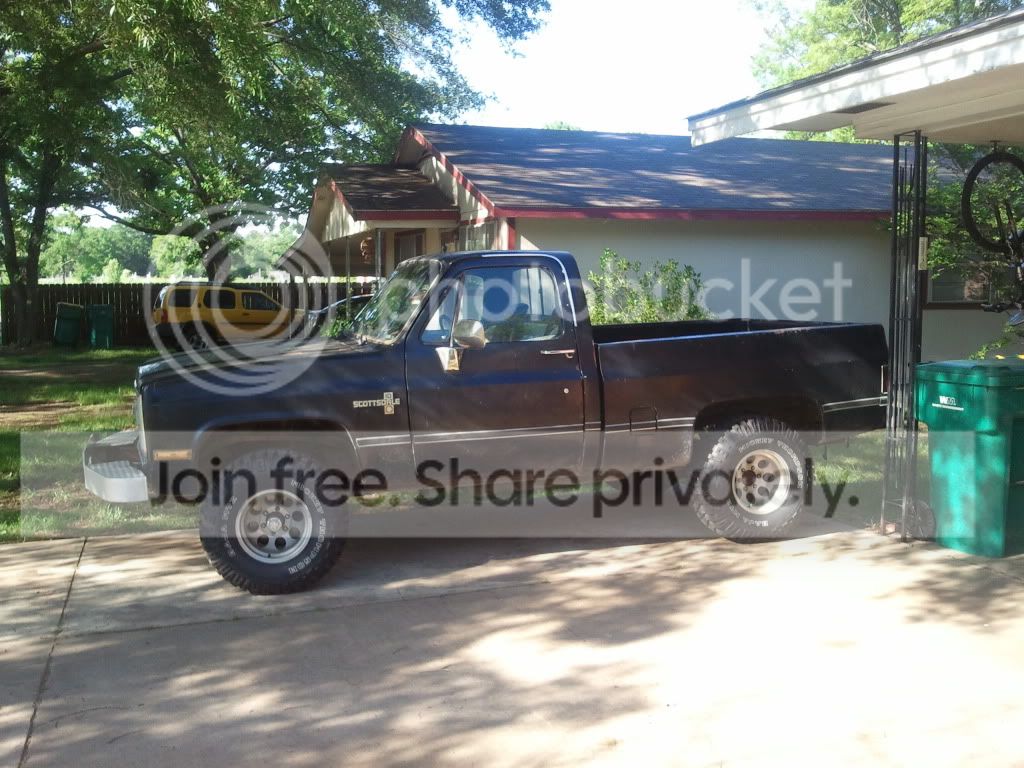

Here is the truck. No lift, just sagging springs and sitting on 33/1250 MT ATZ. Ignore the f-ugly allumimum front bumper..It will be going to the recycling center and be replaced with a steel plate style bumper.

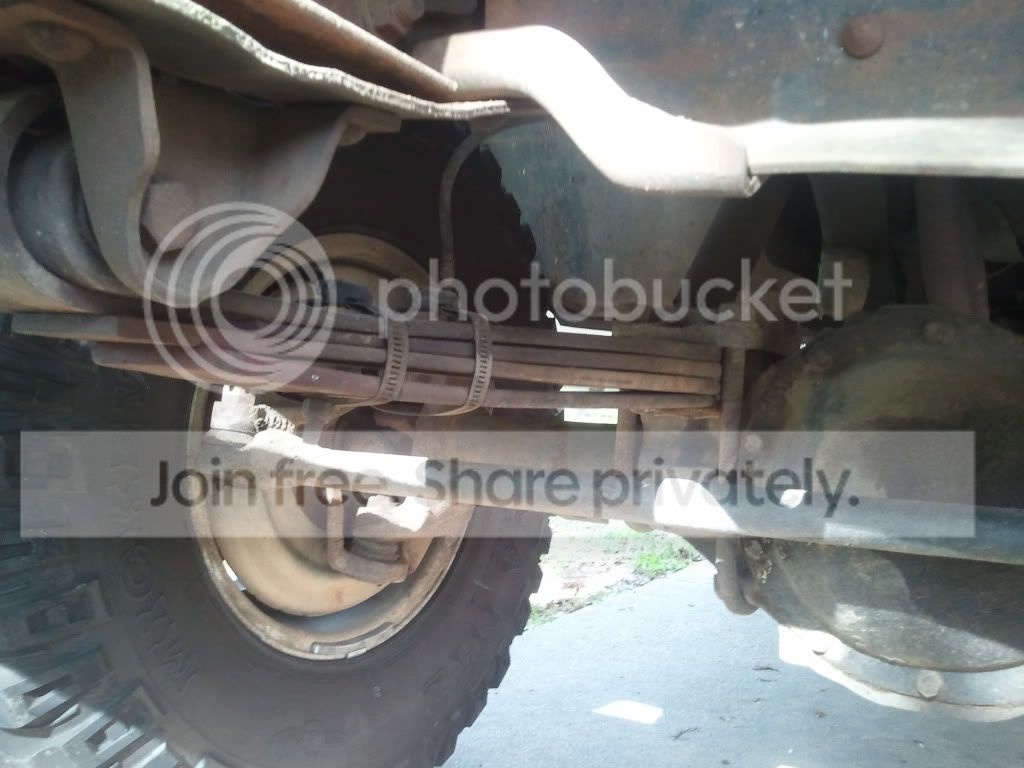

Here is the past flat springs with a PO installed add a leaf.
Ya I don't know were or for what but the added leaf are weird. I get more suspension from the flex in the tires than the front springs lol
Lol ya. Idk what the op was thinking. I haven't had any prob with it other than no give in the front so I haven't messed with them. The whole set is destin for the scrap pile lol
