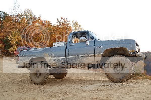

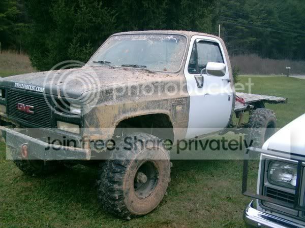

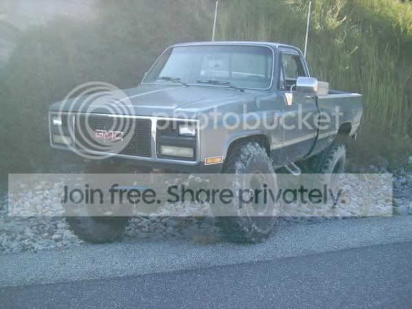

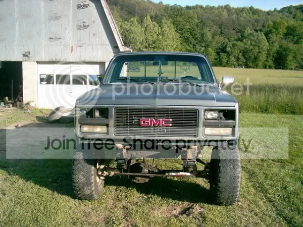

Well Ive been here a while and thought I would show what looking at everybodies different ideas on building our style trucks at ColoradoK5 has changed my truck into, I had already put the 4in lift and 33's on it before I became a member here. This is over a 3 or 4 year period of changing my mind on what I wanted to do to it.

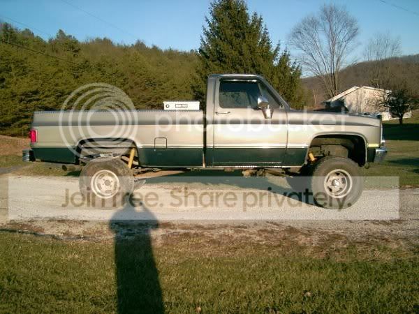

Ive got a 1986 GMC High Sierra with a 305/400turbo/208, d61 open and d60 factory powerloc, 4.10 gears, 52in springs in the front and 56in springs in the rear with a shackle flip which comes out to around 4inches of lift.

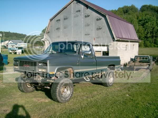

Don't have any pics of when I first got her but here is the first mods: 4inch lift and 33's

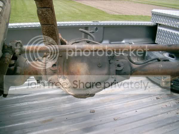

I blew the spiders out of the rear 10 bolt so I swapped the rear 60 in its place and put a 8lug 10 bolt up front, both had 4.10 gears

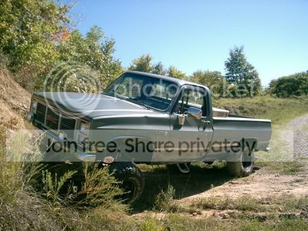

Some 4inch lift flex

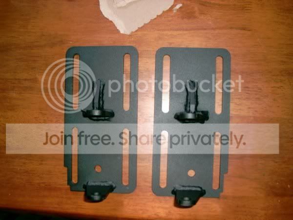

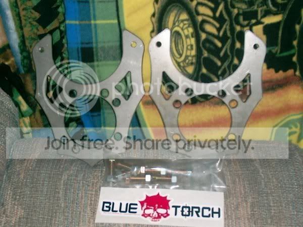

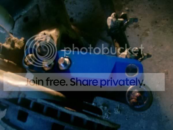

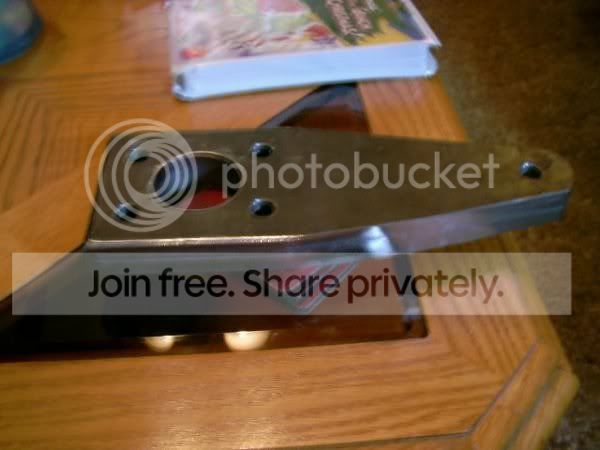

Dics brake brackets

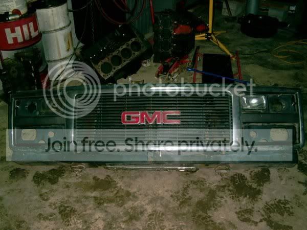

89 blazer grille and core support I gave $60 bucks for

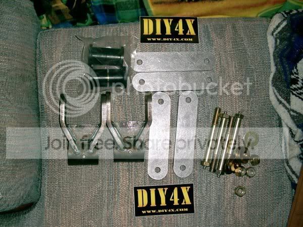

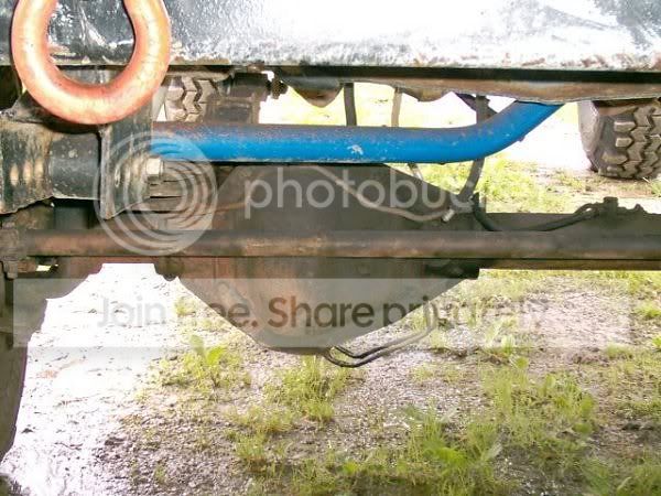

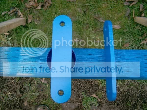

Longer shackles, greaseable bolts, hd shackles for the rear

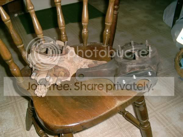

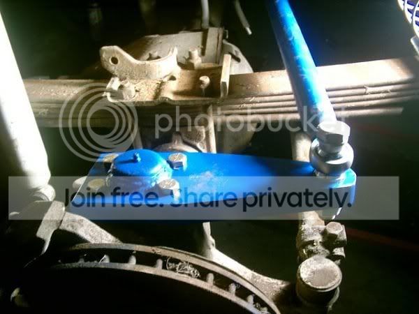

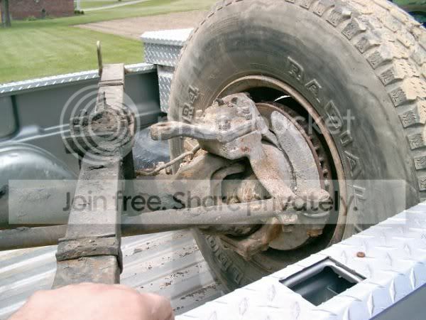

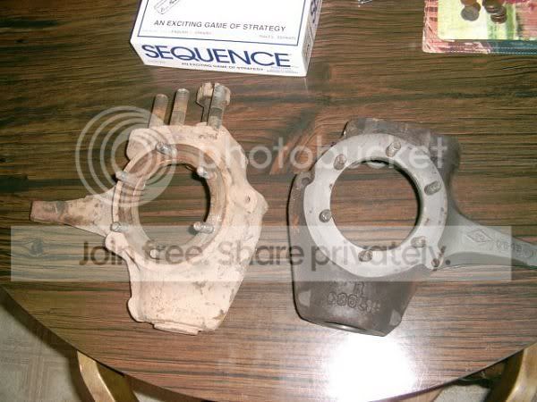

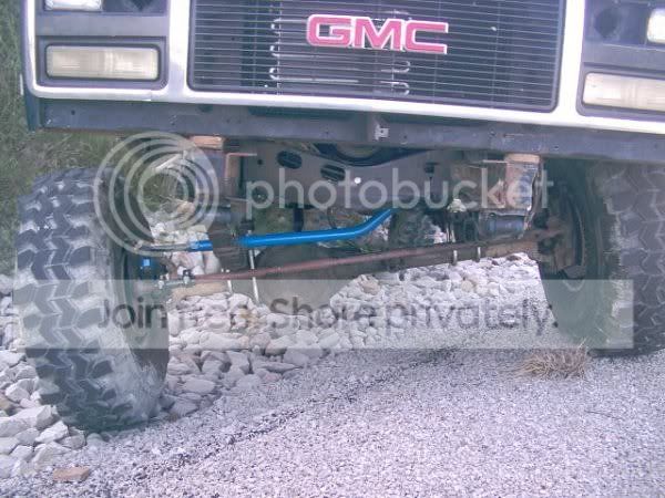

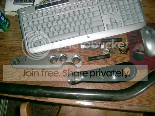

Dana 44 knuckles to swap onto the 10bolt for crossover steering
swapping the grilles out

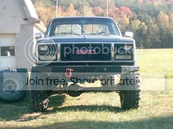

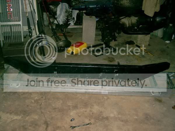

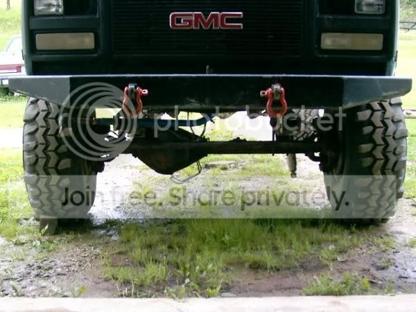

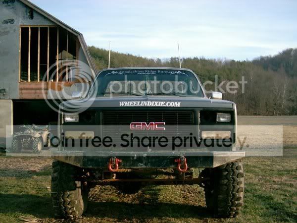

new front bumper

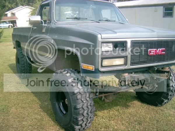

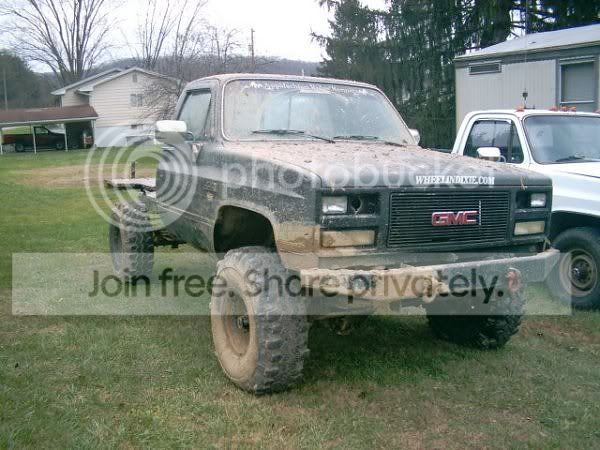

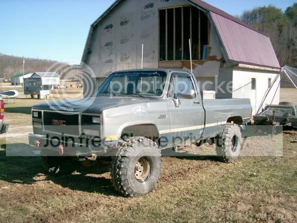

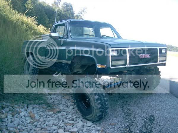

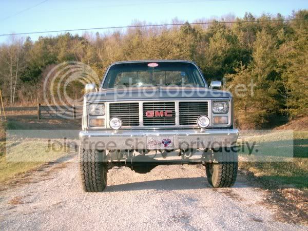

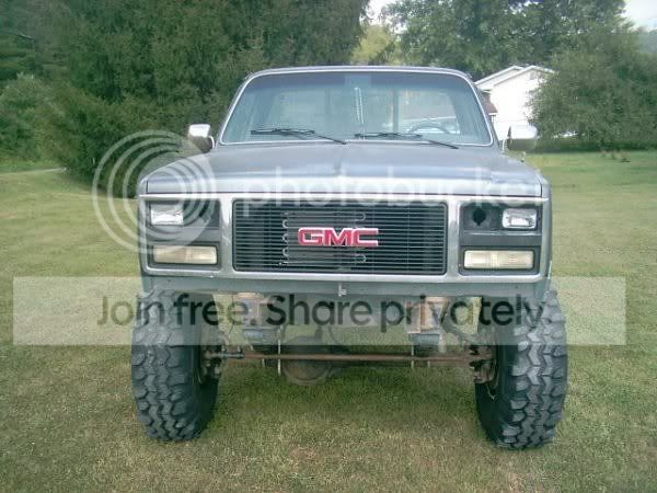

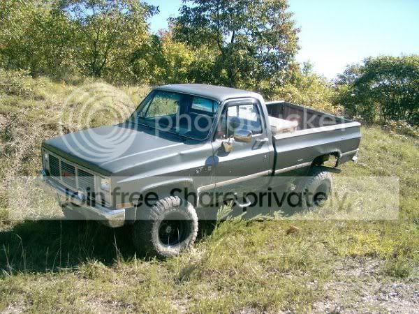

new grille and 35's

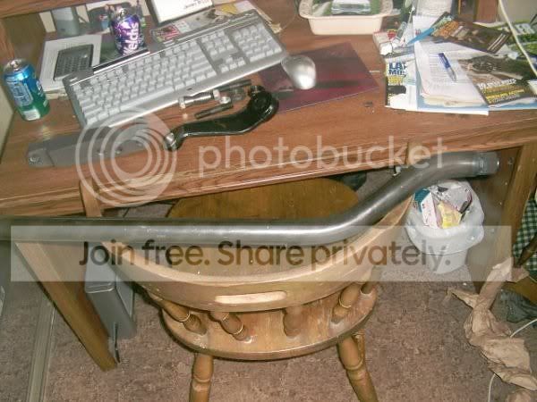

crossover steering parts

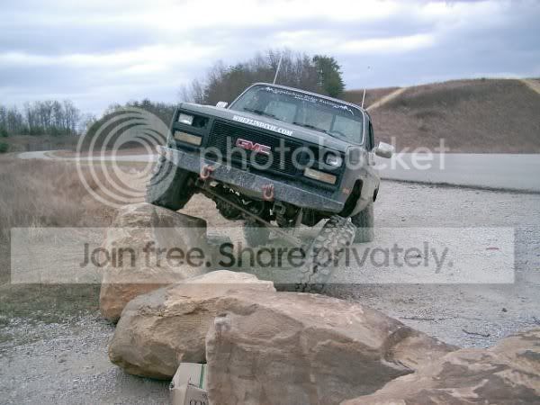

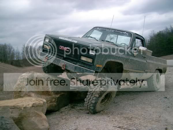

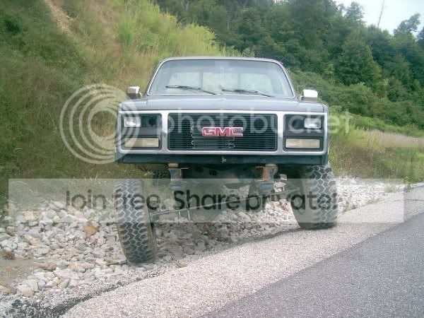

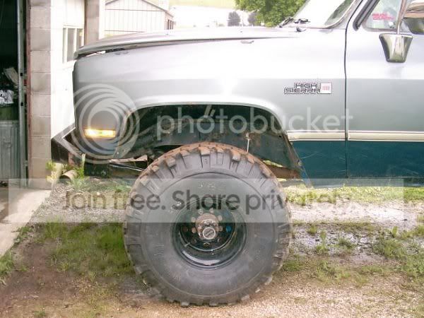

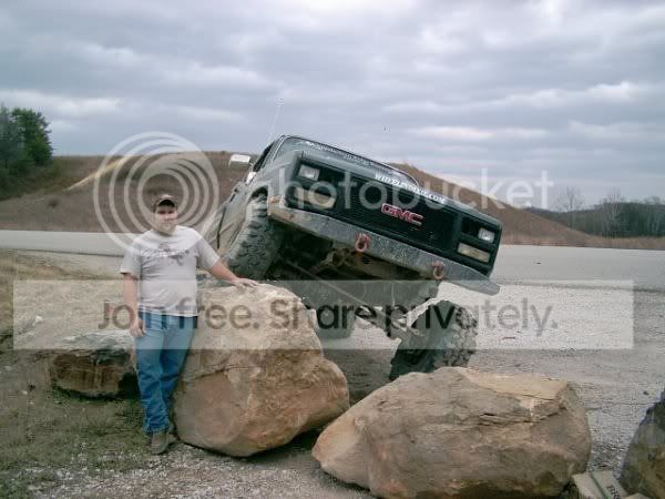

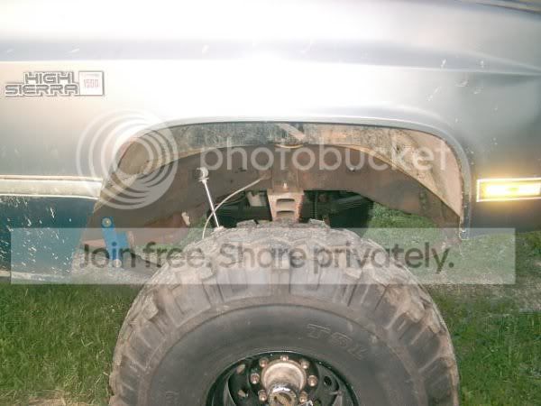

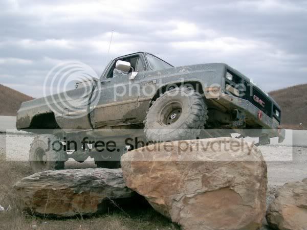

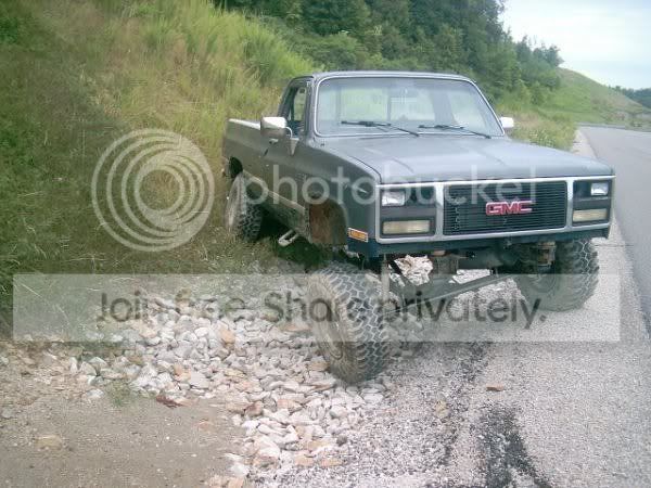

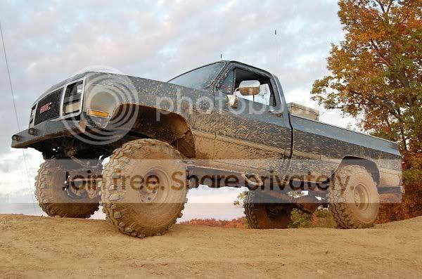

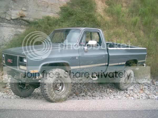

some flex with 6in lift and 35's

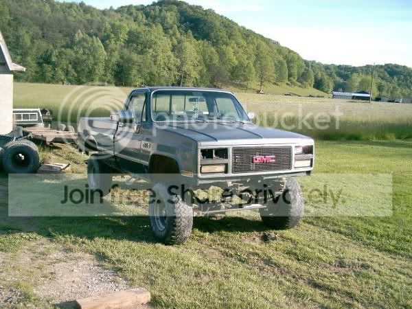

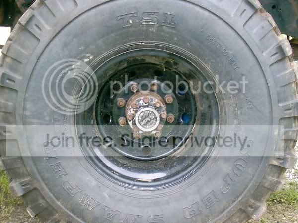

new 38 tsl's

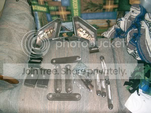

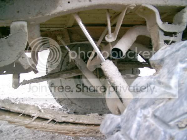

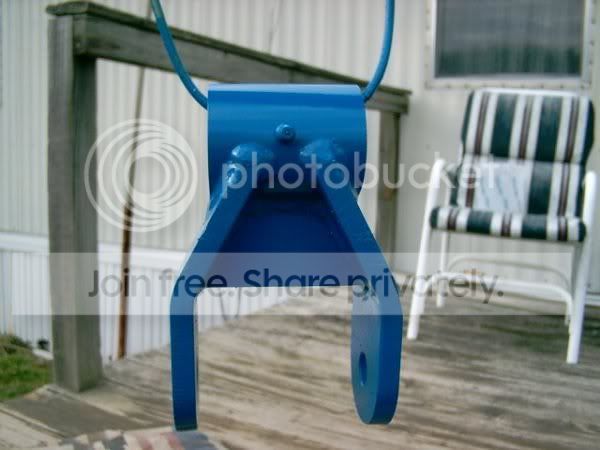

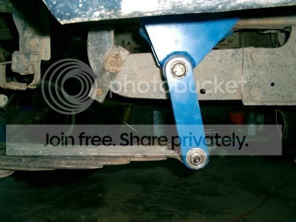

more parts; shackle flip, 6in long shackles, zero rate

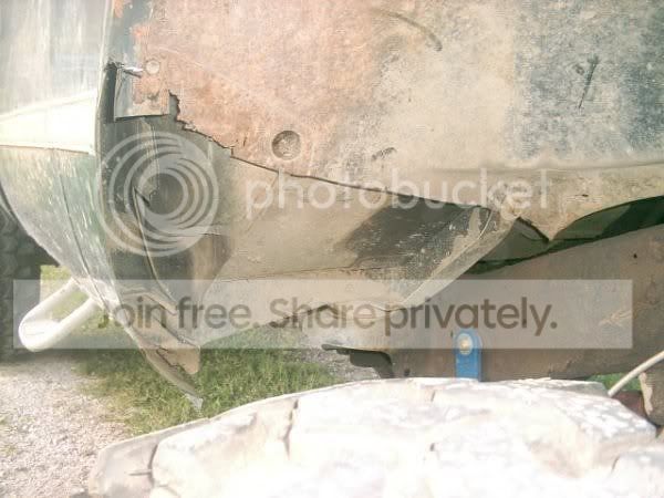

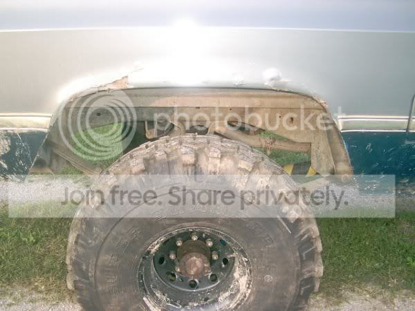

alittle trim of the fenders

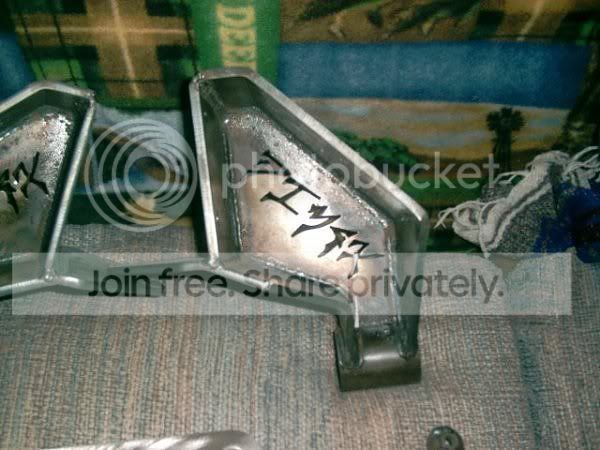

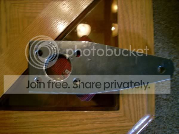

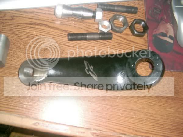

steering arm installed

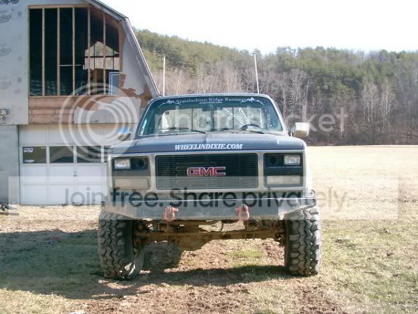

flex with 6in lift and 38's

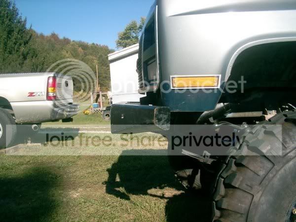

bumper installed
shackle flip installed

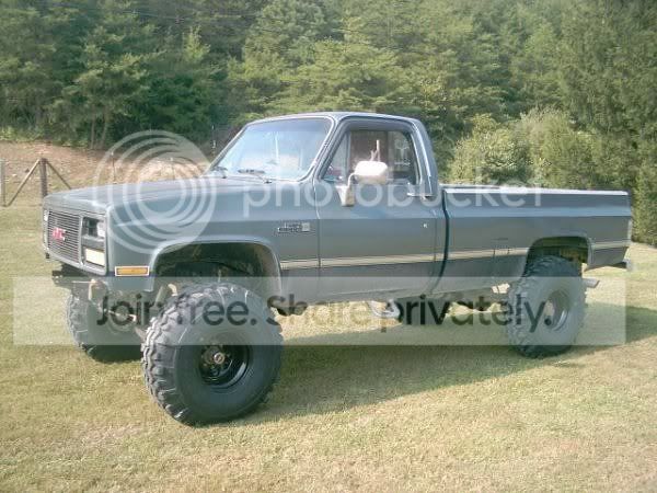

how she sits with 52in springs out of the rear of my truck on the front swapped in
grille painted satin black

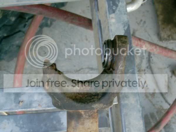

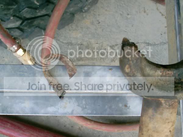

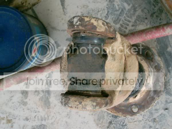

Axle shaft carnage

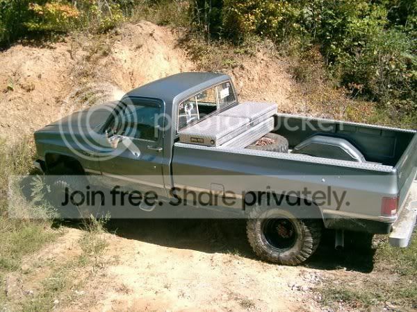

some flex

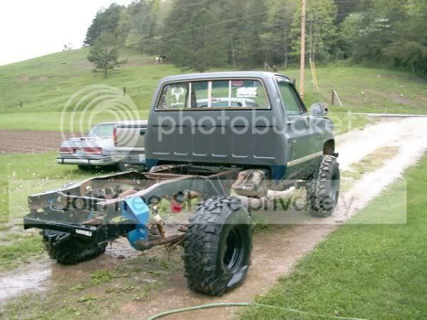

no bed

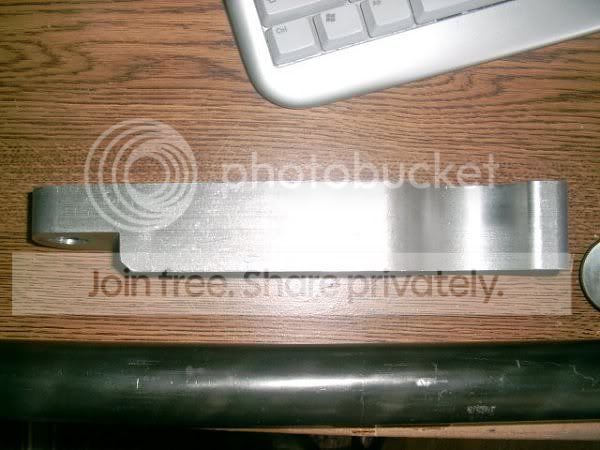

steering arm

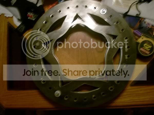

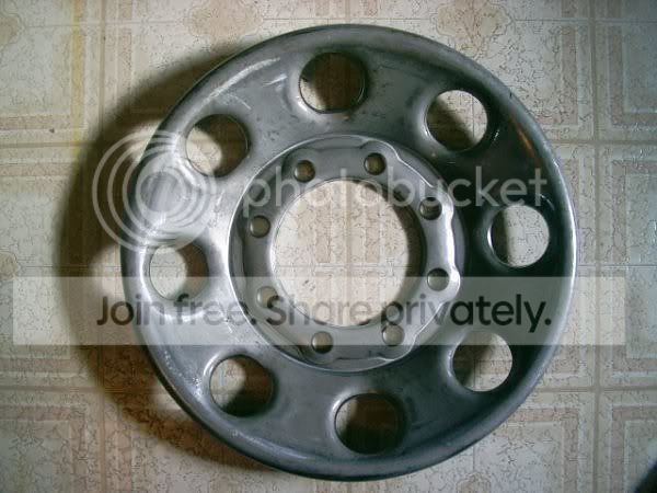

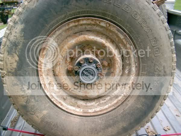

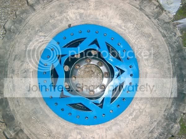

Beadlocks

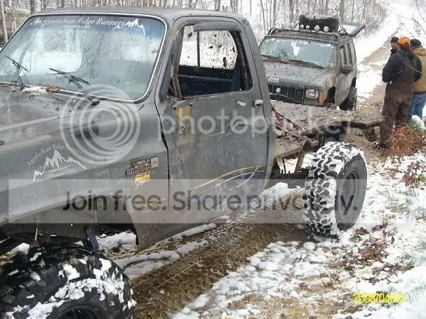

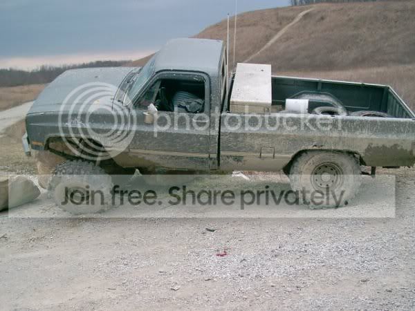

some recent trail damage

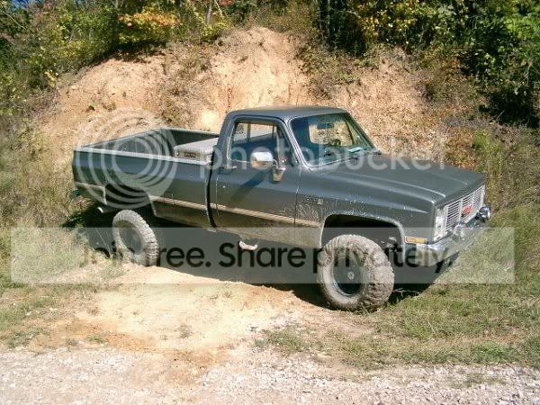

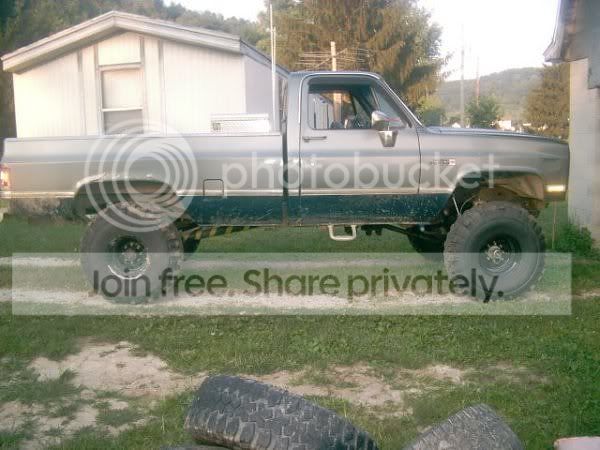

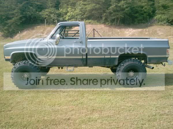

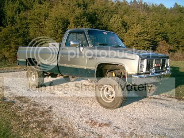

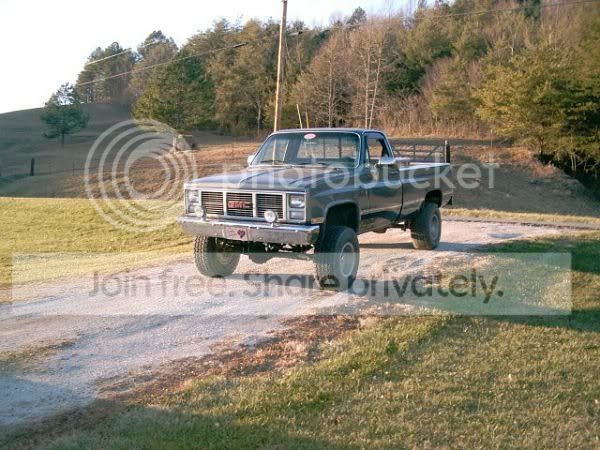

how she sits now with the new door

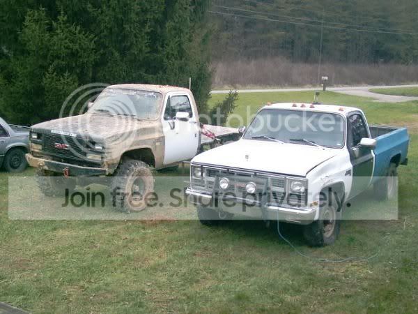

The 86 and the 82

Got my beadlocks ready to install.

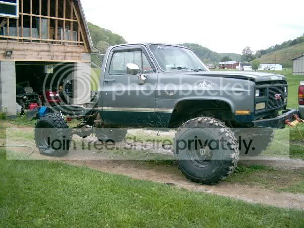

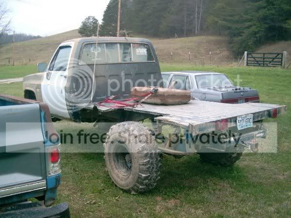

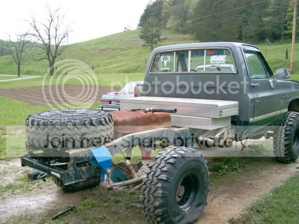

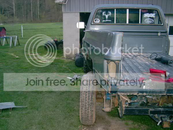

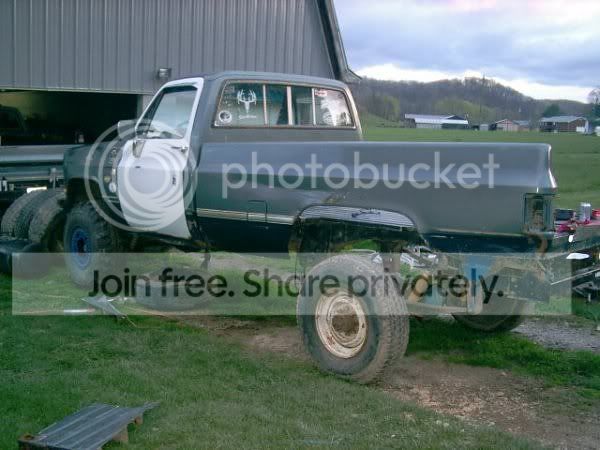

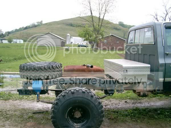

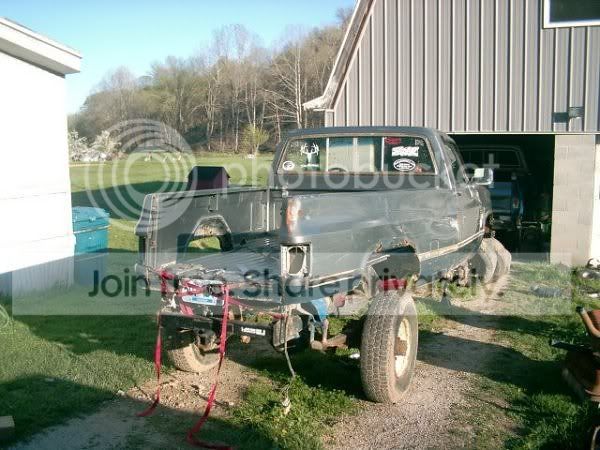

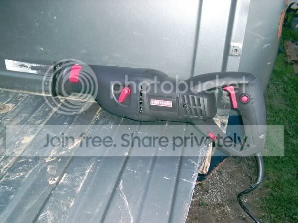

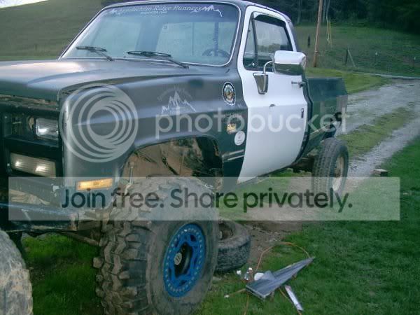

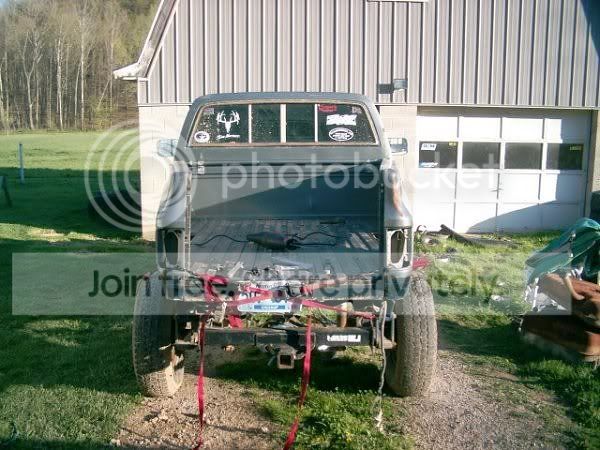

Got alittle bit of work done today after I picked up my new sawzall, got one side of the bed cut and the bed side sitting on it. Still got to do some more work on it but this is pretty close to what it will look like.
New sawzall, craftsman 10amp orbital 1 1/8th stroke
Getting closer got some more cutting to do, get everything welded up, and need to locate a 50in piece of 3x6 1/4in square tubing to make a rear bumper out of and some 1in thick piece of still for mounts and for d-rings.
So did you "borrow" that driver door from your white truck?

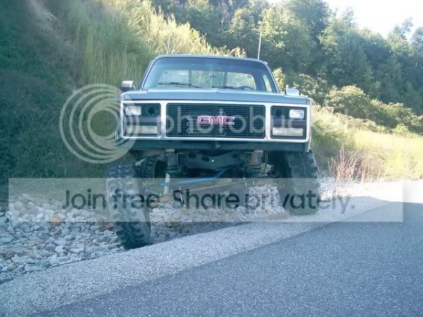

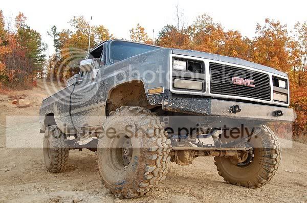

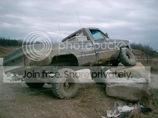

Letting the springs flex past neutral like that will kill them VERY quickly, been there done that.
I'd really recommend bump stops.
Extra flex might seem awesome and all when you take pictures but I promise that on the trail keeping everything together is more important.
Glad you decided to put the bed back on, cut up or not. Pickup trucks should have a pickup bed on them:wink1:
The white truck got a better door out of the deal, the one I took off and put on the trail rig was rusted and had dent in it so I was going to replace it anyways.
Been looking at trying to put some better bump stops on it but haven't come up with any good ideas on how to do it with out it looking like crap.

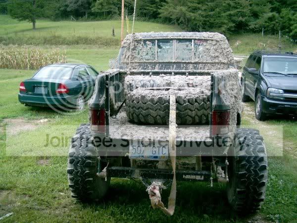

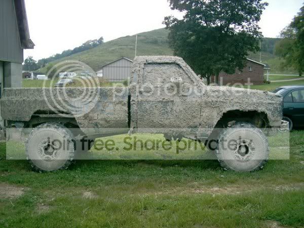

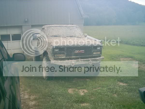

Here are some pics of it after the local fair's mud bog:

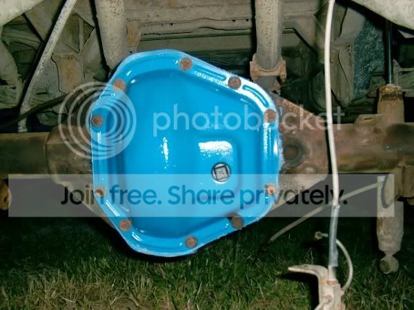

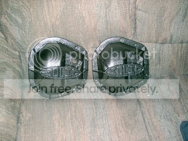

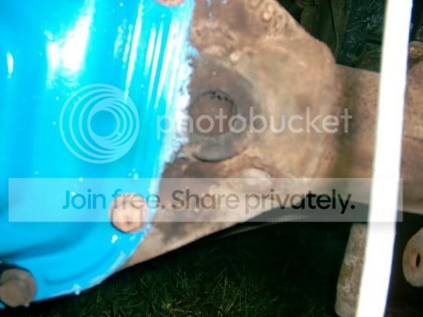

Picked up 2 Solid diff covers on the cheap for it

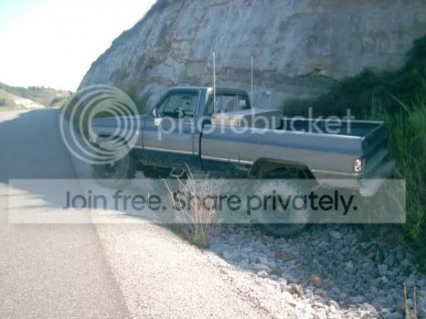

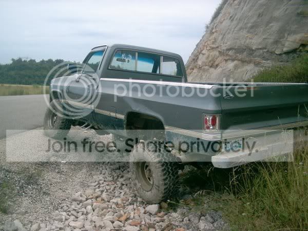

Few wheelin pics from different places:

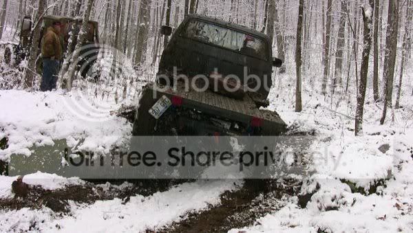

My truck being used as a RTI ramp by a buddies jeep at Harlan, KY.
Lower Rock Garden, Harlan, KY
Trying to make it up Grape Vine, Harlan, KY( didn't make it; open front, limited slip rear, and still carborated motor :doah: but not for long :whistle::deal:)
Local place

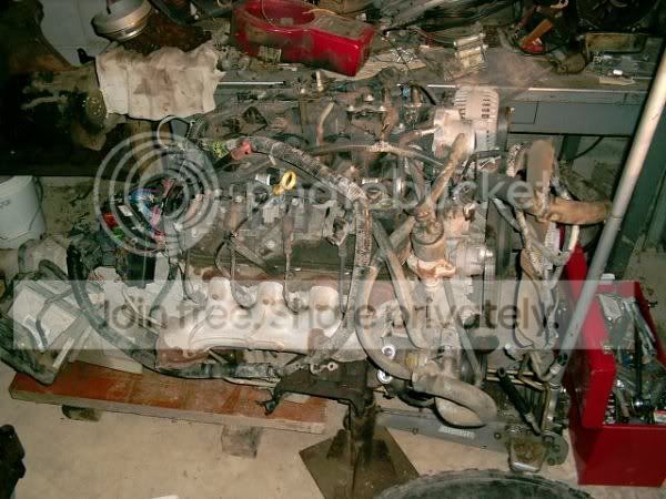

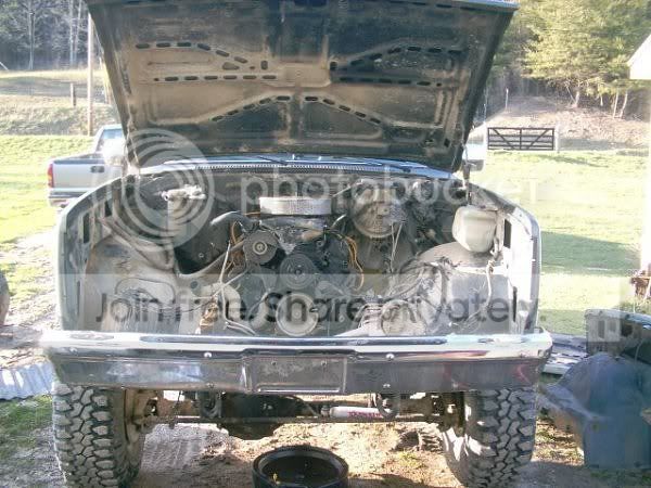

New to me motor: 4.8 out of 01 chevy with 130k miles :saweet:
Motor mount brackets for the 4.8 made by Dirty Dingo motorsports
