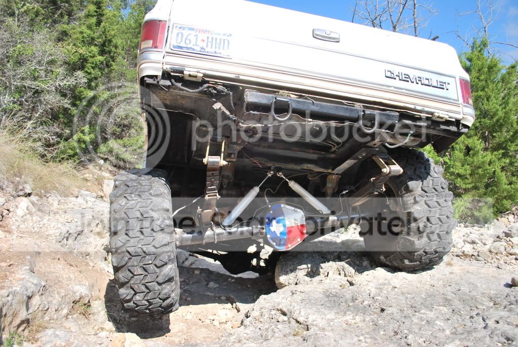

I have been on my 70 for several years now. I love it. It's no different than putting in a 14 bolt other than the width. I made my own perches and shock setup.
I run h1 beadlocks currently with srw 14 bolt hubs on it. 77" wms.
Later I will run stock drw hubs at 74" wms with 5" backspace wheels so I can run magic tires. I will just use some wheel spacers up front to match.
