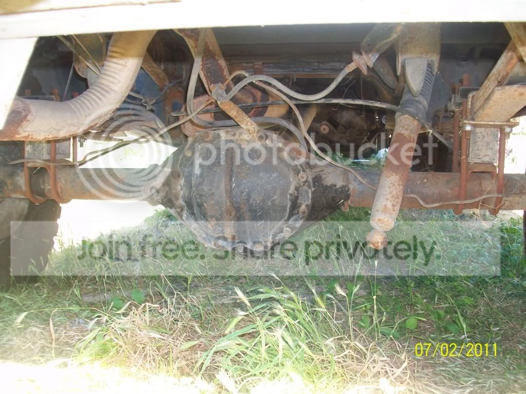

Shortly before parking it, I had replaced the 10b/10b set with a 10b/14bsf axles, but never got around to hooking up the shocks on the rear axle.

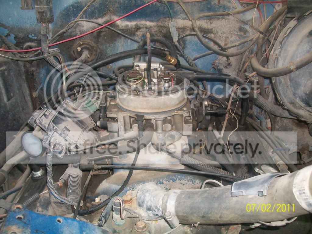

It wouldn't idle, but ran just fine at higher rpms, so I looked around the truck and found that the TBI unit was leaking like a sieve, flooding the engine.
A quick rebuild and the truck idles now. It still idles rough, and backfires a bit, but I need to remove the old gas before I know exactly what running condition it's in.

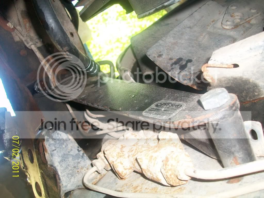

I'm guessing that the old pump and box were damaged when the steering box ripped off the frame earlier in this trucks life, as evidenced by the welded repair panels on the frame. To fix this problem, I installed an Off road design steering box brace. I haven't noticed any further damage since then.

10b/14bsf axles

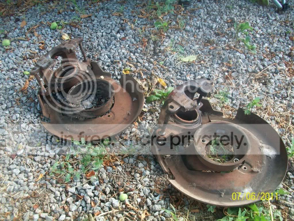

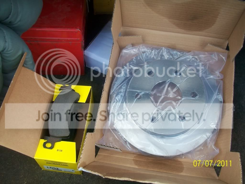

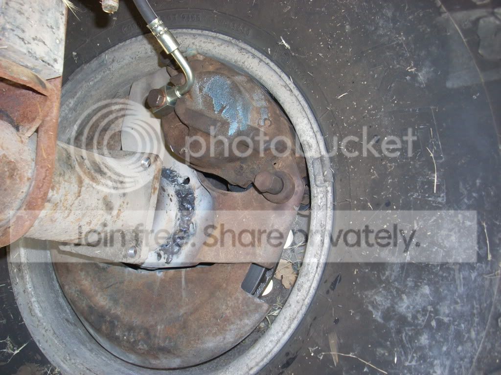

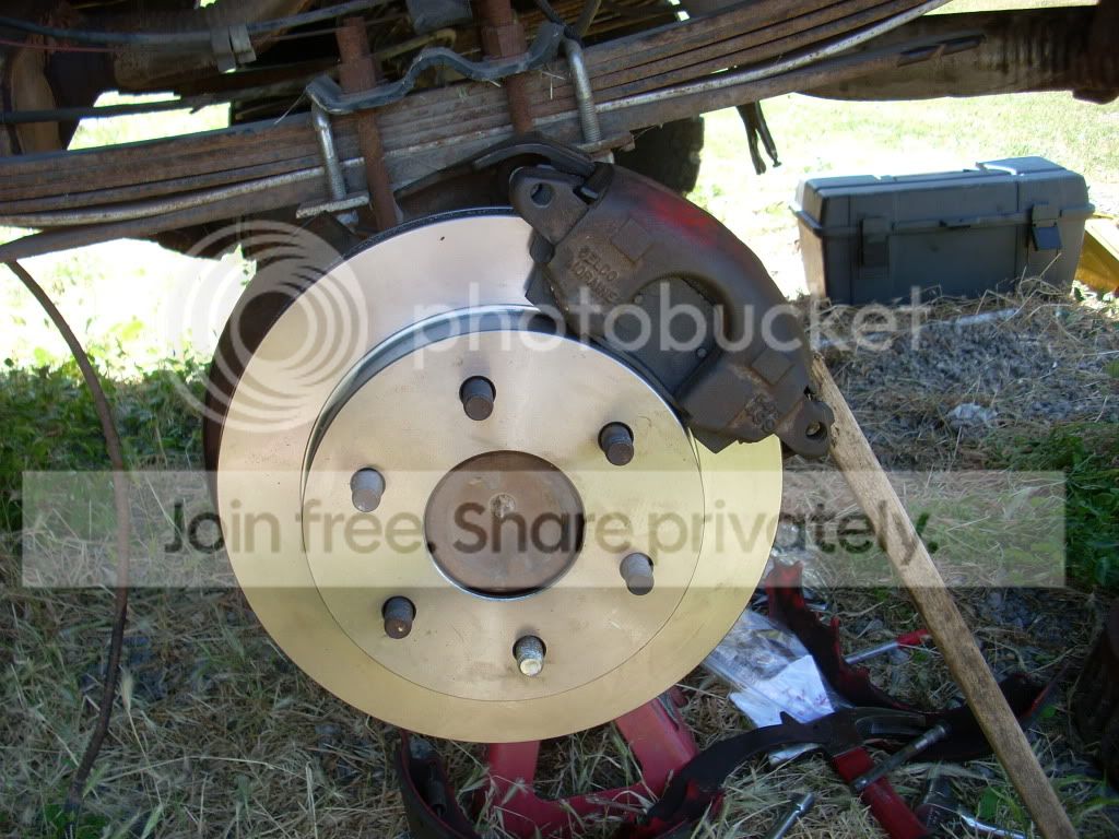

Edited once more to add: Disc brake conversion on 14b SF.

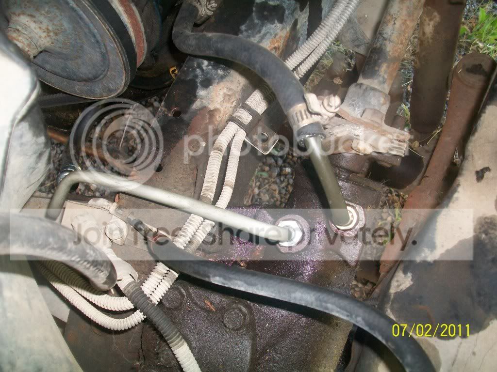

Barring any further needed work, I turned to fixing the horrible leak on the power steering setup.
I had bought a new power steering pressure hose before I parked it, and had it lying around. So I went to install it.
Wrong hose. After heading over to the parts store, I found out the pump and steering box are out of a 78' or so truck, and they used a flange fitting instead of o-rings on that one.
Bought the right pressure hose, installed it, only to realize that it was the return hose that was leaking.
So, I bought a flanged piece of steel tubing, and bent it up to fit. Problem solved. Filled up the resevoir and bled the system, and it no longer whines at me.
