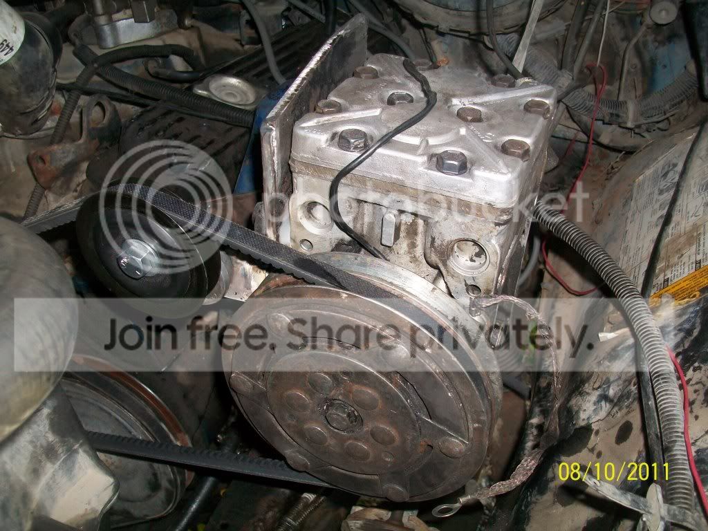

I noticed however, that my belt wasn't quite as tight as it should have been, and I couldn't tighten it any.
So, off to the parts store to exchange my pulley for a bigger one.
Old.

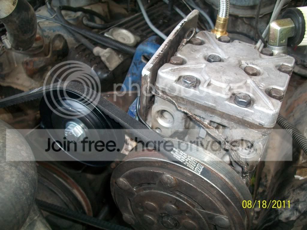

New.
Tightens up just right now.
Also replaced a vacuum hose that went to the vac res. It was leaking and causing my truck to stumble when coming to a stop.
I'm leaving it on for now, I'm watching the mount for structural integrity.
Once it proves structurally sound, then I will make it perty.
So far so good, but I'm not sure if there's any flex in it.
Still need to find a good place for that grounding strap too. Currently just sitting there.

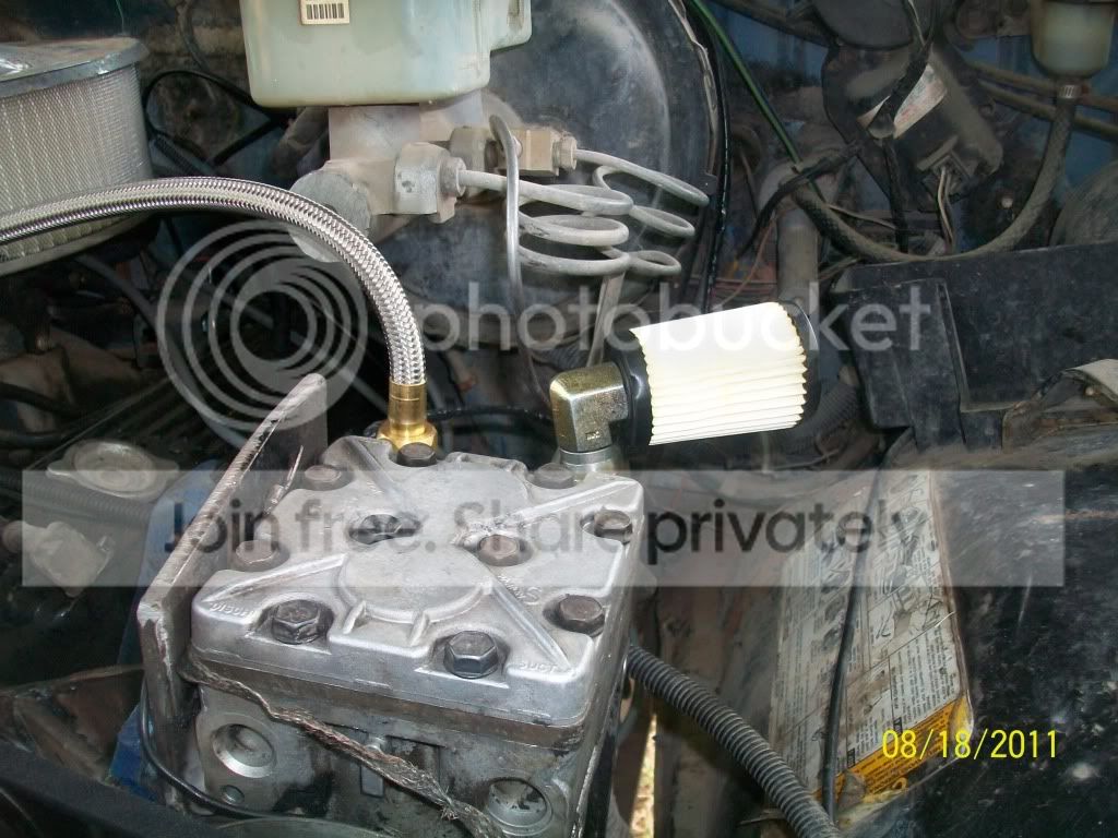

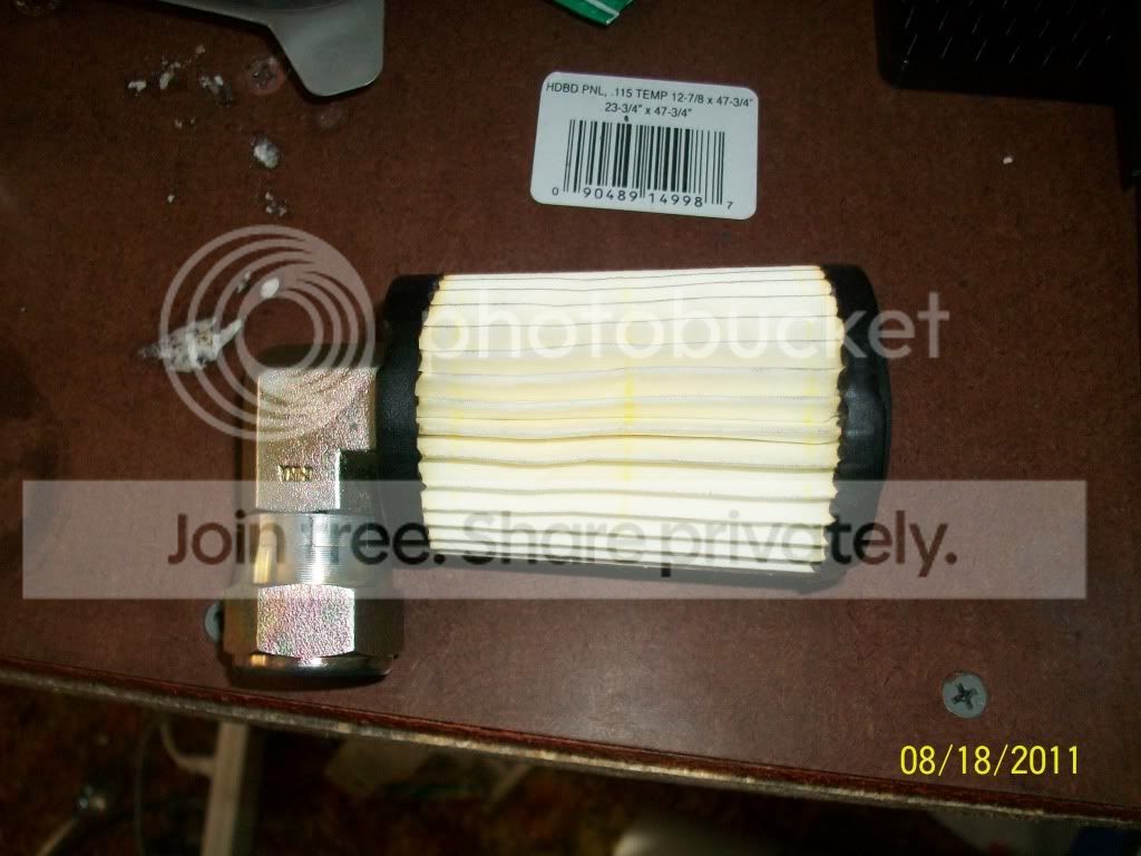

Edit: Thought I would add what I did for an air filter.
Couldn't find a valve cover breather filter that fit, so I went and looked at the small engine stuff.
I found a tecumseh canister filter, and threaded it on an elbow I had for the intake of the compressor.
Then I shoved a rubber cork into the opening on the other end. Voila! Air filter.
Cost about $4.
Mounted, below.
If you cut the mount above the bolts that the york is bolted to it should not effect the strength in any way. I would just connect the ground to one of the mounting bolts.
