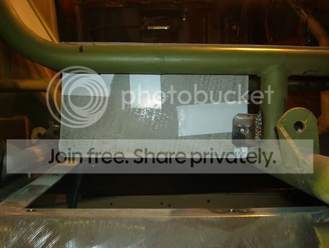

here's what the compartment size will be.... 6" deep x 6" wide x 12" long...
I could have made it 8"s deep..
but I'm pleased with the size, I thought it might have to be smaller....
I'll be working on the center panel for probably a month off and on.. stoked on this glass project... :saweet:

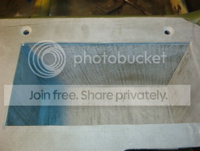

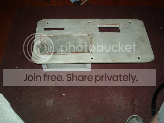

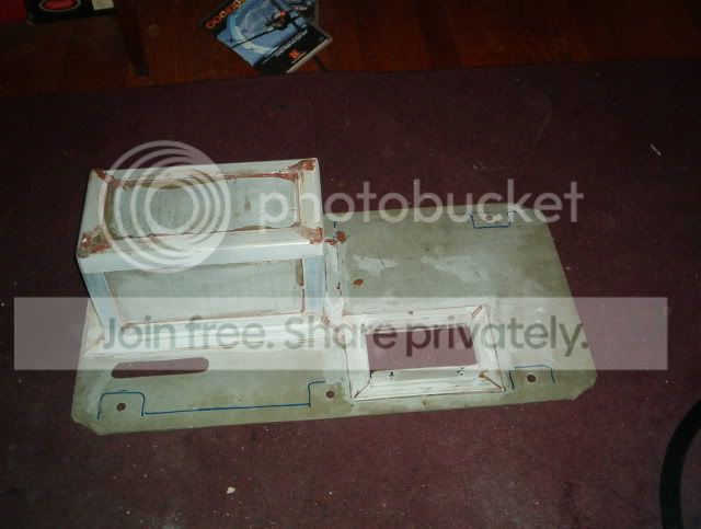

been getting some done here and there.......
the shifter mount is in, as is the compartment... ended up making a lip setup on the compartment, so the lid has a place to sit...

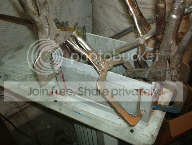

Clampapalooza 2010 :wink1:
my e-brake cable will be in mon, tues, so i should have the crazy e-brake setup done soon... this should be interesting.... :haha:
No such thing as too many clamps. :haha:
Looking great man! What are you using to bond up your fiberglass? It does not look like resin. At least I have never seen red resin. But then again, I am a relative noob...:D
Cheers,
Rufus
yup, I have a good amount and wouldn't mind some more...
and it's thickened epoxy... the thickening agent I had kicking around was purple... usually i run a blend of high density and low density thickening agents, kinda tannish...
thickened polyester resin works fine too... i just happen to have a good amount of epoxy kicking around leftover from jobs... it is 5x's stronger than the poly, or even vinyl-ester, but at 5 x's the cost usually...
usually i run a blend of high density and low density thickening agents.
So the thickening agent you mentioned are these also referred to as microbeads? I have seen this term slung around on the Velocity aircraft experimental aircraft site I frequent.
Cheers,
Rufus
there are many types of thickening agents... they vary in properties they give the epoxy... micro-beads, also known as micro-balloons is one.... colloidal silica, cabosil, low density, filleting blend, etc.. thats colloidal silica I used, used mostly for bonding...
you can mix different ones to get different properties.. to get a fairing compound you use low density.... but one of my tricks is add about 20% high density... makes it tougher, and sands much better...
