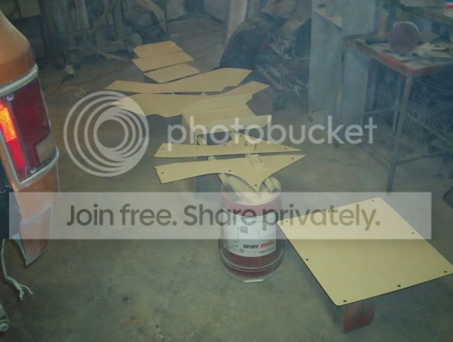

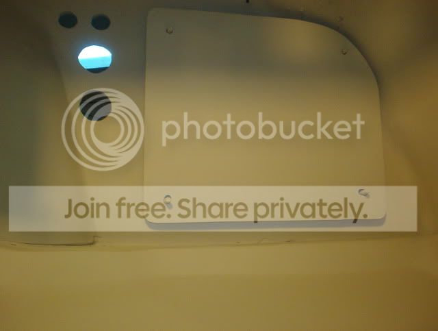

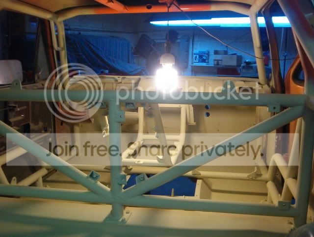

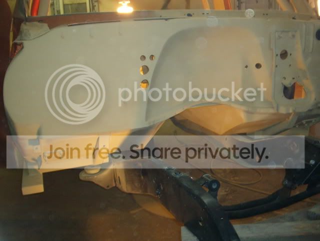

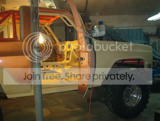

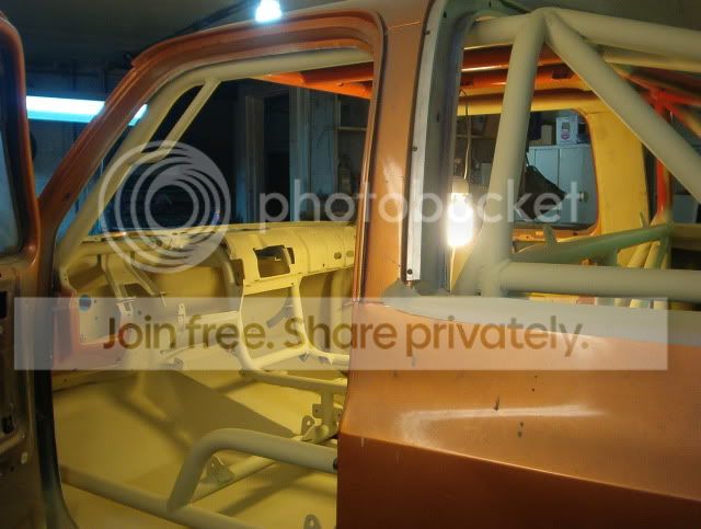

here's a few more...
things should start moving along good now..... over the next couple weeks I'll be shooting orange, copper and finally black.... yay me! :haha:
What a huge hurdle to get this far Paul, I happy for ya mang.

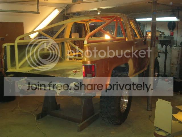

yup, plenty ahead, still got a bunch of seamsealing and sanding to do.... but that was a BIG deal.. thanks... :D
it'll be soooo much easier to make progress with the cage and interior painted.... once i get all the fiberglass panels thru the satin black, I'll be cranking! :woot:

also gotta pick up another gallon of primer for the hood/airbox, rad support, spot-in's, etc..... went thru a gal yesterday... broke out the 3 gallon pressure pot... :whistle: hose-fed gun is the ONLY way to shoot an intricate section of angles like that for coverage...
thankfully I'm basing the cage in rattlecan... and i'll use a gravity feed for the copper... but i'll definitely be breaking the pot out for the satin black! :woot:
still need to mount my back 4 cage flange backing plates... since i have some, I'm thinking of shooting some Imron clear over the orange rattlecan cage stuff with a touchup gun...

Coming together VERY nicely. :waytogo: That looks like it was a LOT of work getting it to primer with all the little finishing touches there are to do.

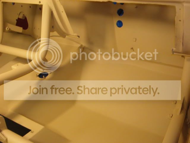

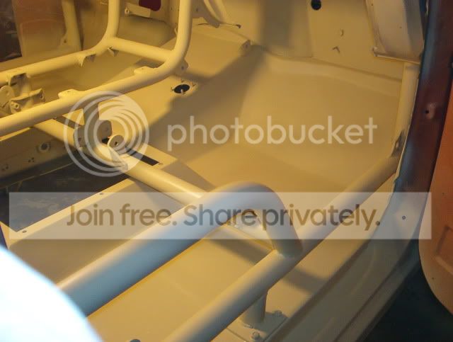

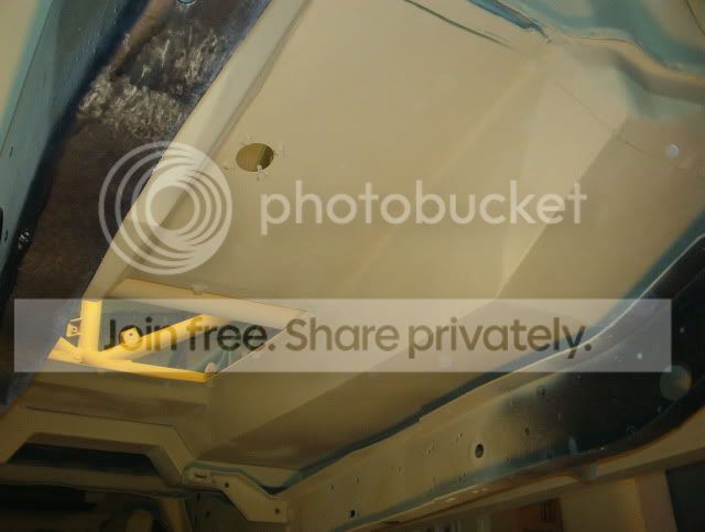

eesh, more sanding and shaping, rolocing, grinding then i care to remember... the last welding done where the studs for my twinstick cable boot hole... hard to work on MANY of the cab/cage/dash areas...... friggin cab is a gad dum jungle gym... :eek1: :haha:
then i decided to radius all the angles of the floor with Duraglass to help keep it smooth for rinsing out... it came out sick, but was a bunch of work.. still need to seamseal the bottom of the firewall and cargo step...
gotta figure out if I'm just gonna run herc over paint on the lower "pan" section, or get some Line-X'y, Lizard skinnish type product in there... should work out sweet meeting up with the smooth composite panels... texturally contrasting! :whistle: :doah::rolleyes::haha:

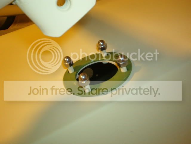

oh, and here's how the twin cable grommet goes...
2 layers of conveyor belt go under that holddown ring and the cables go thru the belts...
and here's an idea of how the Megasquirt board will be... obviouly it'll be nutted and washered on the studs...
what does my fellow "might as well"er think of the cable boot? is it just "over the top", or "couz needs a straightjacket" over the top?
I'm running 2 layers of 1/4" conveyor belt.. gasketpunched holes for the cables, then each layer will be slotted in opposite directions to the outer edge...
standard grommets just seemed not as "bulletproof"........ :whistle:
It sounds like a better solution if you ever needed to run a new cable or repair anything with crimped or soldered ends on it. A nice Earls pass-through bulkhead fitting works good for cables or hoses, but with a bulky end fitting you'd never get it through the hole without cutting the ends off again. You're idea seems to support future servicing much better.
