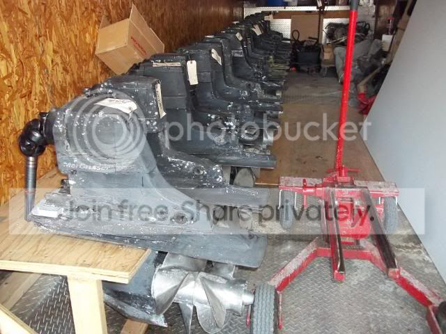

a SB I put in this morn....

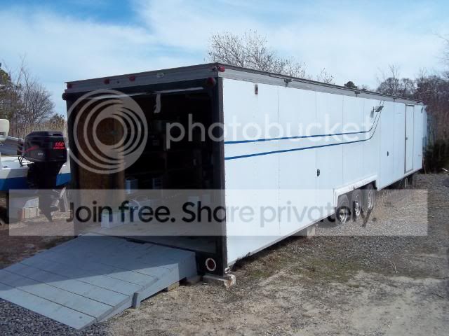

one of our 3 trailers.....
containing 1/3 of the bane of my backs existence..... :mad:

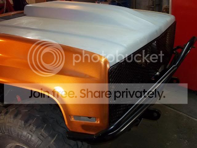

so did I convert any grill nay-sayer's over to digging the grill? :ears:
Not yet :D
Shoot I can't like everything on your truck, I will withhold final judgment until all the lights are behind it.
If that's the only thing I don't like on your truck you are doing pretty good. I am extraordinarily talented at picking a truck apart :whistle:
I'll keep trying! :haha: :bow:
the OR lights out on the bumper will be a ways off...
I was kinda hoping this one would win ya over...
i can picture it with the copper hood, OR lights out front.... stoked..... :haha:
I will admit when I picture it all painted up (hood and stuff) with the lights behind it and all the blinkers and such its not bad.
Lemme just say this, it doesn't look bad. :D:D:D

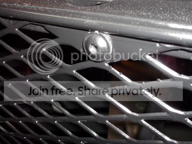

How did you mount the grill to the truck? I don't see any mounting points. I like the NATO plug as well (it's what I was going to do). Where did you find the parts? I'm having a hell of a time finding them. Also, why did you order two air filters? Moroso and a K&N?
it's all good.... everybody likes different stuff.... some people detest cowl hoods... I'm digging how it's coming together and that's the objective.... helps the ole motivation factor.... :doah: :haha:

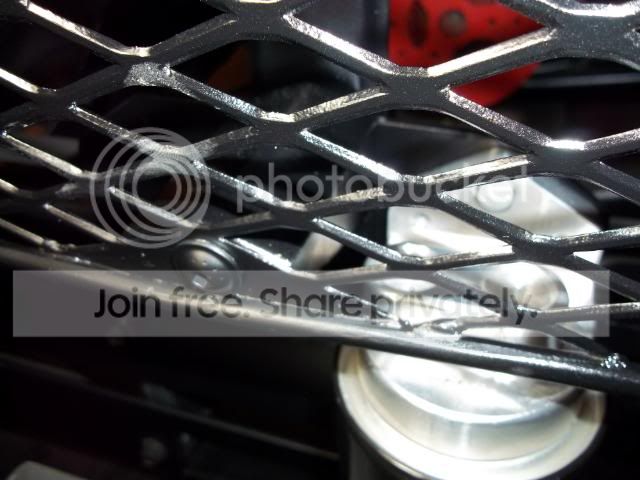

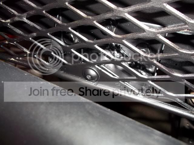

ok, mounting....
there are now 7 of these incorporated into the grill, 4 across the top.. 3 on the bottom... they are all 3/8 course...

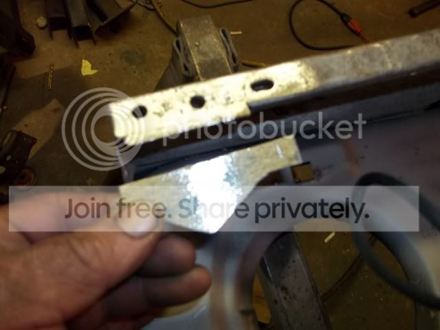

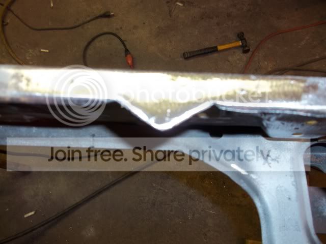

the 4 across the top bolt into these tabs i sectioned in the rad support... drilled hole, welded nut on back...

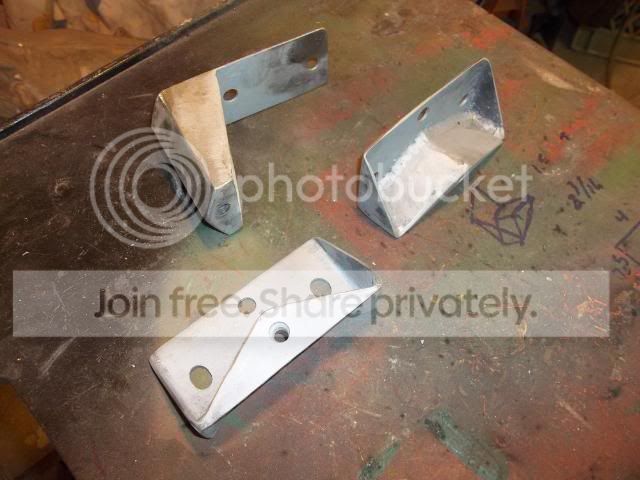

here you can see one of the lower side brackets...
and the center one.....

I really found if it is mounted externally, ya HAVE to have a frame for it... the expanded is just STUPID sharp... now i saw crash did his on a pre 80 clip and managed to mount it to the backside of the grill.. eliminating the sharp edge scenario.. maybe he'll chime in...

oh, and for the record... looks aside.. the grill is rediculously strong... I'll just say, the mounting came out seriously beefy....

Looks sick man, i love the expanded grill, its way cooler than a billet or something aftermarket that ive ever seen. :thumb:
I'll admit that I was not on the Ryoken grill train from the beginning, but now it is starting to grow on me......slowly :eek1: :D
Now that it's in black, it goes really well with the uber bumper. I just don't think that you could have pulled it off with a stock bumper. It's all the extra fab that kinda makes it fit.
Once again Paul, Good work..:pimp:
my thought too, the bumper really helps it...... i had no idea how it was gonna look.. but it is growing on me more and more.. hopefully when all said and done, it'll impress me... :haha: thanks :)
