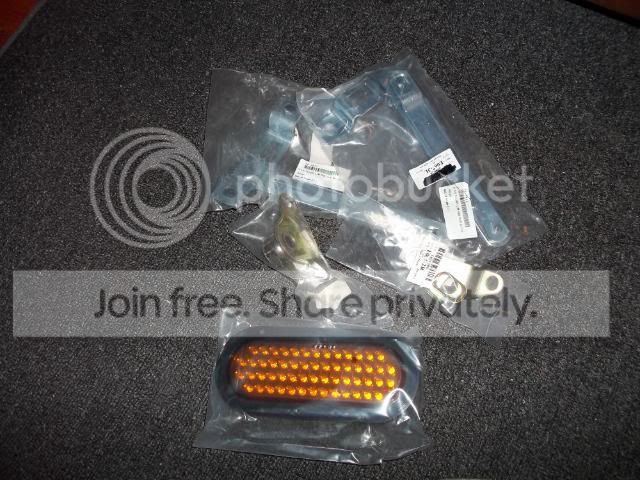

there's a link in that post below the pic to the place I saw the Nato plug at....
