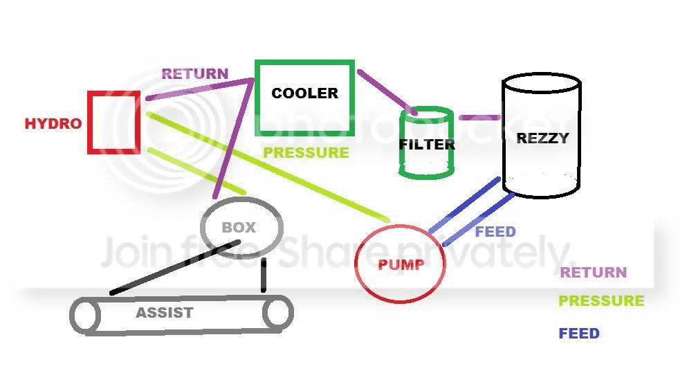

Are those just regular motor oil filters? What brand are they? How the hell did you relocate the Trans and PS filter? I thought the Trans filters were pretty much built into the pan. I'm curious how you did the PS as well.
yup, standard chevy spin on filters.. 3/4" /16 center... these are napa gold 1515, but that crosses to a Wix 51515...
the trans is in addition to the pan filter... but regular changing of the spin-on keeps the in-pan one stupid clean....
ps gets a little complicated due to the extensive system I'm gonna run... aftermarket pump feeding hydroboost brakes, the box and assist, cooler and filter, all being fed by a remote ressy... I've got a diagram i drew up here on the comp somewhere.. if I dig it up I'll post it...

Did you say you made a chart of how you will be running the lines? I think I still like the stainless lines better than the black ones, but if its gonna be a hectic amount of hoses running all over run the black, but I know it wont, I imagine it will be pretty darn organized if you are doing it, and if they are ran nice and "elegant" lol, I think the stainless will be nice!!
hunted it down... excuse the goofyness of the locations, etc... it really wasn't drawn for the public, but me.... when built, the rezzy is all the way at the top, right under the hood with a short fat direct feed down to the pump....
I'm a fan of always running filters after coolers on any system.. I feel it helps keep the fluid a bit cooler...
