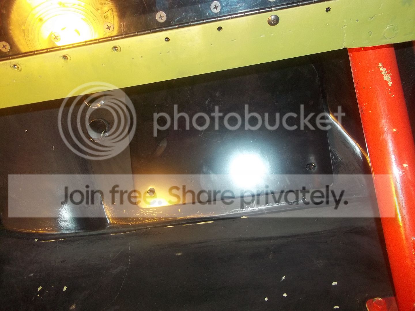

so here's what it's looking like down there with the ECM panel, etc...
originally, I was gonna build a fiberglass channel across the bottom of the ecm mount to stick the kick panel in... more on that later..
but now if I can, I'm gonna see about just wedging it right in the sheetmetal 90 at the bottom of the firewall below it..
ok, great... except...

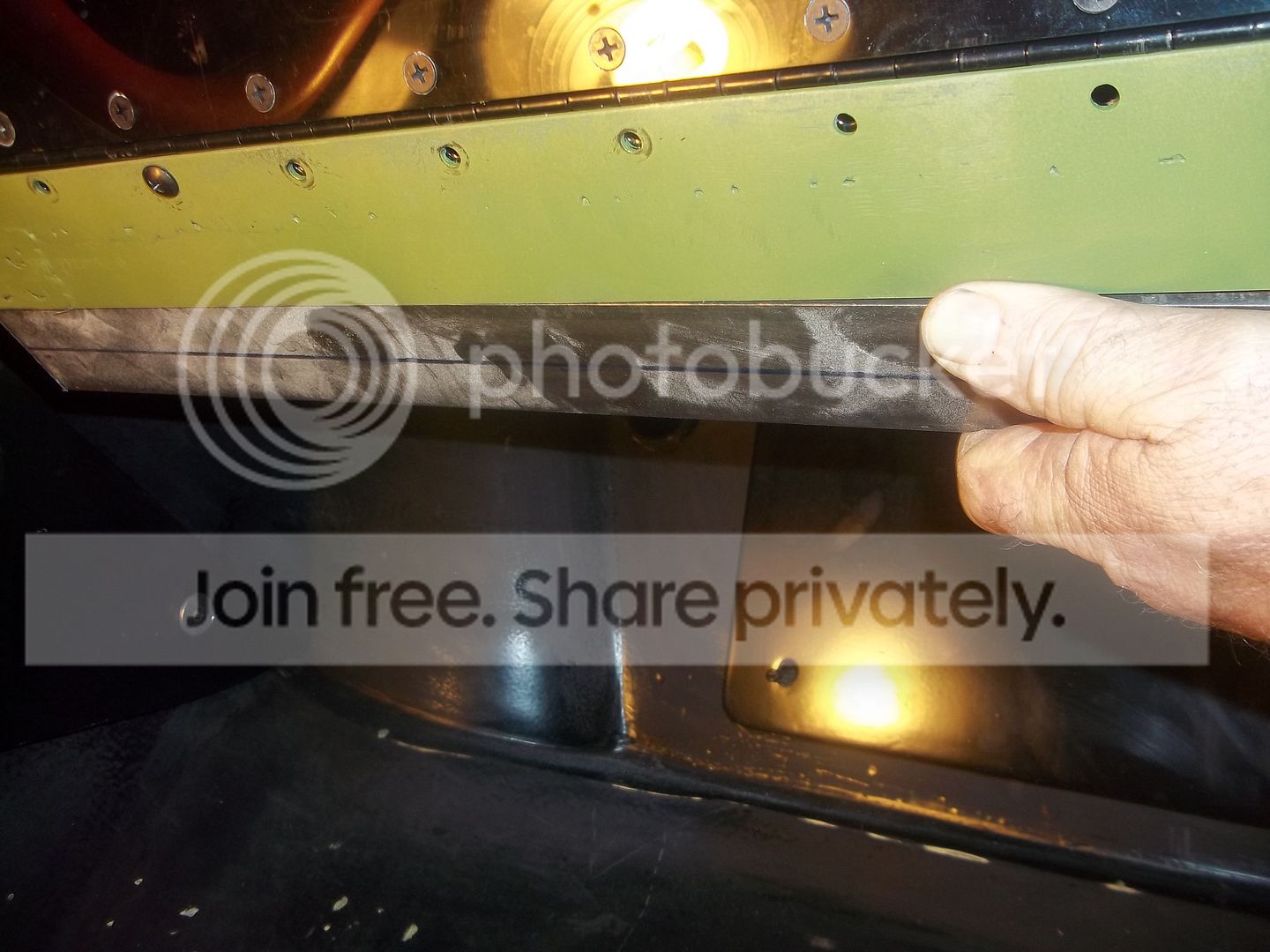

this is just a smaller hunk in there to see how it locks in.. nicely.... :waytogo:
but... the angle that firewall rides at is just a bit different from the lower glove frame... :doah:
so the flat panel will get all caddywombus as it gets up to the latching point up at the glove frame...
in addition... I don't even have a piece of composite big enough to go from the firewall to that bar... it's 13"s.. widest piece I have is 11...
and also, the angle that green zinced lower frame is at, isn't correct for the lower panel.. in other words, you couldn't overhang the hatch and have it st on a flush lip.. it would have to be perfect fit to the lip..

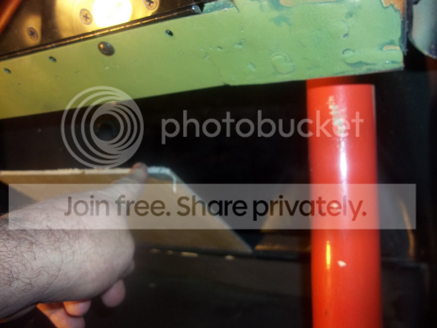

so.. that all leads to... possible more metal work.... :doah:
putting in another 2 x 1/4" strip at a slight angle to the green one...
this would solve the angle, "hatch having a flush lip to sit on" aspect... it does close up the opening a bit, but it's still gonna be damn manageable even once stuffed with electrical components.. tho I was kinda hoping the metalwork was done over here..
but what it doesn't solve is that slight angle difference between the firewall notch and the dash.. back to the ECM panel.... if I run the fiberglass channel, I can mount it at a slight angle for the panel to sit in...
also it moves the panel up the firewall a bit.. shortening it enough to where the 11" wide piece I have, should work... not that I couldn't "make" a wider piece, I just would rather not...
so more metalwork and some glassing, yay...

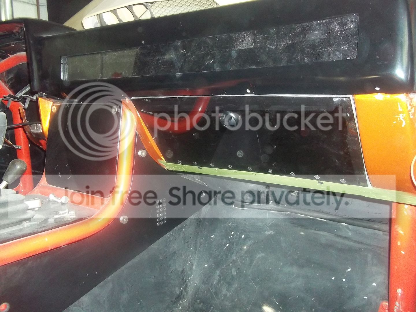

What does the original glove box door look like on one of these?
Any chance of using that for a frame or pattern to mold the plexi? Or have it scanned and make an all plastic or glass one :dunno:
let me go over a few things about the actual door and some train of thought thru this....
the factory door could never fit now cuz the bottom hinge area is all different now to accomadate the flat plexi....
which brings up curves.. yes, a factory glove has an ever so slight curve to the door... you can see that shaping in the sheetmetal lines next to the plexi...
I like it flat.. it was the original idea behind this... not to have a translucent glovebox door, but to be a flat panel.. it needs to be 3/8 tho..
that said, trust me, I've contemplated whether, and how I could do the slight bow plexi approach too..
couple ways if I wanted to do it..
bending the plexi is relatively easy (we used to do it for boat windscreen s all the time), heatlamp it, laying it on an old glovebox..
but than ya have the gap to contend with at the middle sides.. you could cheat/hack and shape some weatherstrip... you could glue a plexi moon piece at either end of the door, reshape the flange, yada.....
but, I really don't think it'd be worth it.... I think curving the door will take away from the look, just have the thickness right on a flat one..
also.. I've been talking about the shaping of the sides... not only a nice little rounding to each corner, but the bevel of the sides too... that's why the thicker 3/8 will help too.. if you've ever looked at that glove opening, the sides go in at an angle next to the door...
