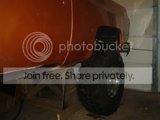

I did go down last night and finalize the rock slider plan. Also started to figure out where and how I'm going to section the sheetmetal at the wells.. I'll wait to finalize/start that when I see how much lower she sits and where the axles end up at...

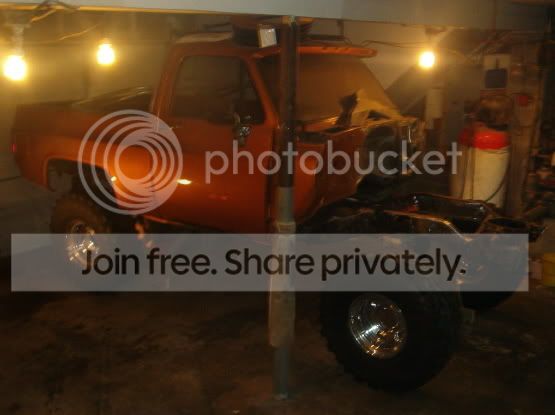

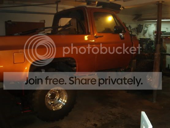

Got my other bay back for a week or 2, nice to have that extra room in the shop again... For as much as I'm not into chrome, the rims have actually grown on me a bit... :haha: They'll be going black tho, or getting changed out... Couple last poser shots here.....
yup, all paint work is done in my 2 car garage... I'd guess I've painted about 50 in there...
sheet plastic, center wall, top and bottom wrapped in lumber to secure/anchor it, to split the 2 bays.... the "paint booth" is the one the truck is not in... easier to clean, rinse.. I'll usually blow the whole shop out a few days before.. I cook the shop all night.... shut the heat off in the morn.. spritz the walls and floor with the water hose... turn the fan on, wait a 1/2 hr, then squirt..
I have 2 windows on the wall in the booth, intake and exhaust. they both get the furnace filter treatment, I do the exhaust one so it catches the majority of the overspray...
the truck'll eventually get a final wetsand and overcoat.. But for now, it'll roll out of the shop spotprimed in the well areas from the sectioning project...
Gotta love hacking up brand new sheetmetal! :crazy::eek1: :haha:

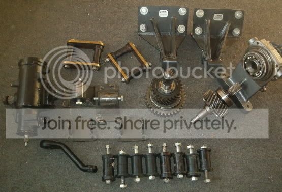

The parts pile grows...
Props to AlphaMale for the hookup on most of that....
still need to pick up back 56's, Kerts UDSR shackles, perches and plates.. FUSH Kit.. should have the 4" EZ rides in a couple days...
then it's on to the x-over/hi-steer...
Looks like an input shaft for a NP205?
Anyways nice little mess of parts there, can't wait to see more progress. :laugh:
yup, 27 spline input, HD coupler and adapter and a 32 front output...
