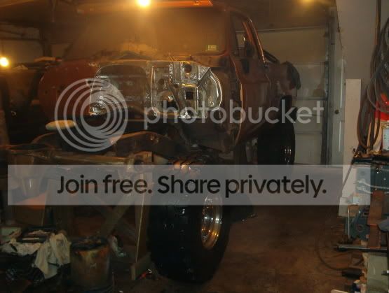

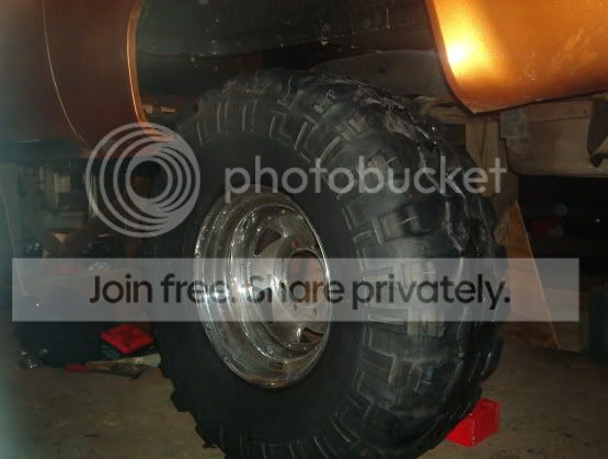

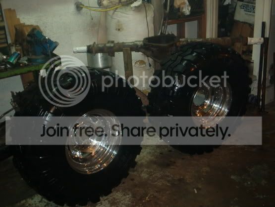

First, I will apologize for my inadaquacy(?) of my photo and computer usage. I know it's quite feeble. Second, I have no pics from the side with the 38" radials, but the 38x14.5 are close on the 10" wide rims. Hope this helps. Oh, there was no body lift on the truck with the original paint. There is a 2" body lift on the front of the cab, but the rear has a 4" angle and 2" angle cross member to the rear and mid mounts with 1/8 plate as a floor. When "completed". the truck weighed just shy of 7000lbs. Ooops, guess that's besides the point.
