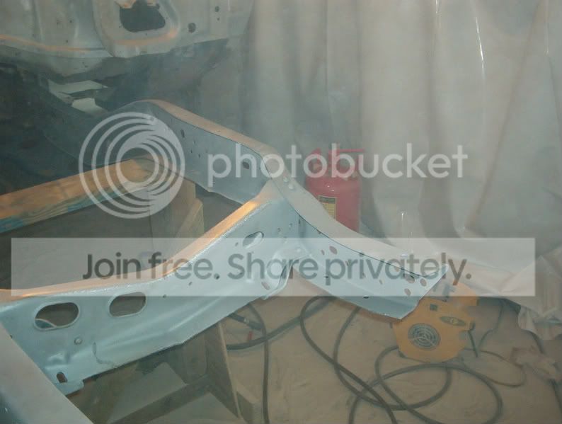

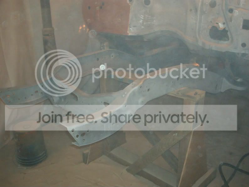

finally got some time to work on the truck...
load #1 out of the glassbead cabinet....
gonna finish blasting the frame today, zinc and epoxy those parts and a good portion of the frame...

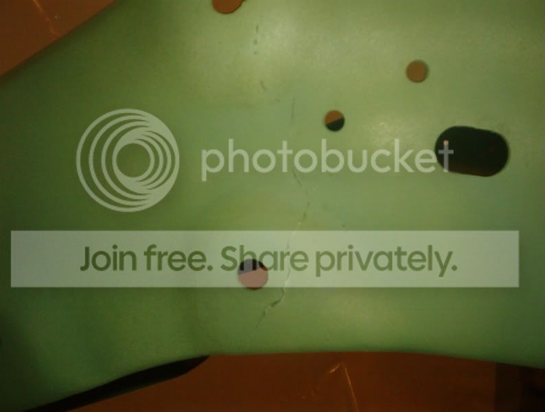

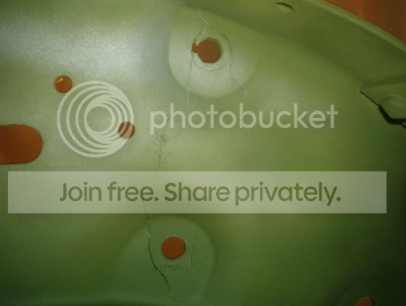

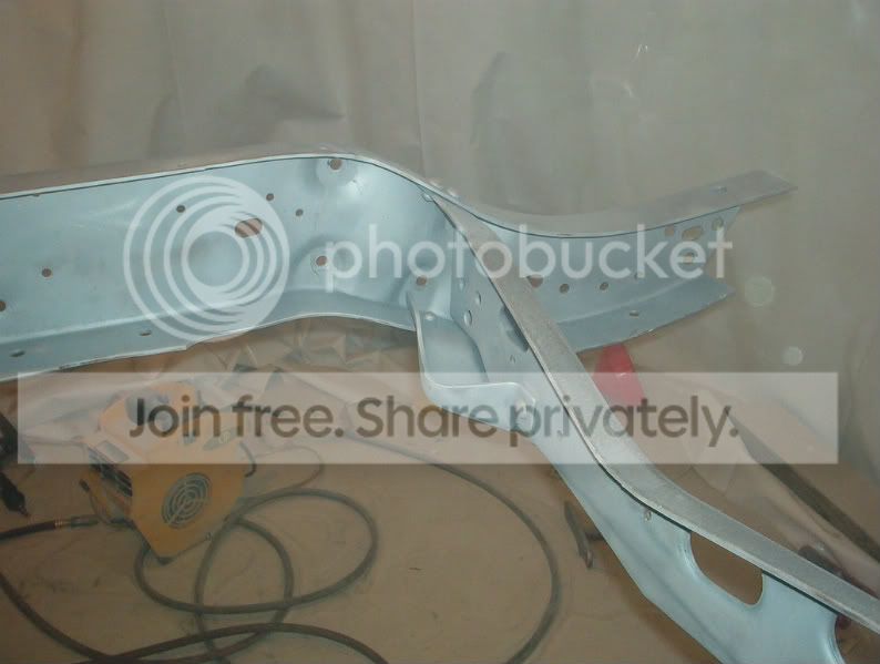

more clean, raw steel....
note the cracks at the box area....
1/2 my garage looks like Pismo...... :woot::screwy::saweet:
It's been different shades of hazy down there all day... :haha:

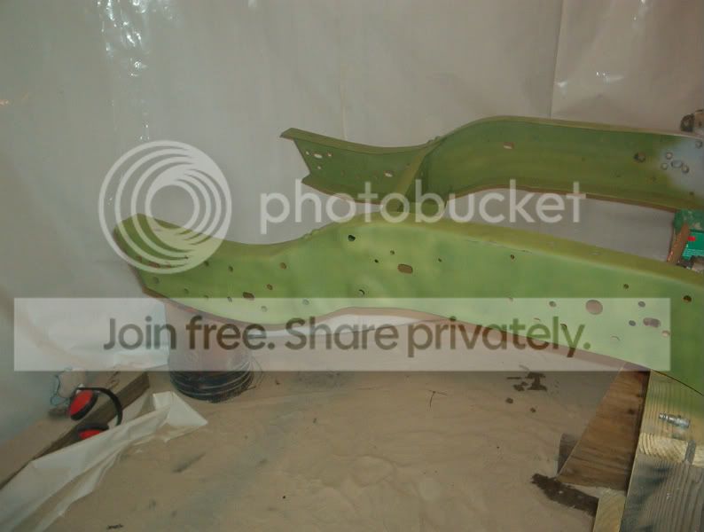

thought I had a gallon kit of zinc wash, but I'm out.... so a couple 1/2 rattle cans of zinc till I bring some home tomorrow...

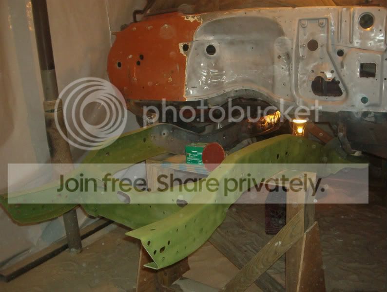

thats about 1/2 the load.... :doah: nice having free run of a blast cabinet... musta spent 4 hrs saturday morn doing them...
everything on the truck is getting the full treatment, zinc, epoxy, black Imron.... even the secondary color I'm using for the drivetrain, crossover, razors, etc is going to be Imron, chevy orange... not a ton, just a few items... all the black will have flattening agent in it for a satin look...
other than not having zinc wash, I have a gallon kit of epoxy primer, gal of black Imron and a qrt of the orange.. plus I still have a qrt of the copper, 2 qrts of clear and hardener... So I have most of the materials...
