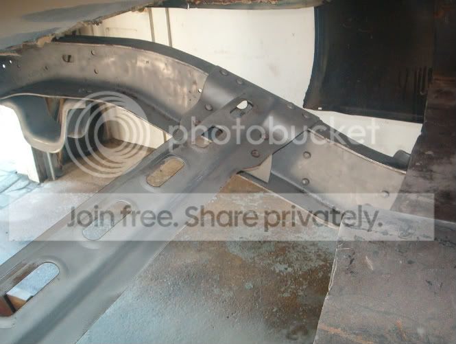

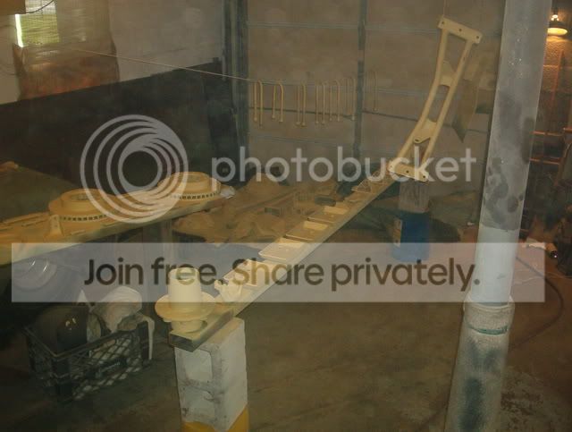

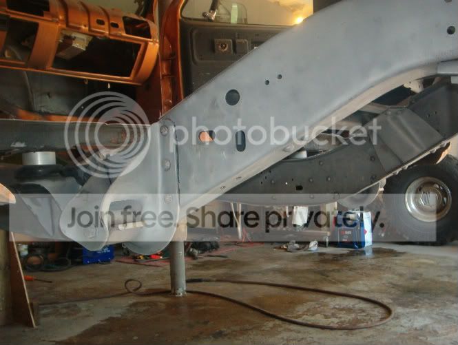

Can you explain too me what stage all these parts are in? is this pre paint? i love how clean everything looks. im assumng the only way to achive this is through the use of special equipment or can it be done by any one with a local parts store? and whats imron?
btw awesome thread ive been workin my way through it sorry about the hijack
The parts you see there have been sandblasted. At the time of the picture, and Ryoken will correct me if I'm wrong, they had just been blasted, but not coated with zinc or primer yet.
The only real way to acheive it is to use a blasting cabinet, or to use a few pieces of sandpaper and some elbow grease.

and Howlong..... yup, bare steel, just out of the glassbead cabinet.. I have one at work, but most any local machine shop will have one... They usually do it for a price... like an intake manifold might cost ya $10 or something..

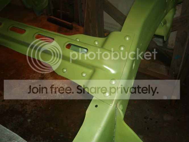

Imron is an automotive/fleet urethane paint.. very tough... self-etching zinc chromate primer on the bare steel, then epoxy primer, than Imron... pretty bulletproof coating system...

So what brand is imron or is that the brand and is it a spray paint and where do you purchase it?
Imron is a brand name from Dupont. It is not available, IIRC, as a spray type paint in an aerosol can. It must be sprayed with a gun. I believe you would probably need to use a paint supplier, most likely an auto paint supplier would be able to provide Imron.
I believe that Ryoken uses a single stage Imron, but I am sure he will correct me if I am wrong.
thanks for the speedy answer, im gettin ready to paint up some stuff on my truck and was curious about the imron. sounds like pretty serious stuff, for now i think ill stick too the krylon hammered!
correct... :D the main copper of the truck is basecoat/clearcoat... chromabase base, with Imron clear on top... all my black, etc is a single stage Imron.......
howlong, it is a catalyzed paint.. meaning you add a hardener to it.. think bodyshop... spray guns, compressor, etc... rattle cans are an uncatalyzed paint, in almost all circumstances, except the rare rattlecan epoxy primer...
A catalyzed coating will always be far superior to a rattlecan... Now whether everyone needs/wants to go that far is debatable.. I'm setup for it and have been restoing vehicles for 25 yrs, I'd almost feel guilty using rattlecan.. Especially considering I'm trying to go with the "do it right, do it once" train of thought... For the average job, sure, I use rattlecans for parts too...

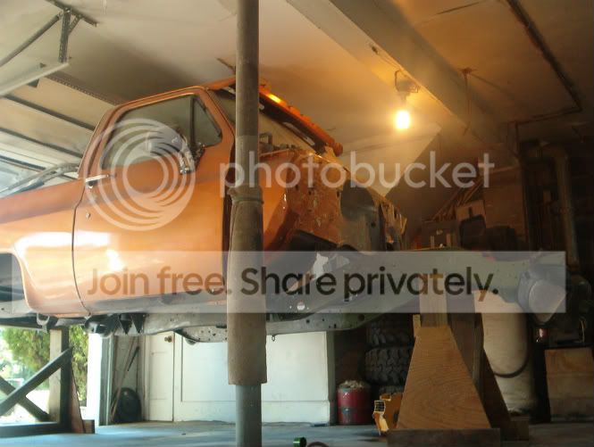

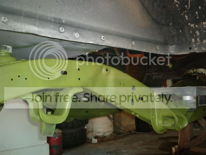

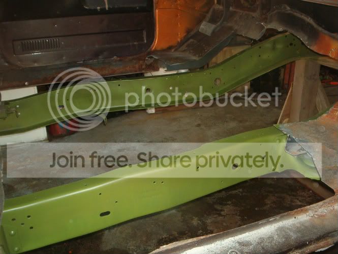

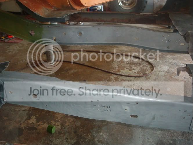

some of the recent progress.... the rest of the frame in all it's naked rawness... :haha:
in zinc......

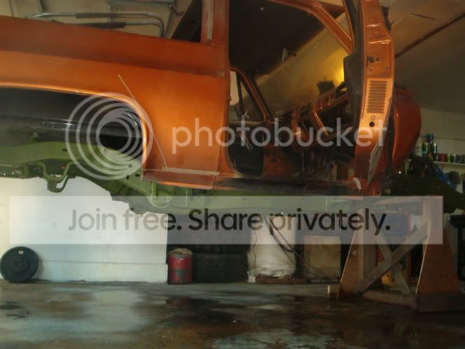

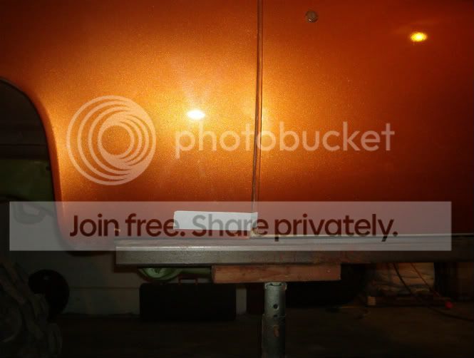

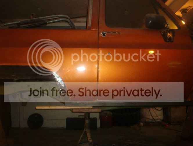

beginning the sliders... tape cutline on the rocker.. I left a 1" tab lower on the qrter, so it can be bent under for a flange to the slider...
the final length of the slider...
the line for the sectioning of the wheelwell..
one of the pieces removed..
welded up, moved the opening about 4" forward... by sectioning it, I'm able to keep the 1/2" raised lip bodyline around the qrter...
the slider will have a matching angle cut...
it also gives me the inner lip flange... still need to do a little patchwork at the bottom before I final mount the sliders...

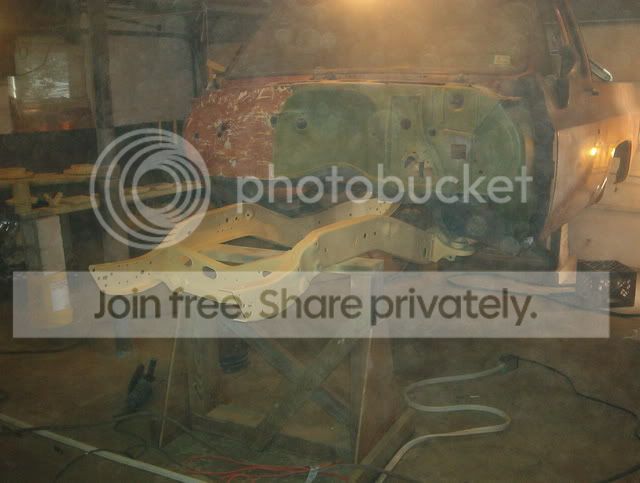

I'll finish that up once I fit the custom cab supports in... you can see some rough sketching of future fitment...
the x-member will be the same 2 x 4 as the sliders, with a 1 1/2" x 3" spacer pad at the end to mount the slider to..
kinda hard to explain, more pics coming... :wink1:
