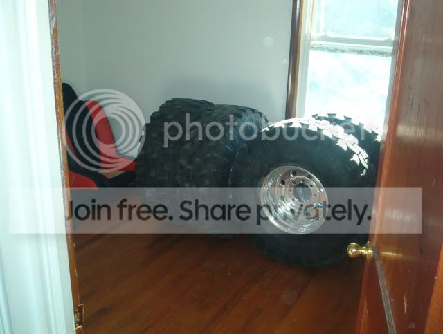

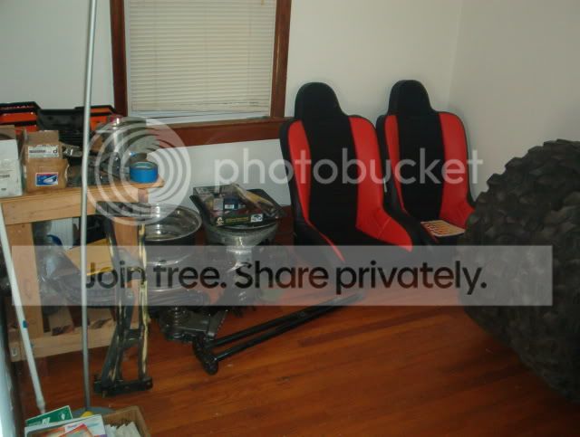

but I just don't have the room for it
ya mean everyones spare bedroom doesn't look like this? :confused::crazy::doah::confused::p::haha:
you should see my attic.... :eek1::doah:
No wonder the gf wont marry me....... :doah::wink1::haha:
