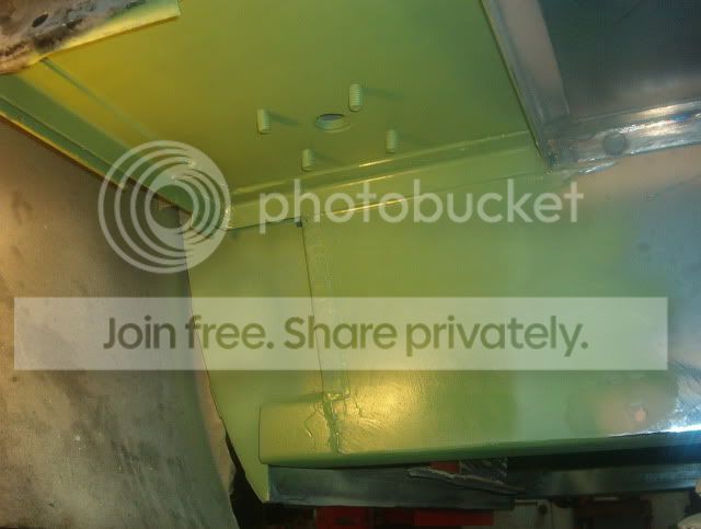

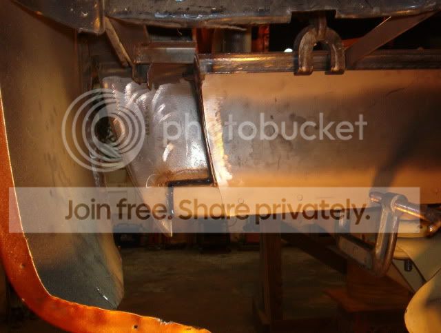

changed up the frame/floor design a little in an effort to make everything under the truck more easily rinsed out and not have catchspot's for mud, etc... here's the corner I changed up... took out the small angle pieces...
tab......
and squared off that whole upper corner....
should rinse out good.....
hopefully get a good day in tomorrow.....

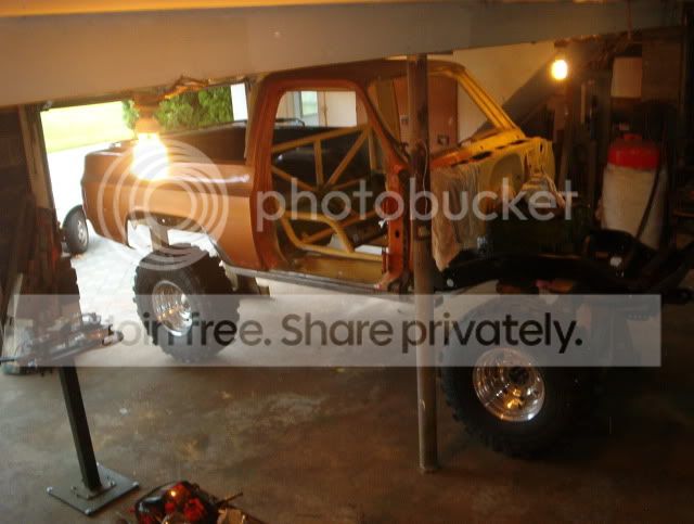

I would like to formally request some long shots of your truck showing the whole thing from as far away as you can get with the camera... sometimes after a few dozen close-up shots in a row it's hard to visualize how it's all relating to the overall vehicle.

I was very pleased with my design change yesterday.. doesn't look like much, but I think it came out way cleaner that way... I'm also thinking of doing a V'ed frame tie-in off that center B-hoop flange... I'll have to wait on that till I finalize the drivetrain/exhaust tho...
I'll do some full shots later today... :D

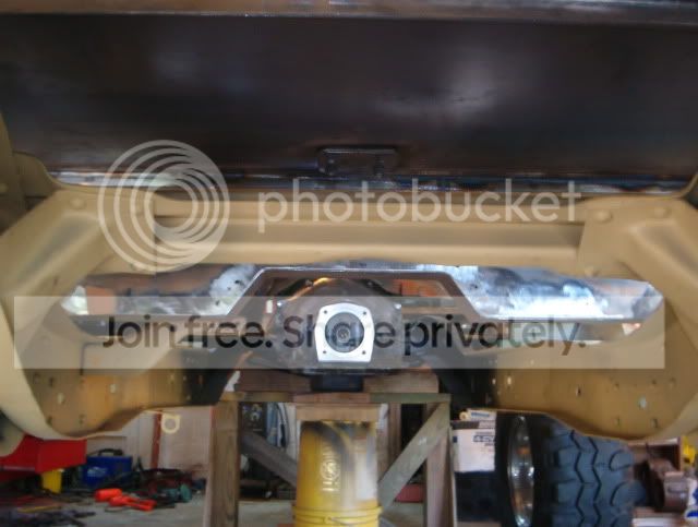

most of the back floor area is done... just need to do the seam back a couple feet, seamseal the underside, prime ( I ran out of epoxy).......

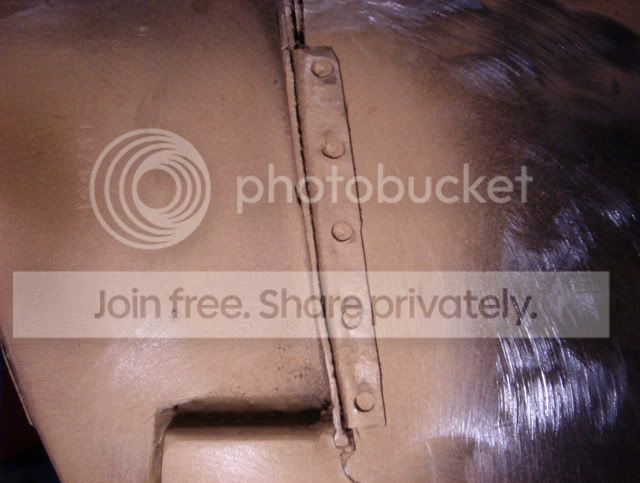

here you can see the center staked flange...

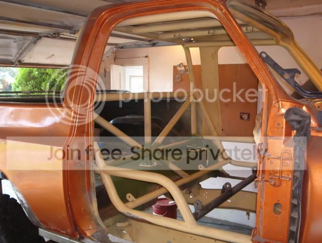

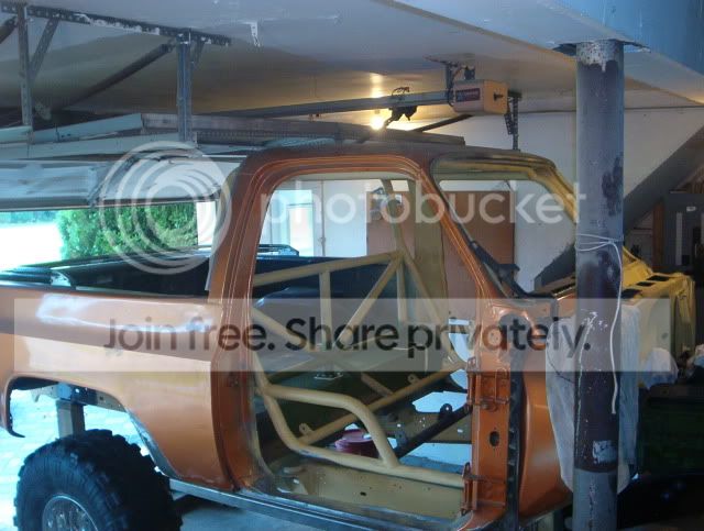

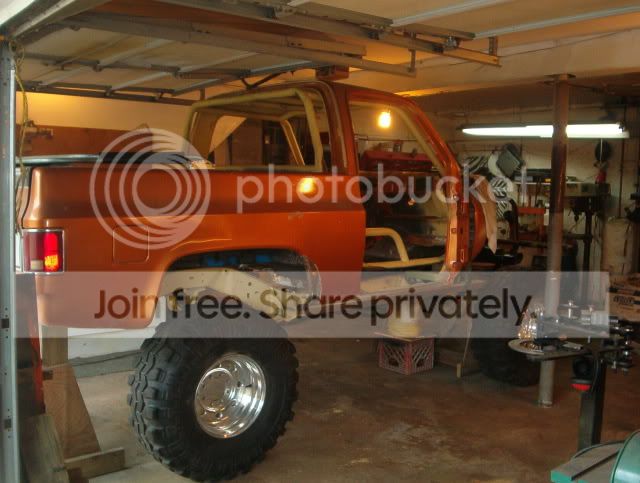

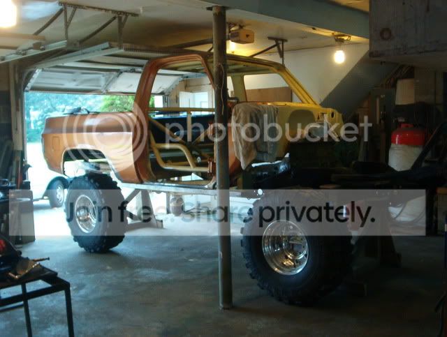

and some full shots....
the rear floor is done enough that I'll move on with the fab work next weekend...

I actually have 2 sets of freebie rollers out back...
it should sit a good 2, 3" lower than that when the running gear goes in..... but I'll definitely miss parking it inside at night...

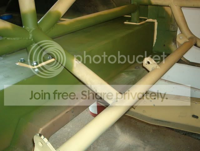

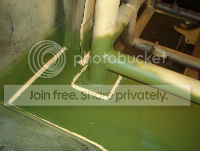

I'm sure you mentioned it, but what is the difference between the green and the tan paint? And do you seam seal everything after you paint? Or does it matter? I notice you've done it both ways.

well, all the raw steel, eventually has the green zinc chromate on it first, then the tan urethane primer on top of that..... in other words, all the tan you see has green under it.. I bring different areas thru various stages of prime, depending on where they are, am I gonna be working in the area again, etc...
zinc chromate is the best etching primer you can run... a 2 part wash is the best, I'm just running the rattlecan stuff, but it's still killer... the tan urethane primer is basically an easy sanding epoxy primer.... it's a high build, filling primer... I run Imron (satin black) or Chromabase (copper) on top of that...
seam sealer.... I usually do it between the zinc and tan primer, but I have done it on top of the tan too.... just a timing, etc thing.. I'm big on seam sealer, keeps water out of joints, etc... I actually seamsealed the non-welded areas of my weld-on steering box brace, to keep water from getting between the plates...
I'm there, "might as well" make it last.. peace of mind and all that.... :D
Thanks, that clears it up. I use Zinc chromate on bare metal as a primer. Rattlecan is easiest for me. Paint wise, I just use the rustoleum semi-gloss in the gallon cans. Usually brush/roll it on. I don't have the skills to spray like you do.
the tan isn't an epoxy, it's a urethane primer.. basically the same thing, just more user-friendly...
it's Dupont's Nason 2K Urethane primer... VERY economical, about $90 a gallon for the primer and hardener..

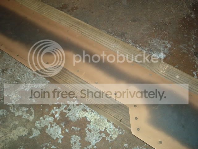

actually I normally use hardwood blocks whenever possibly for alot of stuff.. being a marine guy, I snag block from work all the time... I've got a bunch sitting outside...

Looks good, thanks for posting up the distant shots for a sense of overall perspective.... It's funny to see that we both have an annoying garage support post to work around!! :D
