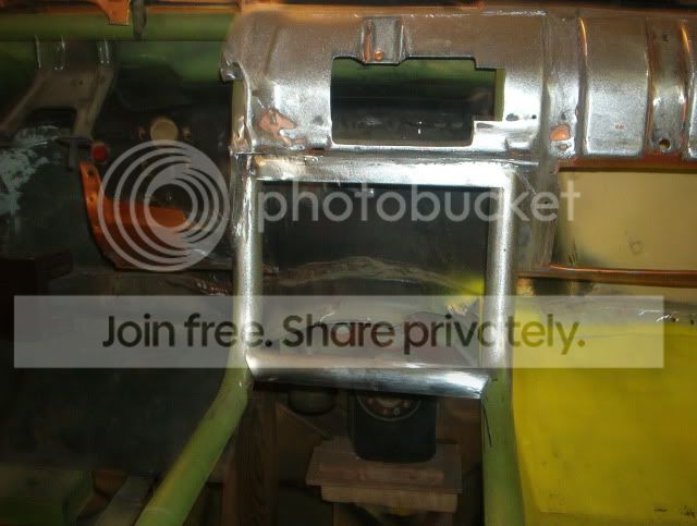

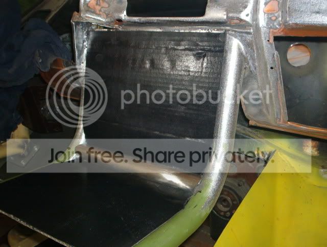

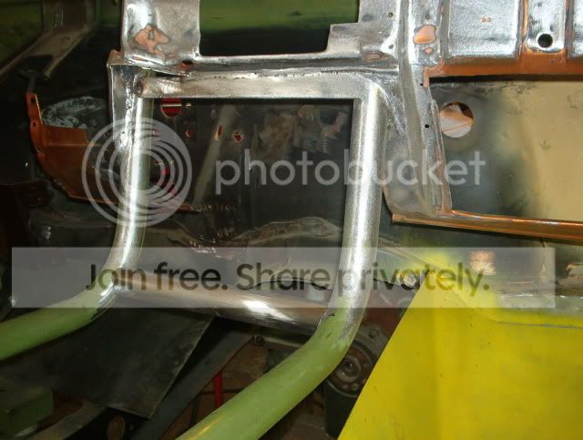

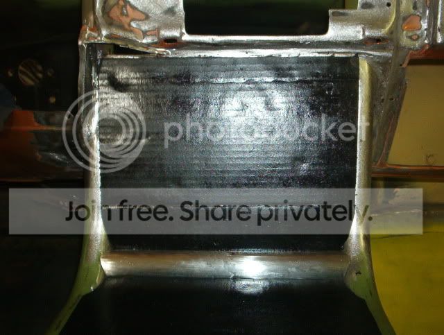

thats 1" x 1/8" flat stock I added to the bottom lip of the dash.. the panel will mount on top of that with 1/2 the side tube exposed.. I still need to do the triangle in the upper left... and 1/2 that lower tube will be exposed between the 2 panels.......

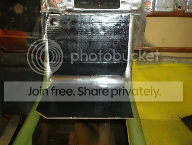

saturday I get my composite, so hopefully I can start cutting out console panels this weekend... hopefully Kert can bang out my panel tabs too... :bow:

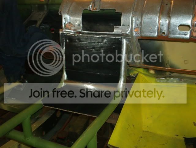

some template work from this weekend...
chomping at the bit to go pick up some composite sat....

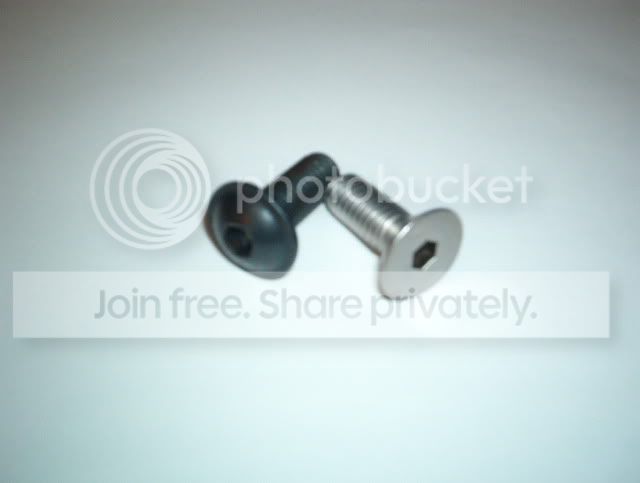

Can you counter sink just the head of the bolt into the composite enough to be flush?? that'd be awesome. :D
well, I was original planning to do some flush-mount countersunks, like my winch plate...
but that's gonna require being balls-on with the holes, welded nuts on the panel tabs AND I'm only going 3/16 on the console panels... still stiff and strong, just a tad more sane, weight-wise, fitting, etc... plus cost...
that makes it difficult to countersink em.. the bevel depth is a 1/4" for a 3/8's... but the REAL reason is, it's a little cheat for me... little more wiggle-room for the mounting... I did think about it, and think i can pretty easily go in and countersink the holes afterward, get new hardware and go flush... might work ok cuz you have the thickness of the panel tab before it gets to the welded nut..
i'll see how I like these.. tho it could look pretty sick with flush stainless ones like the bumper on all the panels...
screw it, I just ordered both... :haha: I'll decide when I mount em... :bow:
oh, the other ones i ordered, stainless countersunks.. same exact ones that are in the winch plate....
http://www.mcmaster.com/#order-history/=3ritid
actually, f*ck it, whats a bit of extra work.... :doah::haha: I think the flush stainless on the black panels would be sexy.. kinda fighter plane-ish..
and I have other, hidden spots (the pc enclosure, cargo wall, etc) where i can use the black button ones...

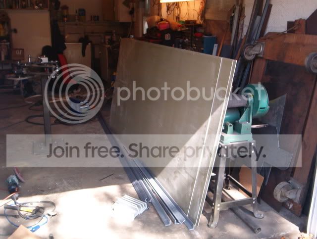

went out to Trenton this morn and picked up 3 sheets of 3/16 composite, and he threw in a bunch of angles and scraps...

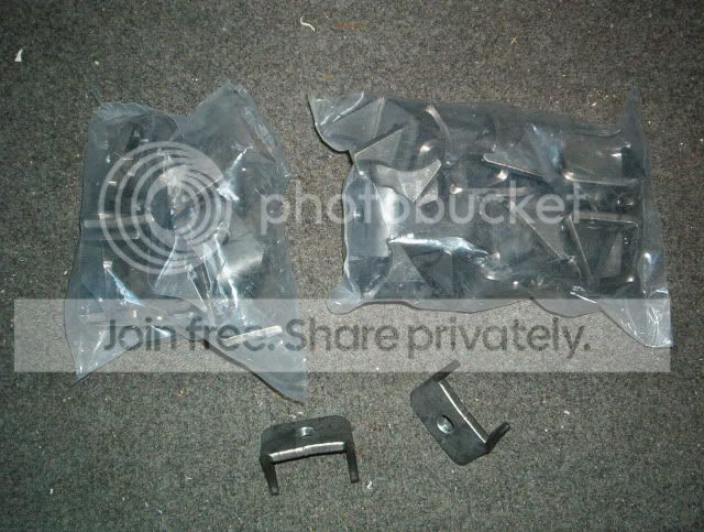

then, to top it off, when I got back, a package o'goodness from Kert was here... big props to Kert and Tracy for getting them out asap! :bow:
