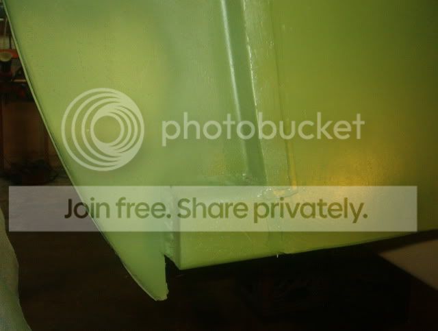

you can flow it out, smooth it, etc with an acid brush or small chip brush and water with a little soap in it...
seam sealers are a good habit I learned back in the collision shop days...

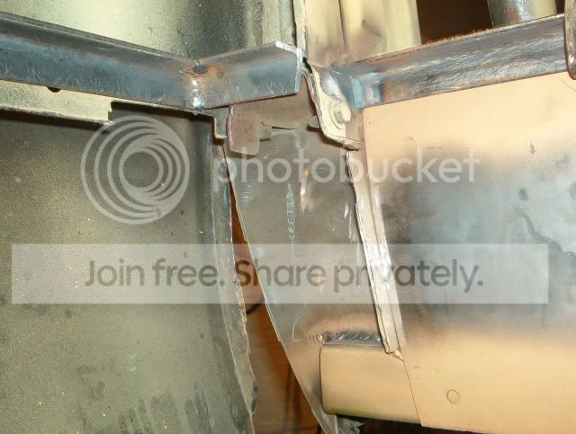

changed up the frame/floor design a little in an effort to make everything under the truck more easily rinsed out and not have catchspot's for mud, etc... here's the corner I changed up... took out the small angle pieces...
and squared off that whole upper corner....
should rinse out good.....
:D:bow::wink1: ALWAYS being considered... should be pretty smooth and cleanable underneath, floor, etc...
