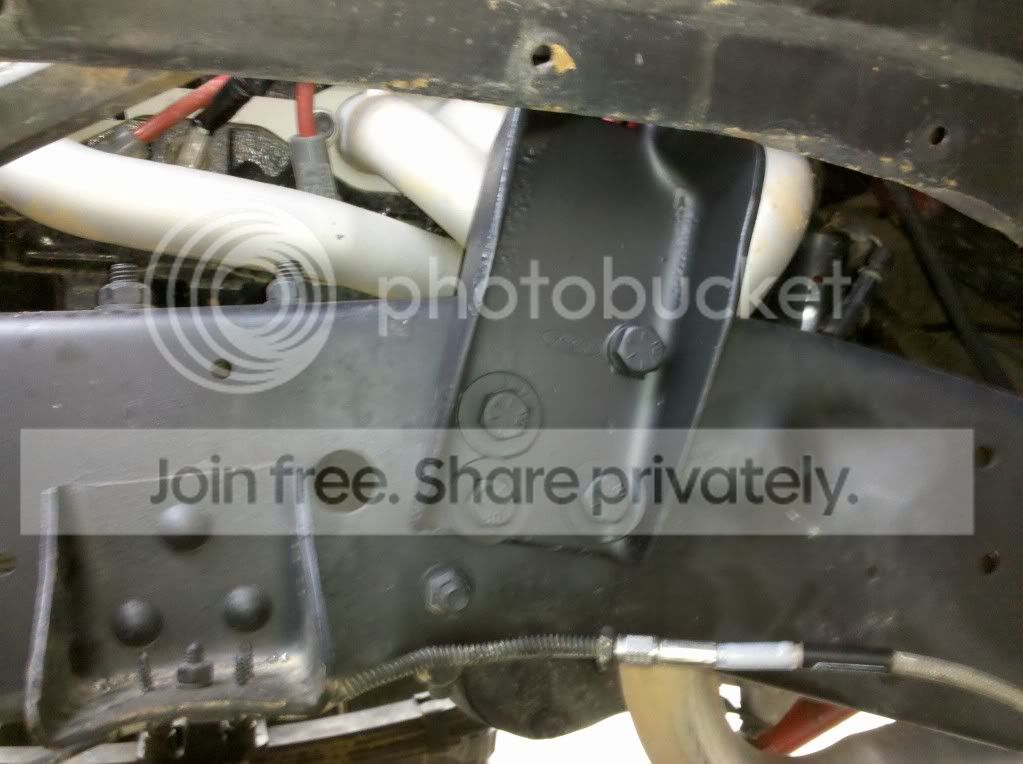

Here is what I'm working on.

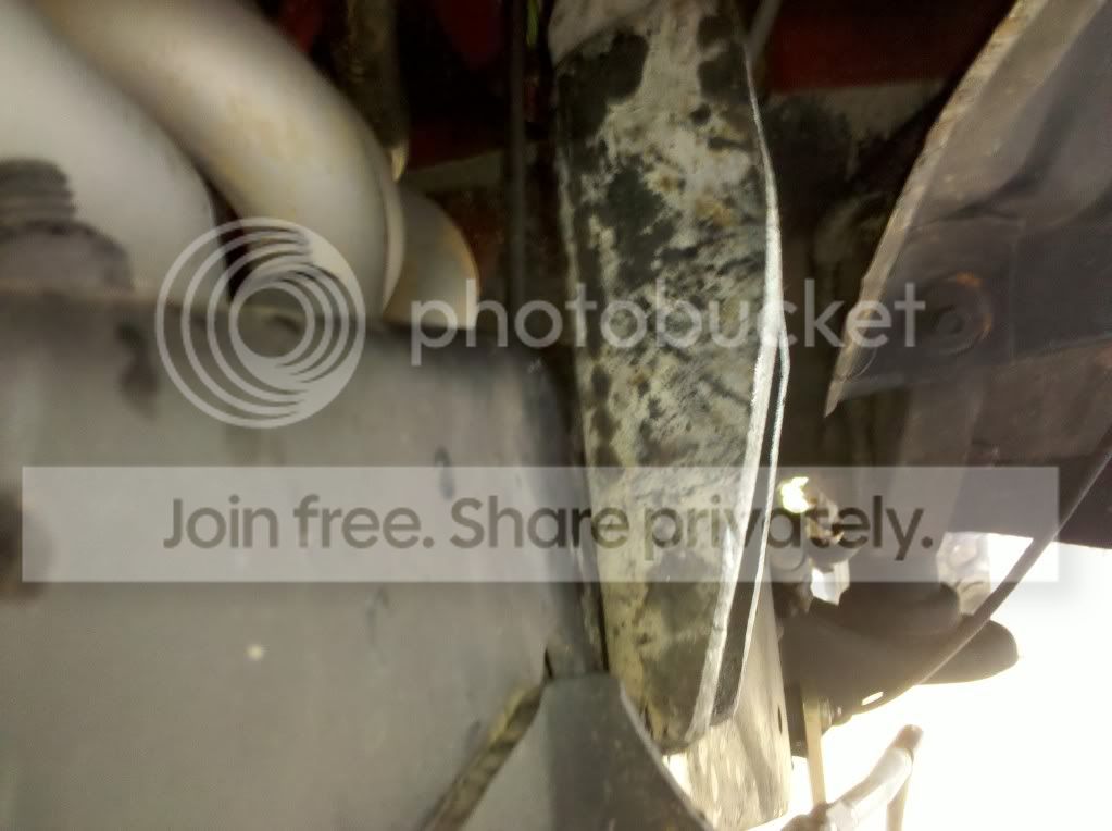

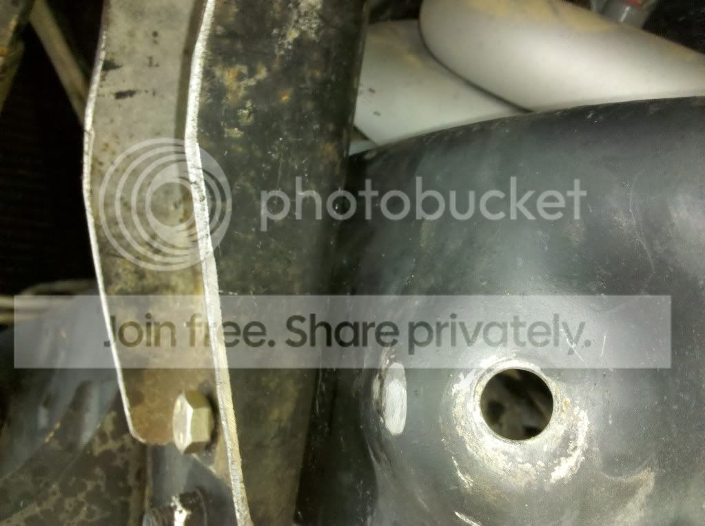

I grabbed these off a 2wd DRW Ford.
Cut the bottom off.
And mocked up. This is about where they will go.

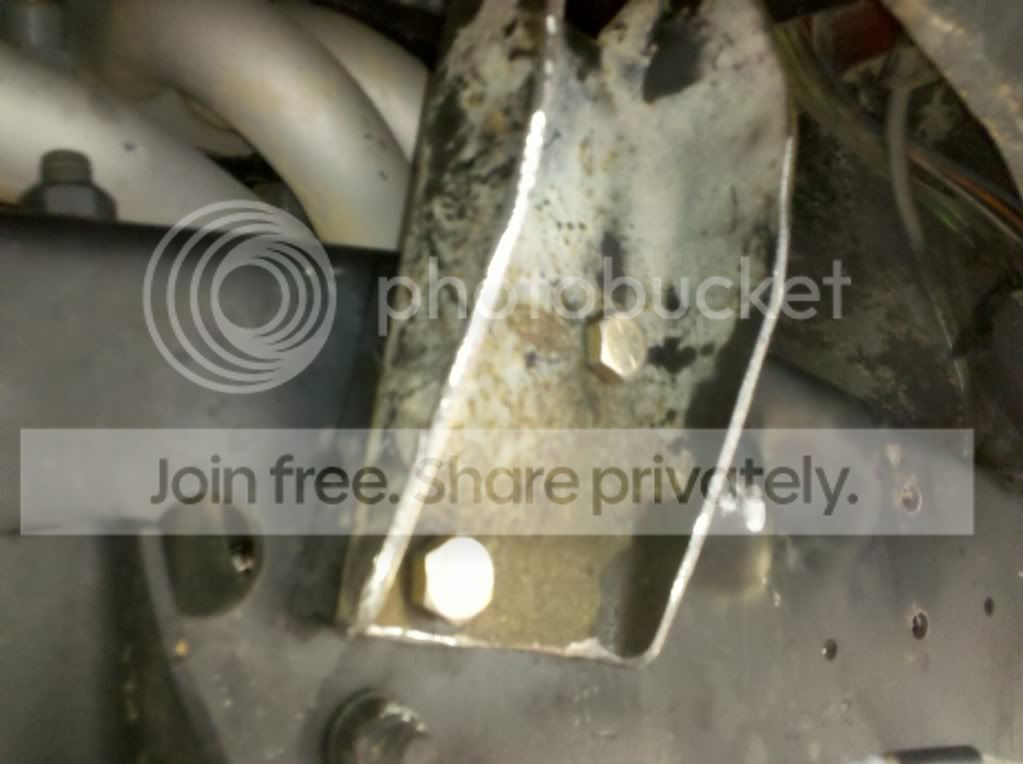

They are bolted on, and there is a couple different kinds. I got the stamped steel ones:
I took the afternoon off to get some work done. Its not easy with the tools I have. It sure would be nice to have a drill press. I have two out of Four bolts done on one side. I sure wish I had more time to work on this. The wife, kid, work and holiday shopping aren't helping.
It doesn't look like they are belveled and grinded the same, but they do match and look pretty good for my skill level and available tools.( can't wait till Christmas).
I have a 4x4 5/8 plate going on the back of the frame. It will be fun drilling those holes. Then I will paint it flat black like everything else. Ok, back to work.

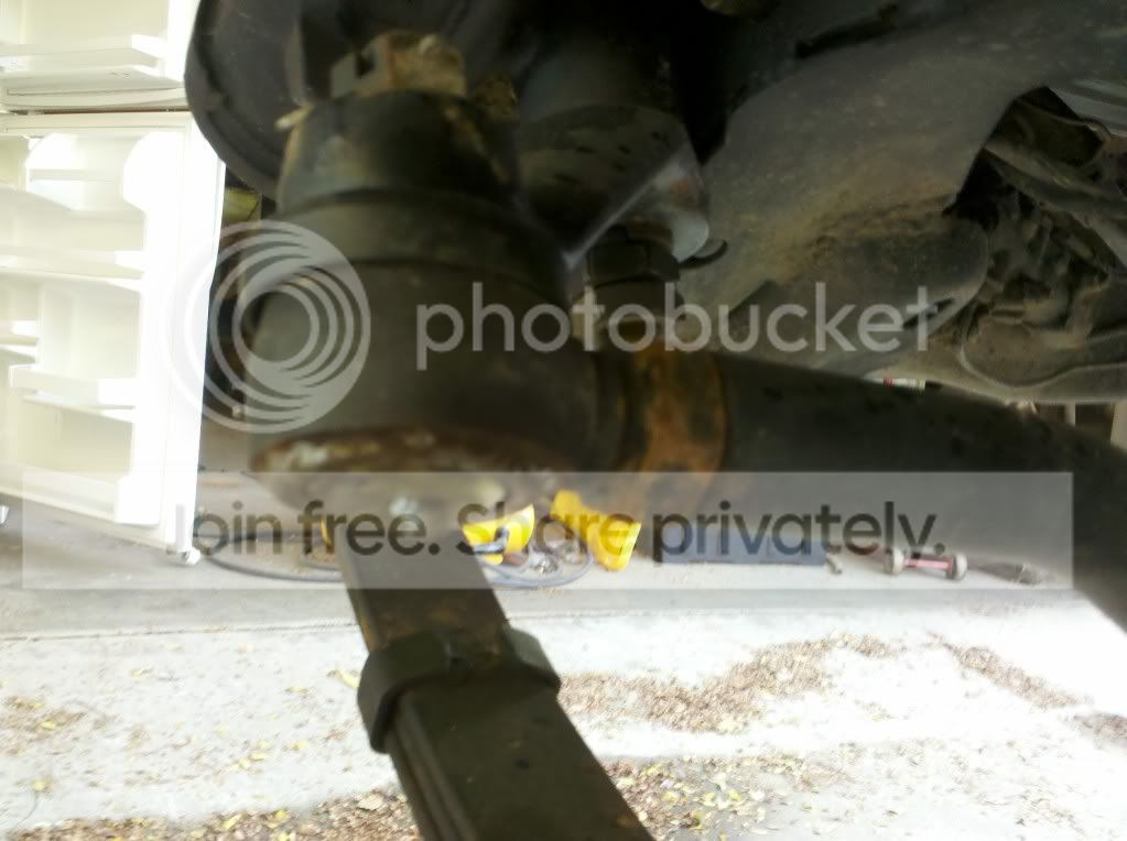

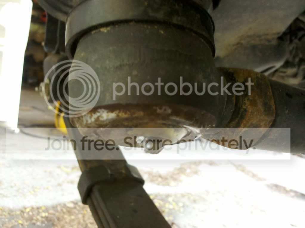

Crap, I just noticed this. I must have crushed it jumping. It only has 20 miles on it. I need bump stops.
LOL man that kind of sucks! Oh well, it should be easy to get off, eh?
Nice work on the shock mounts, can't wait to see that all finished up.

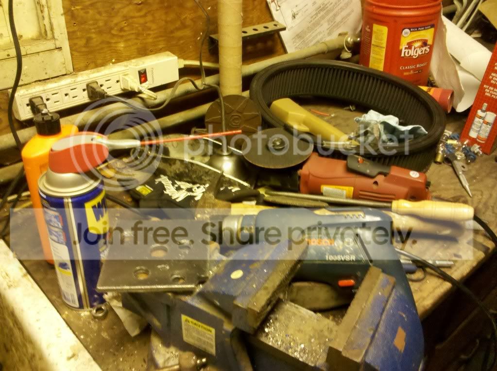

Here is a pic of my shop tools! This is what I'm workin with! I need tools!!
Pretty comical!! I know what your going to say. "Go buy some tools"!
I will tell ya, its hard drillin a bunch of holes 1/2" without a drillpress. I need one! I wish I lived next door to a few members here!!
Haha, try drilling 5/8" holes in steel plate with a 3/8" Black & Decker single speed drill...
It goes slower than my other single speed drill at least. And by single speed, I mean you pull the trigger, it's "on", no variable slow speed at all!
You tend to hear a lot of "Ahhh! My Hand!" when I'm drilling LOL!

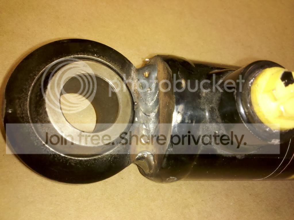

Well, I finished the upper shock towers. I dont know how long I will use these, As I can see I will need more travel. There is about 6" up and down. I need more than that. I just need to get the bottoms welded on.
