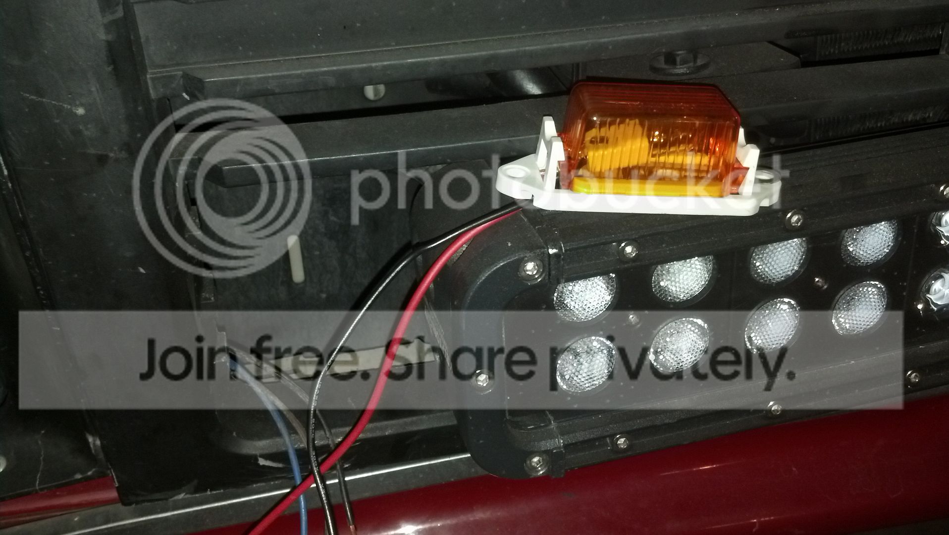

Anybody know how these wires fork for the turn signals? I need smaller turn signals. I bought these smaller cheap running lights. I soldered a negative wire on because it didn't come with one. Maybe that's my problem. These weren't made for signals. I have two wires on the light and the three factory. I guess the third wire is for constant on when the head lights are on. I don't need that.
What is the best option. Thanks fellas!!!
The factory wires.
And the light.
you don't have a multimeter? Find out what wire gets power when the blinker is on. But you really should do some kind of running light :)
Well. I do have a multimeter. Forgot about that. Since I cut the bulb off they don't blink anymore. Just stay on when the signal is activated. I will be working on the rig all weekend. I'm sure I will figure it out.
Or do what I did
Give up and just ziptie the factory bulb holder to the core support and drink a beer :D
I hated having the blinker attached to the grill. You don't want to try a trailer or RV place for some nice LED lights with 3 wire hookup?
You need two of those.
Both the turn signal wires are power one for running lights and one for turn signals.
I had to run two of those exact same lights. To get mine to work.
Blue is your stock turn signal wire, grey is for your lights when you turn them on and of course black is for the ground.
I'm not the best info here but all your signal lights have to work for them to actually blink, also.
Well crap. I went to tractor supply and two junkyards this morning. Couldn't find a decent pair of 3 wire signal lights. I might have to just re connect the light and leave it. It will probably be broken soon anyways.
