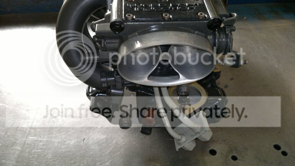

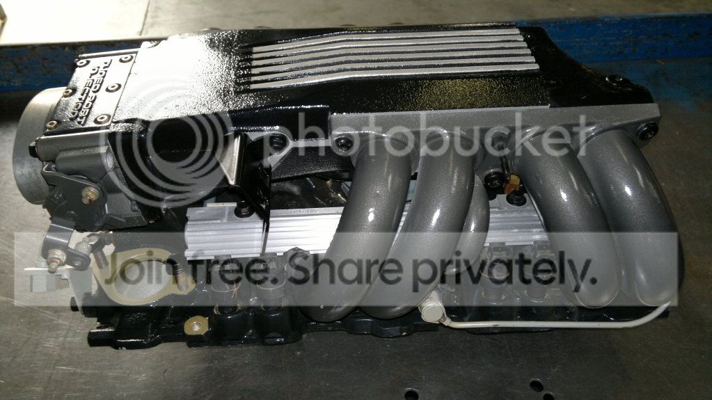

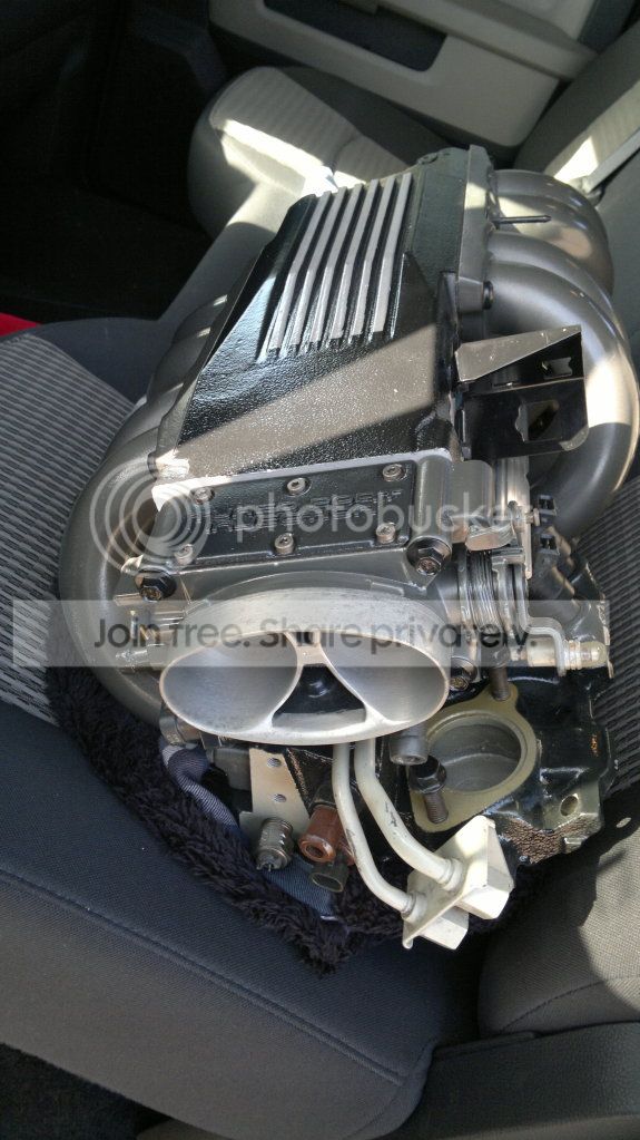

heres some pics of the TPI i picked up..
Nice looking unit:thumb: I have one from a 91 T/A that I'm going to put on mine. Coolest looking intake ever IMO.
You will need a higher pressure pump but I don't know a part number. I'd do an adjustable fuel pressure regulator too.
As for wiring, I know there were a few places making conversion harnesses, but what are your plans for the computer? I'm not sure if the factory TBI computer will work with MPFI:dunno:

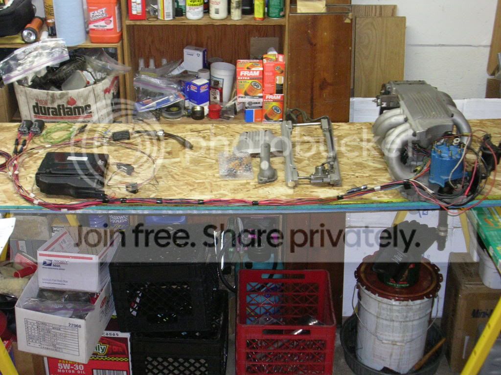

There are a few options for wiring.
1. Build an underhood TPI computer and wiring harness (1990/91 Corvette clone), more or less like the one pictured here that I built. (Excellent wiring skills required)
2. Rework the current harness TBI for TPI. (Excellent wiring skills required)
3. Contact a custom harness builder like: http://www.larryselectricsite.com/storefront/viewitem.php?productid=2
The TPI pictures posted are for a MAF sensor type TPI. I recommend getting a 9th injector (cold start injector) block off kit, and use a MAP sensor TPI computer like the kit offered by Larry's Electric.
Here is the video of the TPI system I built running the engine on an engine test stand.
