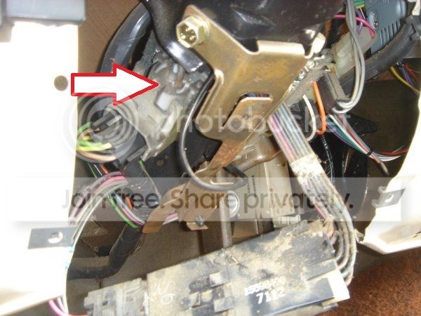

Anyway, after looking over any overt wiring/fuse stuff, I'd suspect the dimmer switch at the base of the steering column.

I'd still suspect the dimmer switch. To clarify, not the dimmer for the dash lights, but the switch when you click the turn signal stalk.
Oh, you mean the dimmer switch may be defective as opposed to accidentally switched low?
Yeah. Assuming all the wires are hooked up, that's where I would look. Not super easy to get to though.
