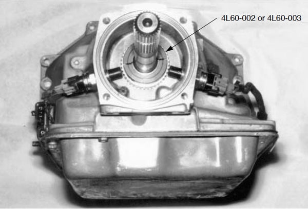

After I realized that I wouldn't be able to finish that today I started installing the transmission controller. Right now the controller is just sitting on the floor in the cab but I plugged in all the wires from the controller and the transmission and then uploaded the program to the controller. When I started up the car I left it in park. Everything looked like it was working fine but then I started getting very faint smoke in my cab from where the np208 shifter use to be in the floor. I went underneath the truck and DAMNIT! There is a very faint smoke pumping out of my transmissions vent tube. I turned off the engine as soon as I could. I didn't even need to figure out what the problem was. I already knew. Remember the other day when I STARTED to fill the trans with oil. Well, I never finished filling it! When I checked the stick it showed it as empty! I put 2 gallons in it already but I guess that wasn't enough to be pumped through the transmission. I grabbed some ATF and started to fill it up and some faint signs of smoke/steam where coming out of the fill tube as the oil went in--not good. So after that I let it sit for 5 mins and checked again and it looked good this time. So I started it for 1 min and then checked again and it was still good. So I started it one more time and put it into drive this time and the transmission output shaft was turning fine (drive shafts are still not connected). So the damage wasn't terrible but im sure I reduced it life by probably 50K plus miles from just 5 mins of starting from yesterday and today.
On a good note the controller seems to be working fine. I just have to install a temporary 40 tooth output reluctor ring on the driveshaft.
Company Photo of Ring
I have to do this because my transmission doesn't have an internal output reluctor ring. There is a permanent fix that involves modifying the tailhousing of the NP205 but I wont be doing that until I move to AK due to time. So, for now, Im just going to install this external ring I got from a website called jagsthatrun. I would not recommend anyone use this as a permanent solution even though its sold as one.
