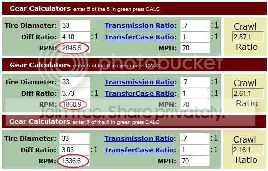

With 33's and a 700r4 I vote 4.10's also.... this calculator isn't perfect but it'll get you in the ballpark. All three of these are at 70mph and 33" tires the first being 4.10's then 3.73's then 3.08's.
With 4.10's you'd only be around 2k rpms at 70mph which is perfect IMO.
