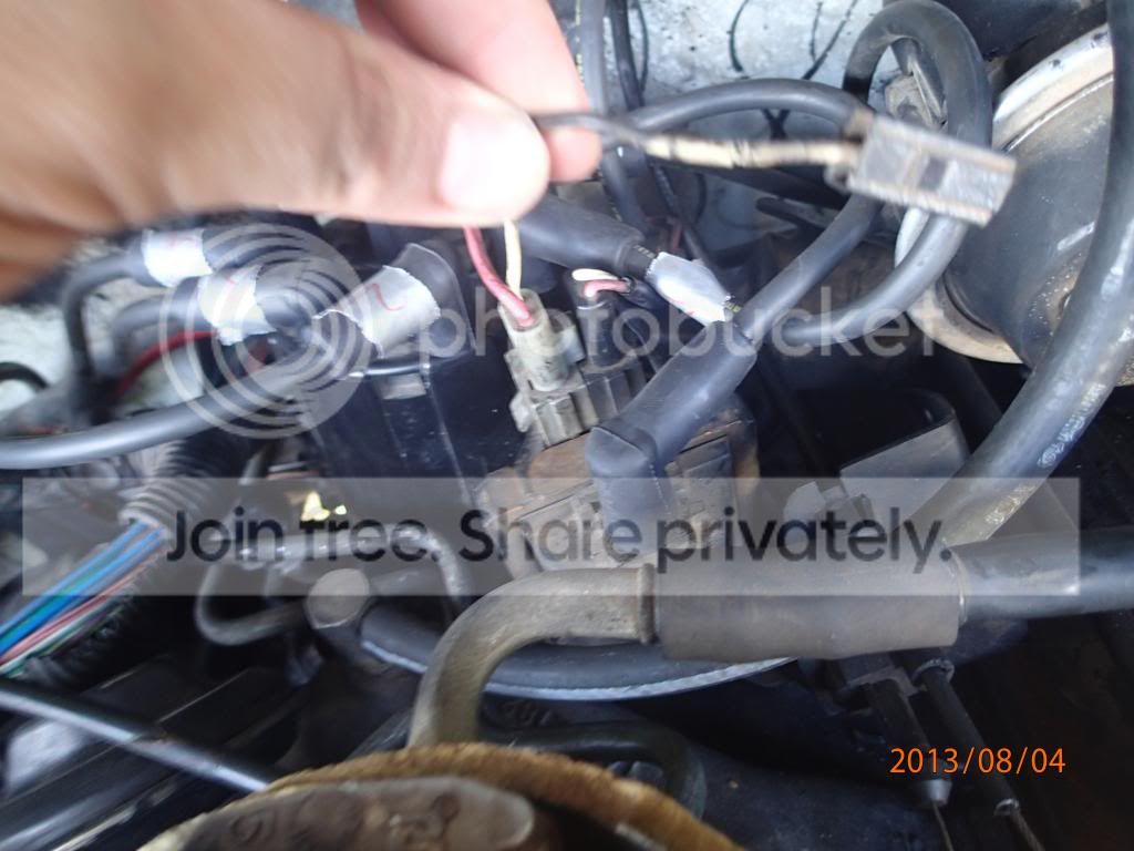

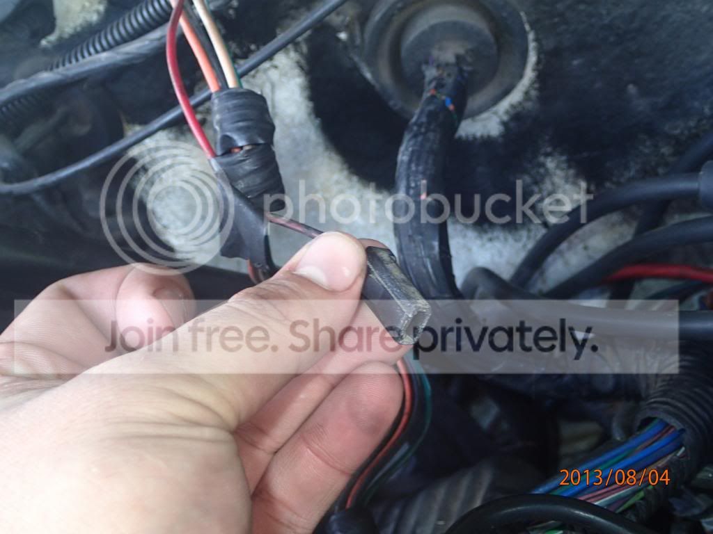

turns out the problem was the Ignition control module. replaced that and it stays running just fine. the problem now is the truck runs like total crap. it idles and starts up fine but once on the road it feels like its missing horribly. maybe i messed up the timing while i was messing around under the distributor, idk. ill have to wait until later this week to get under the hood again. i did notice that there are 2 wires disconnected under there. i think on is the EST wire, and the other one comes off of one of the pigtails for the ignition coil. idk what that one is for. i didnt diconnect them so ill have to see whats up with that. any of yall know what those wires are?
this one is coming off of the grey pigtail on the coil. single wire with a blade type connection
this one is coming from the harness running on the left side of the distributor. i thinks this is the est wire. am i right?

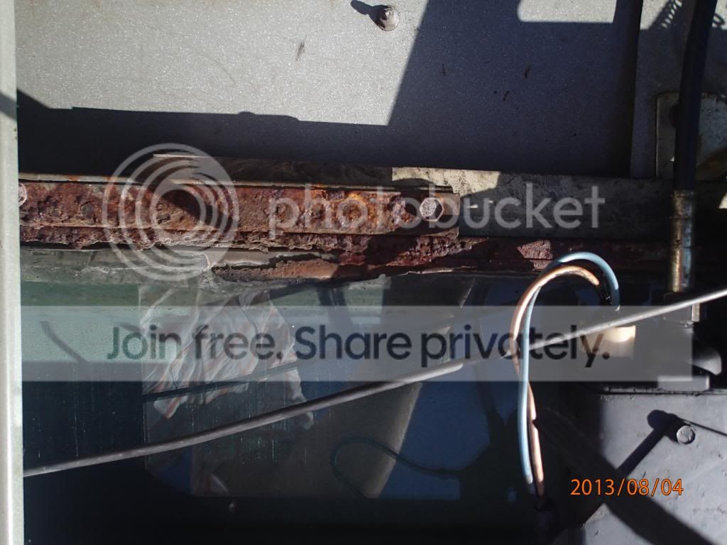

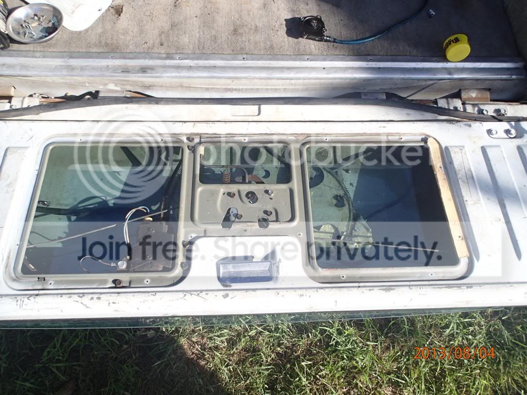

while i was out there today i decided to tackle the back window issue. i really want to take the top off so i had go get it fixed. when i tore into it i found that the cable was locked up. instead of messing with it i just removed it and replaced it with one from my parts truck. works like a champ now. only thing wrong in the tailgate is the track that the glass rides in is completely rusted out. ill have to tear the tailgate apart later and replace it, the window is barely being held in by it. i find it strange that the track is rusted out but the rest of the tailgate is fine, no rust whats so ever on the inside.
torn apart
the rusted track. i think LMC has these ill have to see if i can order a new one

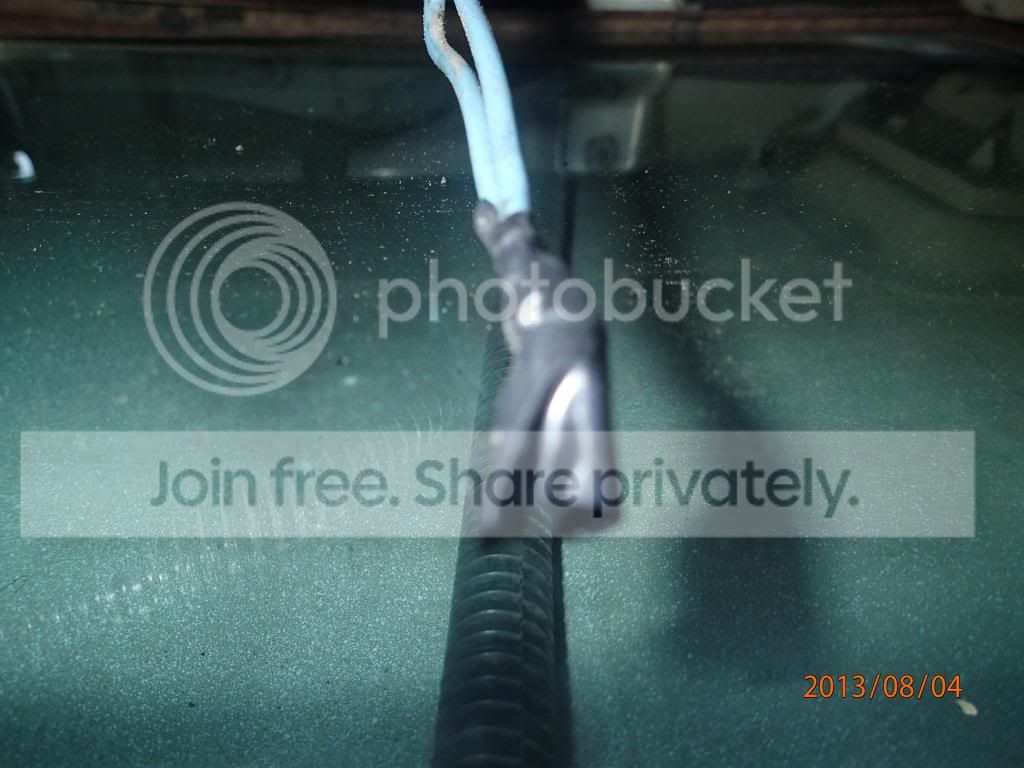

while i was down there i yanked and spliced that safety switch that seems to always go out. not a very good job but ill do it right when i take the tailgate apart to fix the rusted track
