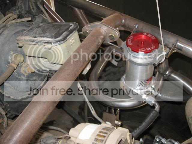

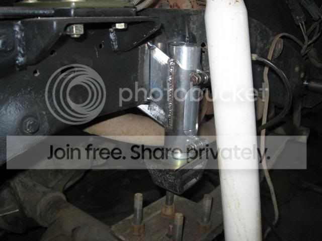

Front shock hoops should be here tomorrow, so soon we can get back to re-mounting the shocks. The drivers side rock slider is tacked into place. Last night I ordered four of these: http://www.polyperformance.com/shop/Synergy-Suspension-Budget-Bump-Stop-p-25577.html They will be mounted to the frame with air bump can mounts. Then I have a 4 rubber bumpstops I got from the back of s10 blazers and they will be screwed into the aluminum budget bumps. This way, in the future as funds allow, I will eventually order up some air bumps and they will simply replace the aluminum budget bumps

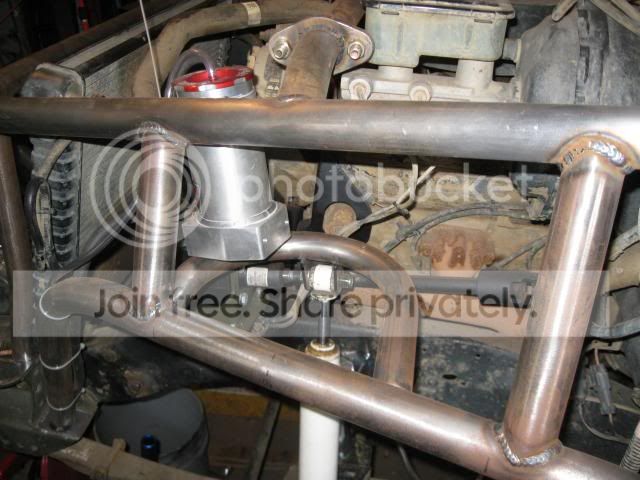

Low Range Off-road shock hoop is tacked into place. A support tube will be added later. There's about the same amount of the shock shaft showing but now the shock is leaned inward so that will give more up/down travel

And here's the driver's side bumpstop and mount tacked into place.
Later on down the road I will replace the aluminum tube with an actual Air Bump but this will work for now. The bump will contact a plate that is gonna get welded to the spring plates

Bumpstop contact pad welded onto the DIY4X spring plates.
