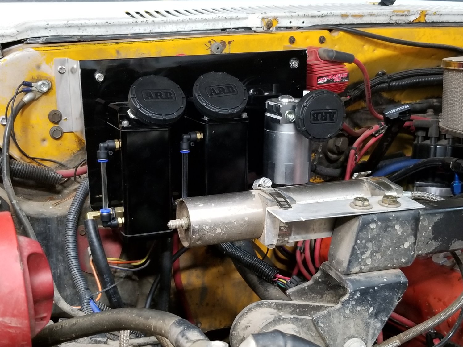

I mounted the catch cans for the trans, Magnum, and tcase vents.
full
The black cans were less than $20 on ebay. I didn't like the filter thing that came with them so I found these ARB filters for $10 to use instead. The silver can was about $25. In hindsight I would have rather done all 3 like the silver one; the black cans are a little larger than I expected.

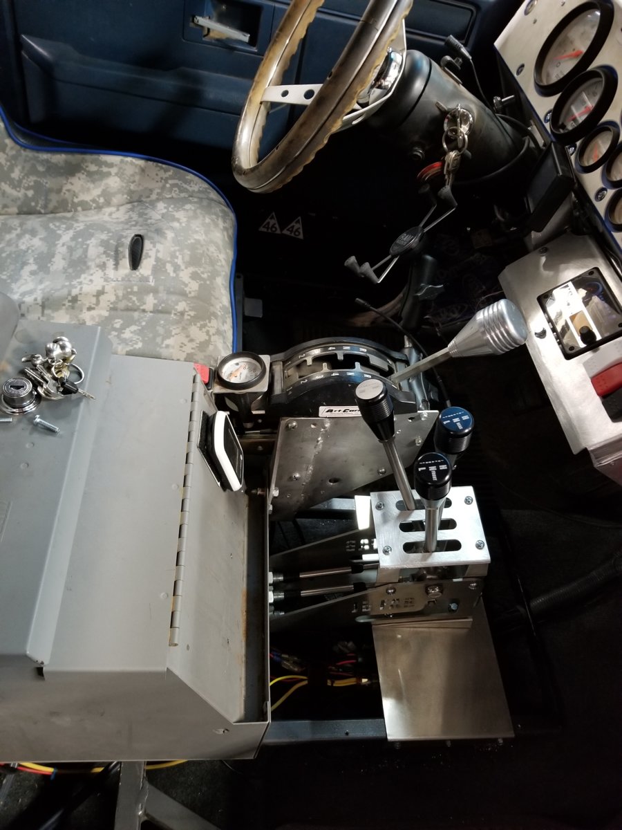

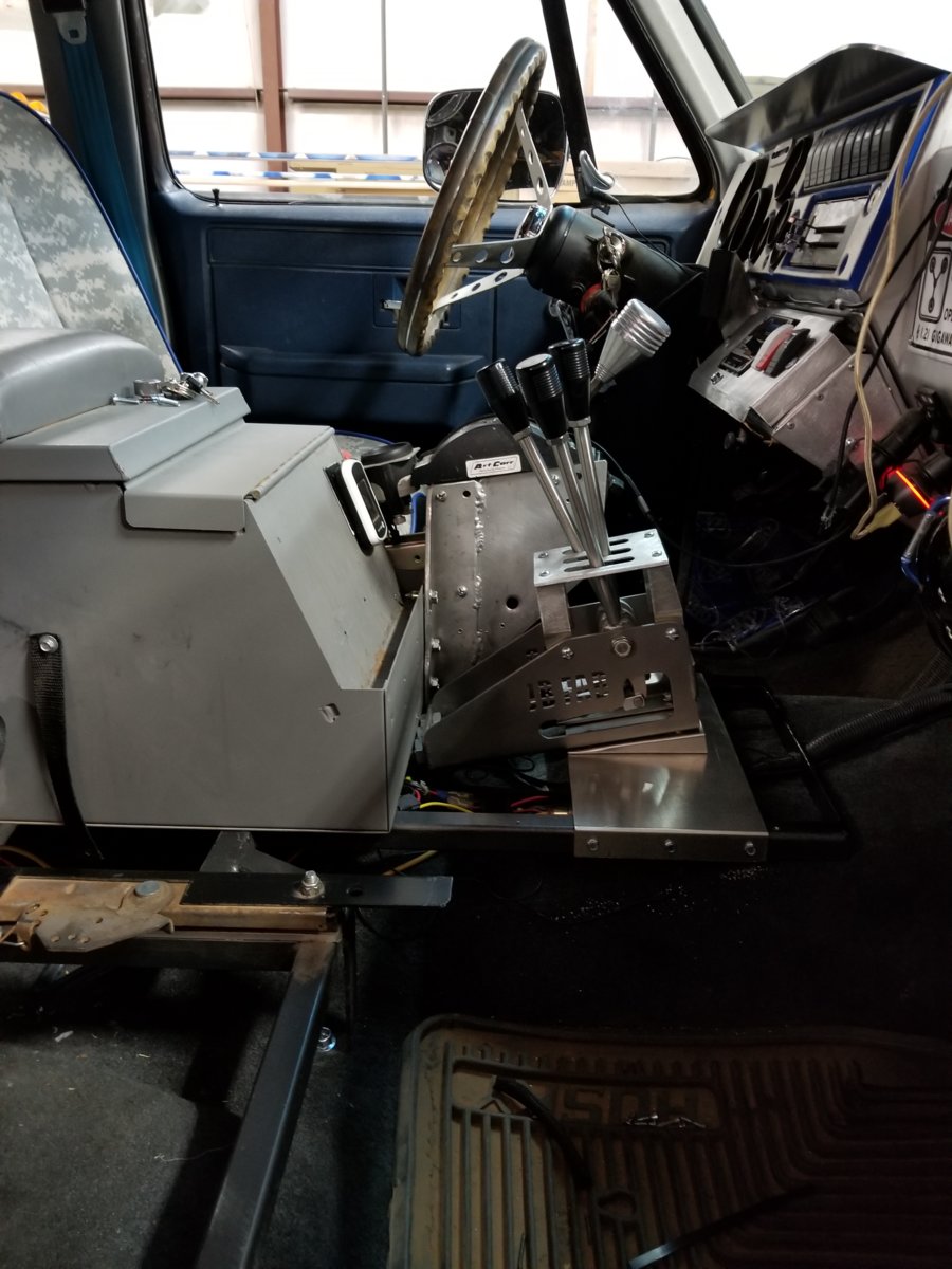

The other big visual thing I finished was mounting the shifters.
full
full
This is kind of a trial mounting. This is where I think I want them, but not sure until I've driven it a little bit. One of the things the factors will be cup holders. I figure out what I did with the cup holders that bolt to the console. As soon as I can find them I can see if they will still work. I know for sure the cup holder mounting will need to be different, but need to make sure it's even doable.
