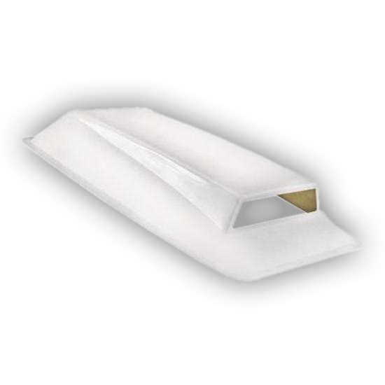

Those hood louvers look cool. I am doing a similar thing with my crew cab. I bought a hood of a 1988 Burb in the junk yard, and I am going to put a functional hood scoop on it to get air flow through the engine compartment during the hot summer months. I am thinking of going with one of these two pictured.

Hood scoops don't get air flowing through the engine compartment. They get fresh air to the carb / intake. A scoop that gets air from the front of the hood area would be a better idea.
Holes in the side of the fenders behind the front wheels would be better idea to get air out of the engine compartment.
I run the factory stock air duct hose that a Chevy truck comes with to feed cool air to the air filter box.

One of the worst mods I did on my old truck was a hood scoop. The scoop was always in my line of site while driving, it looked cool but just wasn't worth it.
I had an 1970 SS Chevelle that had a tunnel ram on it. It was a bitch to see around, but it was so cool looking. One of the scoops I am looking at is only 5" tall. Now if we can just clutter up MRK5 build thread with more stuff that does not pertain to his build. :D
