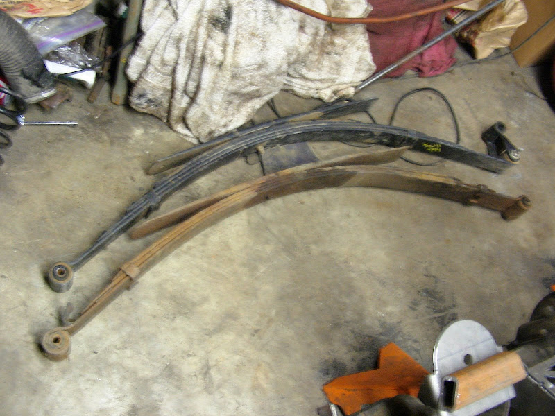

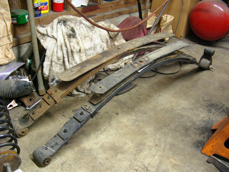

a little update. i picked up some springs today from the junk yard. from what ive read, these were the ones i have been looking for. they are from a 98 dodge dakota. after getting them home, i compared them to the springs i was using to mock up with, rears from an 88 f150 (4wd). the appear to be very similar, they are the same length, and have the same free arch. the ford springs however are 3" wide verse the 2.5" of the dodge springs. the dodge springs also have the pin farther forward, but only 1 inch. then i compared the spring rates by standing on them and jumping. i put them side by side, and had one leg on each. then i would jump with my weight on just one leg, then the other to try and give them the same feeling. i can say the ford springs are noticeably softer. the ford springs are also 3+1 leaves verse the 4+1 of the dodge springs. this is a hard decision now, i was under the impression that the dodge springs were going to be way better than the ones i had laying in my back yard this whole time. but i got them for a decent deal, so they will not go to waste. i was expecting the center pin to be further forward, apparently people on the internet dont know how to work a tape measure correctly. the dodge springs are the ones that look less rusty and have the shackles still attached.

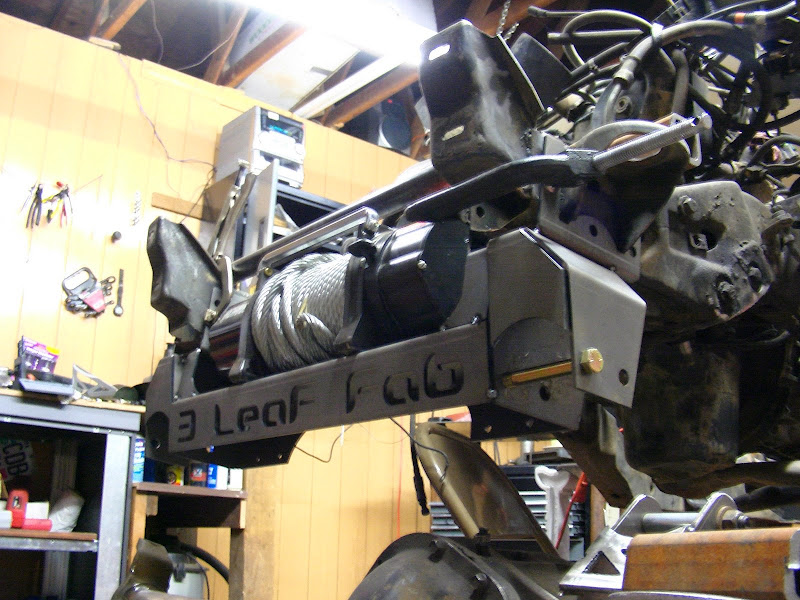

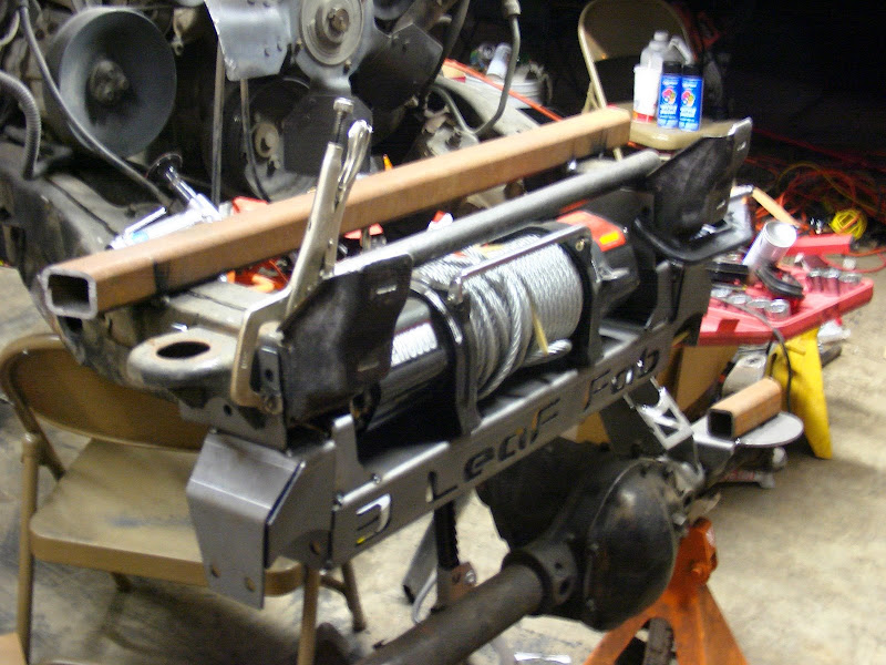

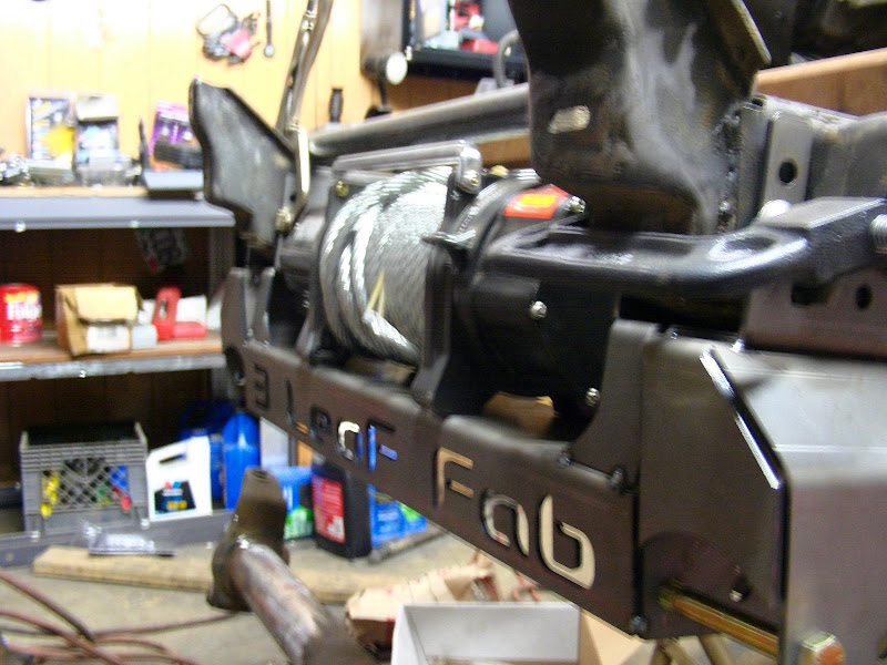

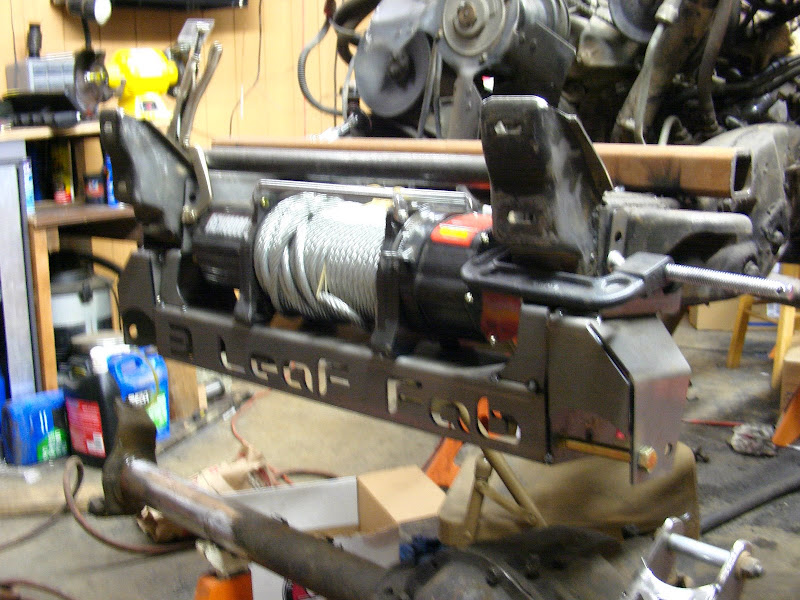

i also snapped a few pics of my crossmember tacked up and in place. i put the winch on to check the clearance between it and where the core support would be (there is a piece of pipe welded to the frame that has the same clearance as the core support)
