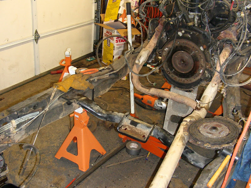

well, i decided to tackle the gear boxes tonight. i needed to get my doubler in before i can figure out my rear pinion angle. anyways...

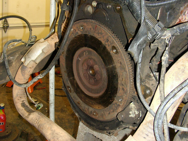

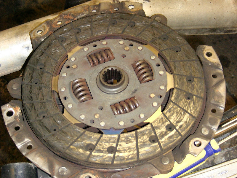

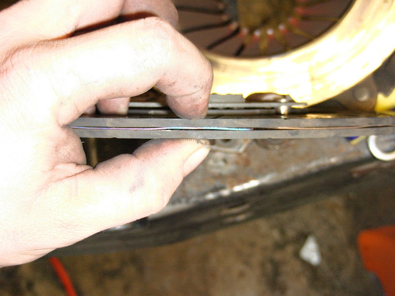

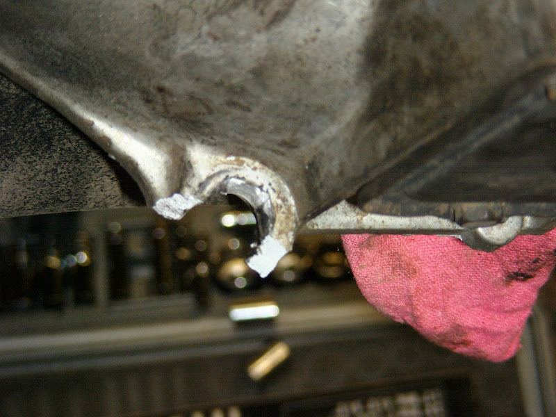

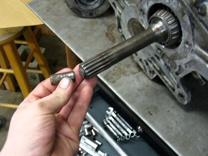

so i had a spare t5 ready to put in when i had the chance because my old one grinds a lot in 4th. well, i broke it (the spare one) trying to put it in after inspecting my clutch. i didnt have the angle quite right, and when i was trying to draw it in, i broke the pilot bearing portion off. on top of that i also broke an ear off of the bell housing.
the good news was my clutch as in good shape.

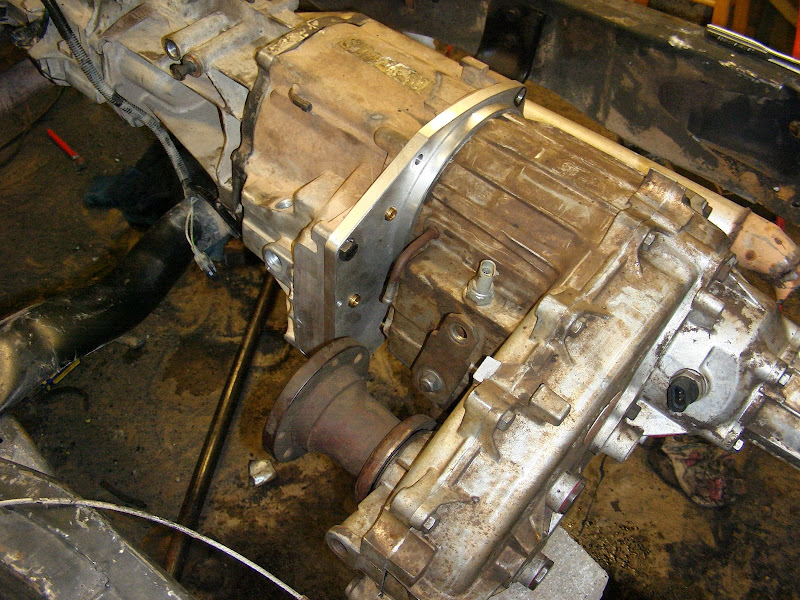

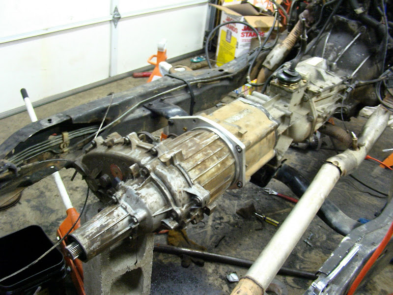

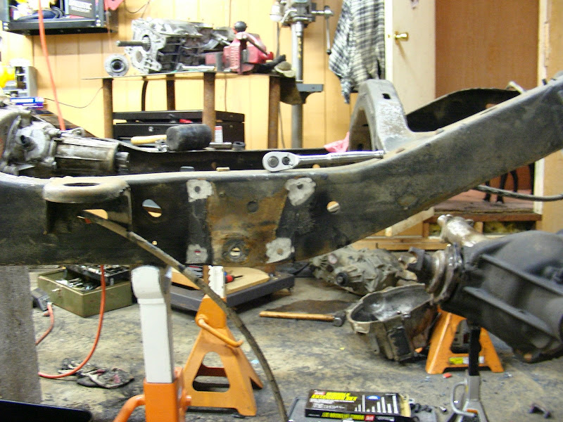

anyways, i ended up slapping the old trans back in with a spare bell housing i luckily had. then i went ahead and put the doubler in place. i still need to clock it up more, but this gives me a good idea of the condition of the rear drive shaft. it looks like it will be really short, about 26" from u-joint to u-joint.

Why don't you throw a wrench at the china hutch while you're at it, Bull! :D Why am I not surprised that you tried to force it and broke everything? :p::haha: Oh well, at least nobody paid too much for those. It's ok, I broke my spare tranny once too, before it ever even made it under the truck. So are you gonna swap the input shaft from the old one to the new one so you can have one good tranny instead of two bad trannies? That's what I had to do, and I'd do it again.
Oh yeah, the doubler looks good. Pretty long though! I think that puts mine to shame. But mine weighs more....I'll pretend that's a good thing.

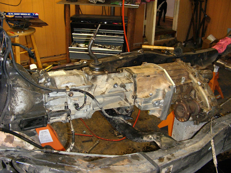

on the input shaft, i just went ahead and put the noisy one back in. i took the bearing retainer off to see how bad it would be to take it out, but i would have to disassemble the entire trans and i didnt feel like dealing with it, you know me. as for the length, it is 53" from the tip of the bell to the end of the rear slip yoke. its also 34" from the tip of the bell to the front output.
i had to clock the 241 up a bit to keep a flat belly. the s10 drivetrain slopes down a lot as it goes to the rear. but, this helps my driveline clearance so i am happy with it.
my gear boxes
the belly clearance
