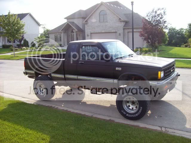

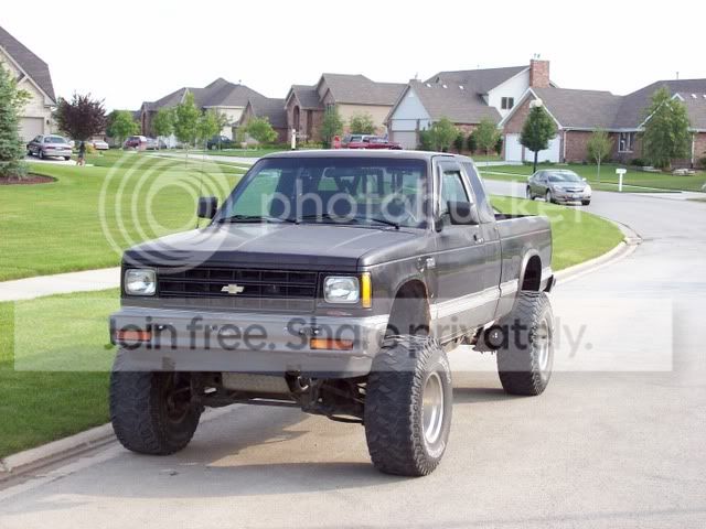

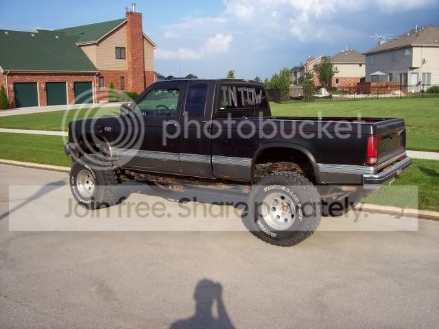

Well I went and picked up a 89 S10 Pickup from 4bynut yesterday.
Flat towed the SOB 148 Mile's. Wow that really sucked.
I have a week to get it ready for a trip :doah:
Anyway's here are the current spec's.
89 S10 Pickup Extended Cab
4x4
4" IFS Lift
3" Body lift.
305 / No tran's and 231.
I started disassembly of the engine today to get it ready to pull as the 305 is blown.
Tommorow I am going to Indy to Pickup a Motor a 350 and 700R4 with 80k On it . And a D60 For my friend.
Anyways Tommorow Night hope to get the motor and trans in . Then I have a B&M Shifter to put in it so Here is my list
Disconnect all Wire's and Hose's from 305
Pull 305
Pickup 350,700
Check them out real quick
Drop in 350
Find a Radiator
Install 700/231
Install Shifter
Weld up the rear axle
Register it
And I have till next friday night to be done here are some pic's.
Oh this winter is the real build :wink1: Stay Tuned.

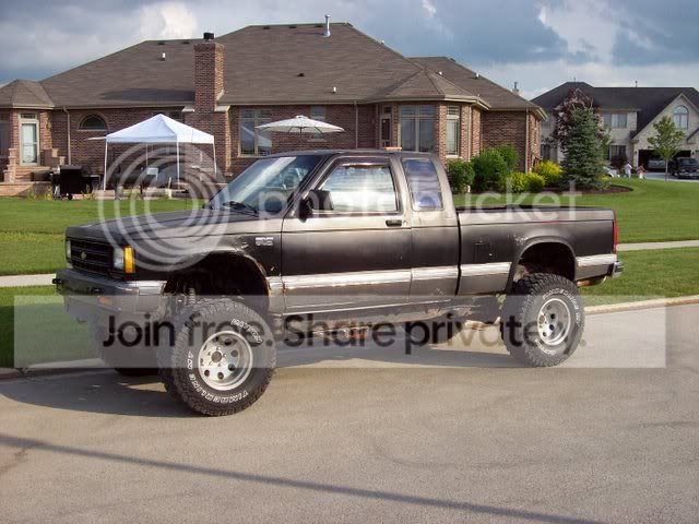

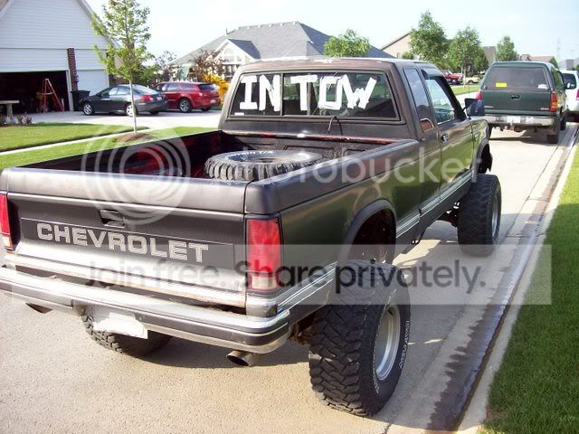

in tow lol, i guess thoese lights are still not working, sure did not take you long to replace that 93
Nice lookin project you got there! You gonna keep the TBI or throw a carb on it? Those front tires look kinda bald, time to pull out the groover!!
I think they are to far gone for the groover. I am gonna kepe the Tbi , and it is setup to run a 305 so it should do. It will be getting some pep later this year.
I think I am gonna get a set of High tec Retread's just to last till the winter.
Can't beat 80 a tire for a 33.

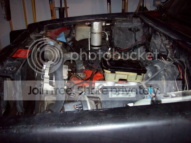

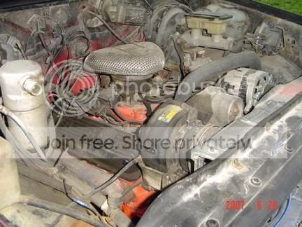

Well 305 is out It was a bear but it is out.
I couldn't find a wrench to fit the motor mount bolt's so that was a pain. 11/16 on one side 16mm on the other.
I started to remove anything that wasn't needed/wanted on the 350 , then finished yanking the 305. Wow I tell ya if you ever get an s10 with a V8 then you will see how tight they are. I had an about 1/4 of an inch with the motor coming out. Had to even wiggle the thing to get it out .
Look's Like I am gonna need a water pump , and Motor mount's. The one mount I couldn't get off so I started to come up on it and it tore. So I guess it was shot. Also need some hardware to fix what would be exaust leak's.
I will have picture's shortely.
