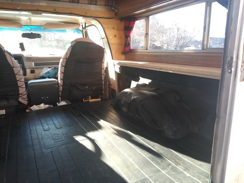

My truck has had it's bed mat since 1984. It was one of the first accessories my dad had gotten for my truck. And it's still in great shape.
Does the ones you speak of cover the cab area as well or just the bed area?
Here's mine minus the bench that is normally in there. I chopped at least 6" off the front end of the mat to make it fit and it still reaches a few inches past the cargo floor area.
