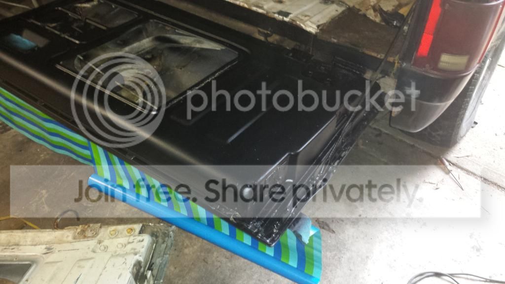

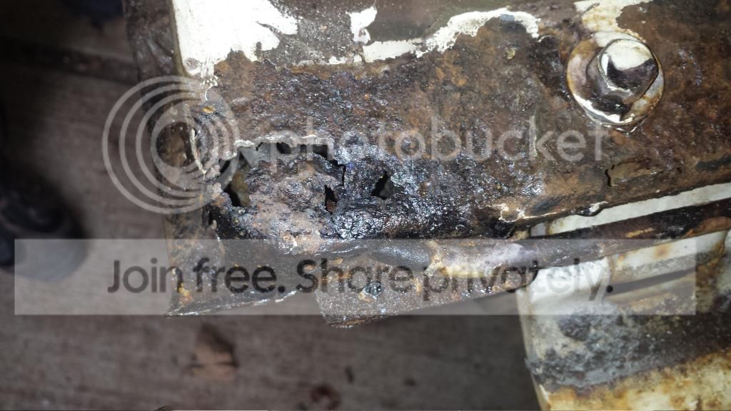

tailgate repairs

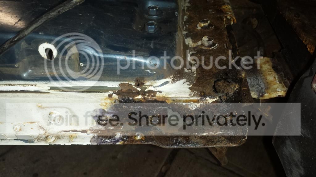

Did my best to clean up the ole tailgate. Patched some rusty areas. Wire wheeled the surface rust then sanded and bedlined it up.

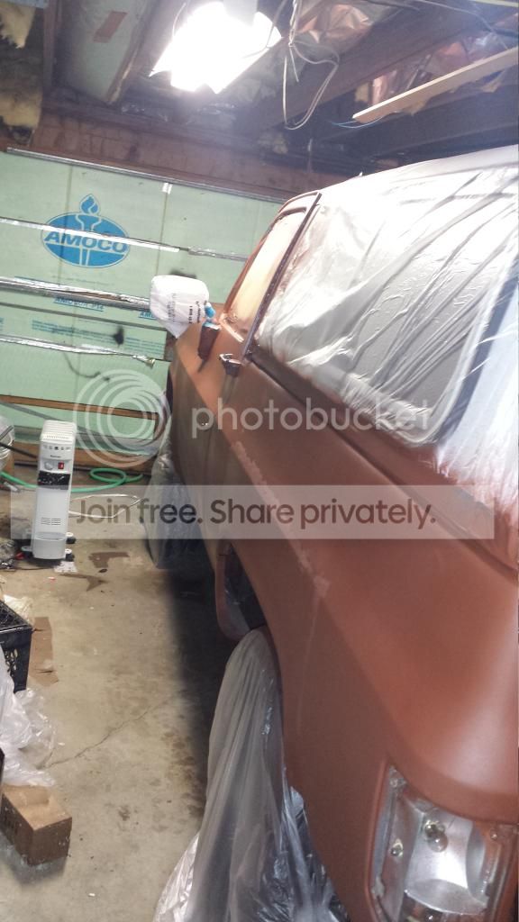

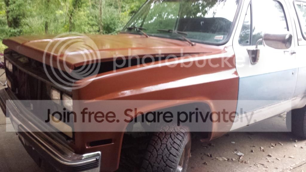

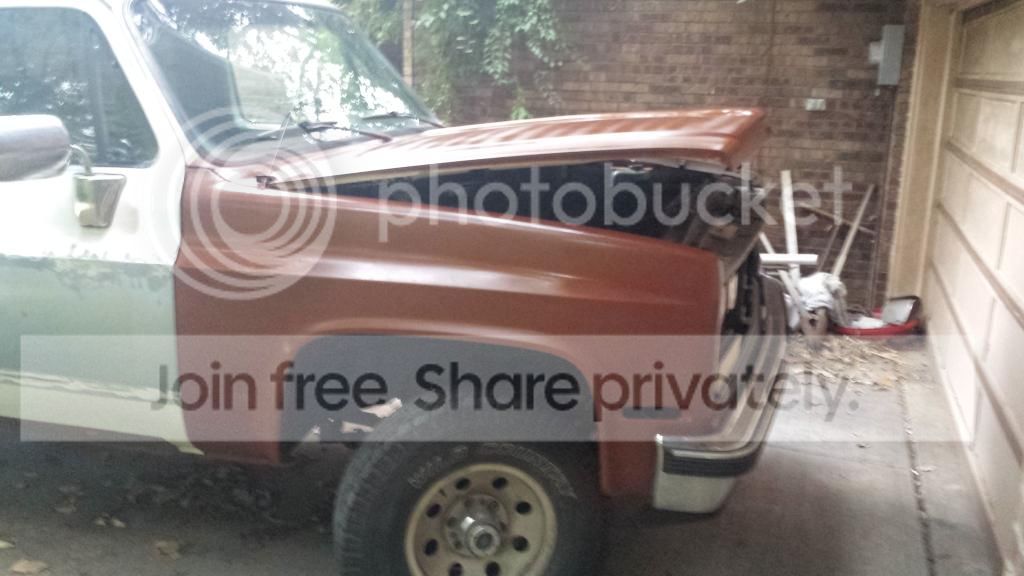

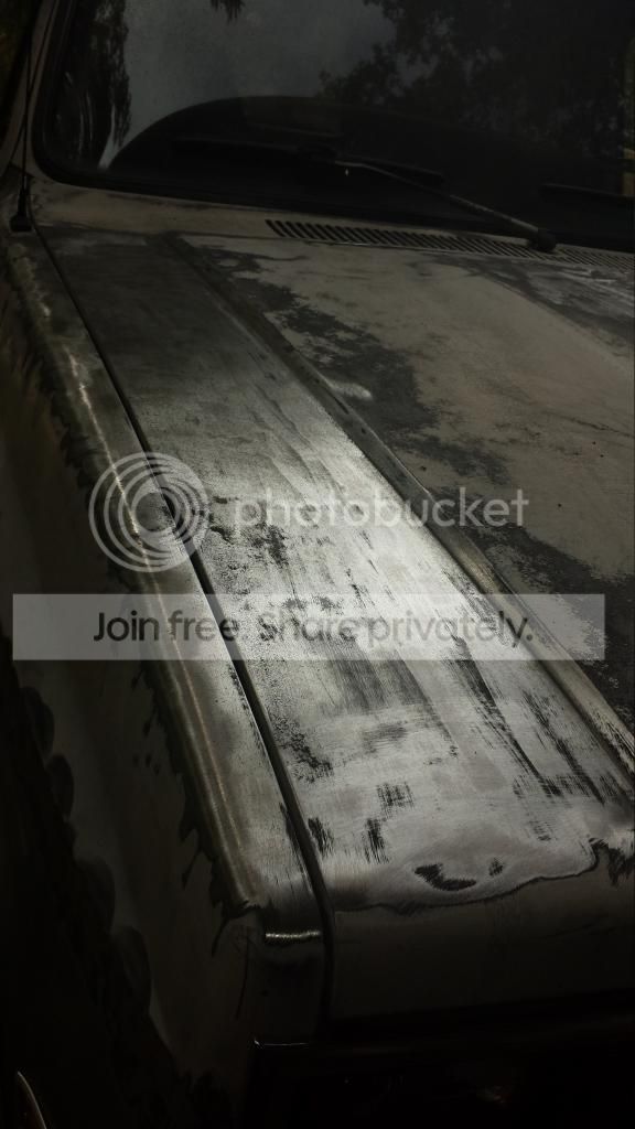

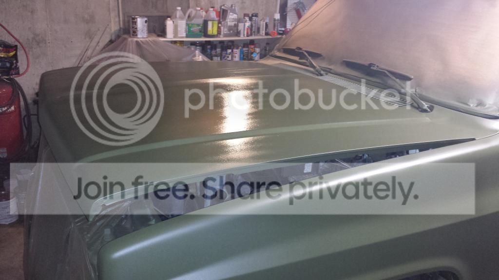

Wellon Wednesday I got started with the intention of gettin the rig primered, but it took me alot longer to strip it down to bare metal so I decided to just get the front clip primered. I got involved and only took one pic while I was strippin her down, but I got it done. Had to work Thursday and have plans tonight, may get some more done on sunday, But heres some shots of the progress. Primer still wet in the photos.

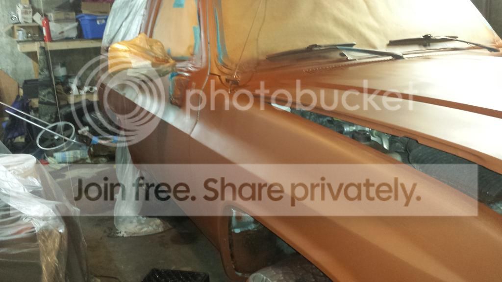

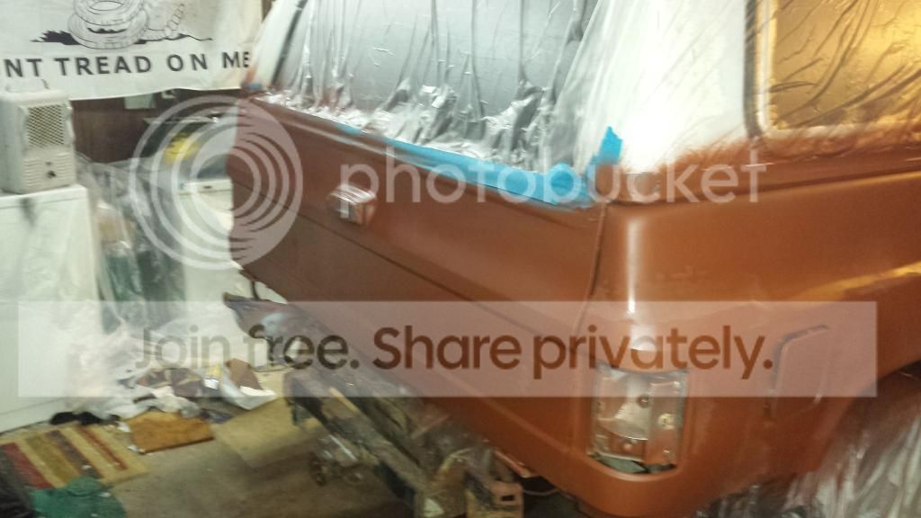

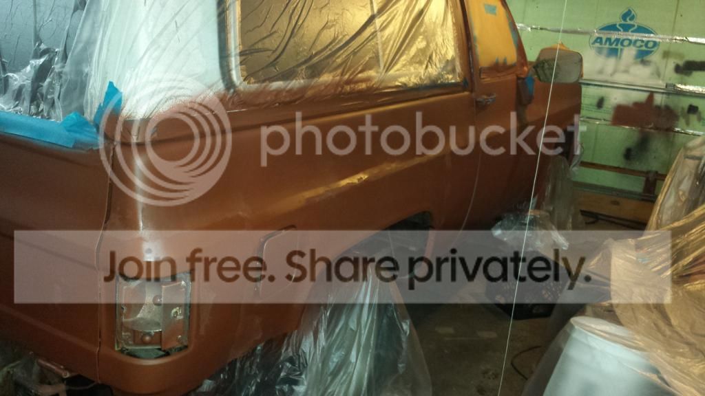

Primered!!! Lots and lots of sanding today, followed by some sanding, then after that I did some sanding....im remembering why I dont do this for a living, that and im not very good at body work :-D ...... rustoleum rusty metal primer, thinned 2:1 w Acetone sprayed w hvlp gun.
I thought about giving up and buying another one, I really did......but I kept pushing through and got to a point where I was like...well, ive come this far, no stopping now.....I didn't do the best on the body work so depending on how bad it looks after I spray the OD green tomorrow, it may just get camo'd out. Thanks for subscribing, there is much more to come, $$ slows me down at times though.

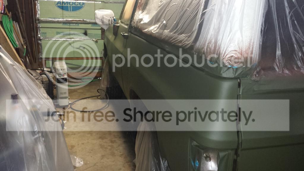

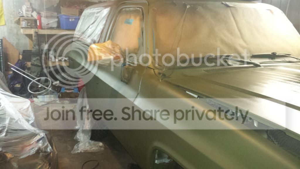

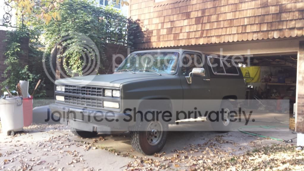

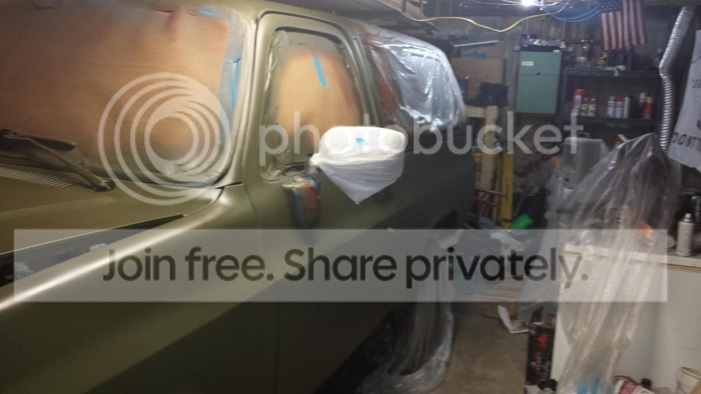

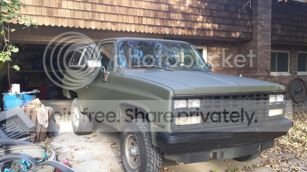

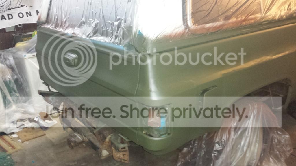

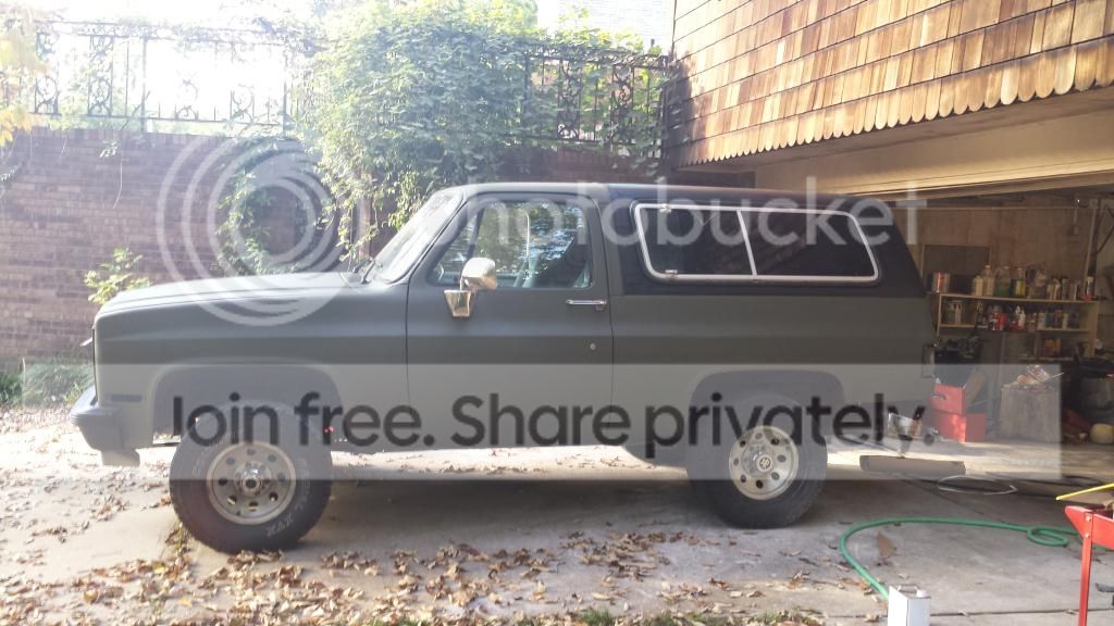

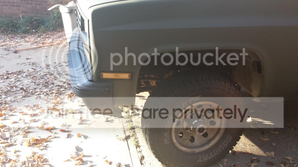

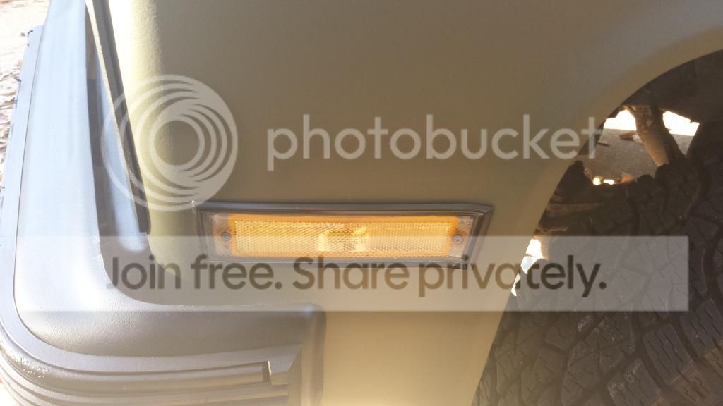

Painted it with two coats of rustoleum rusty metal primer, then 3 coats of rapco/gci olive drab.... I thinned the primer 2:1 w acetone, gci 4:1 with acetone.
Thanks fellas, its finally starting to look like something.
Thanks, I felt at times like I was never gonna get to paint this thing.... still a few things to do on the exterior, black out the mirrors, door handle, and key hole. Also going to mask off the aluminum frame around the rear windows and paint those black as well.
I might paint the wheels black to hold me over until I get another set of wheels and bigger tires with lift.
But once I get that stuff blacked out, which shouldn't be more than a day long project, im going to start working on the interior. Gotta get things buttoned up in there and get my new seats in. New window motors all around too.
