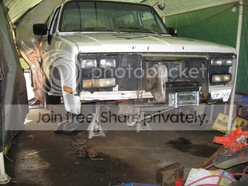

Front axle and suspension out

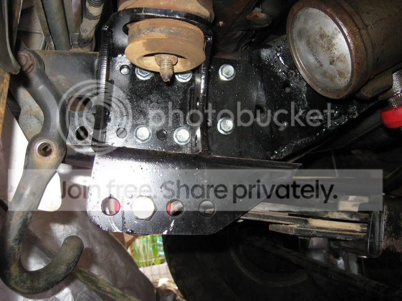

B52 brackets in after a billion rivits. also installed a new rear hanger.

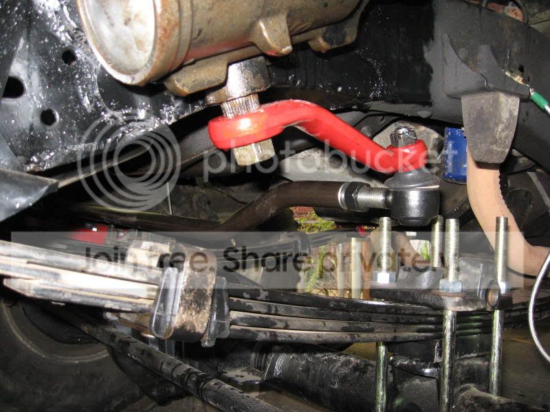

Front Axle and Crossover installed. frame cracks welded and repair kit welded in.

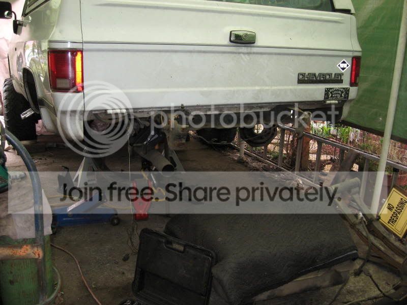

Rear Axle, suspension and gas tank out

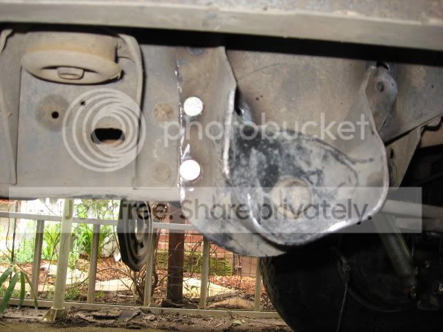

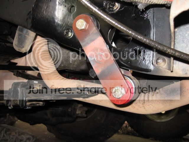

ORD shackle flip and Diy4x shackles with 63 inch springs installed i tried without moving the front hanger at all but shackle angle was horrible so i moved the front forward as far as it would go until it hit the body mounts and that fixed it.

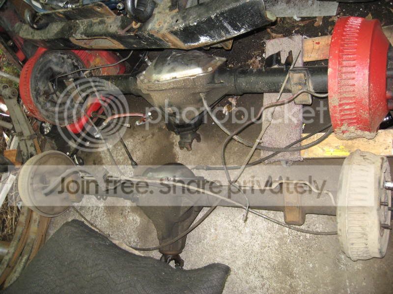

10 bolt vs. 14 Bolt
Rear axle on 2 inch blocks to level it out

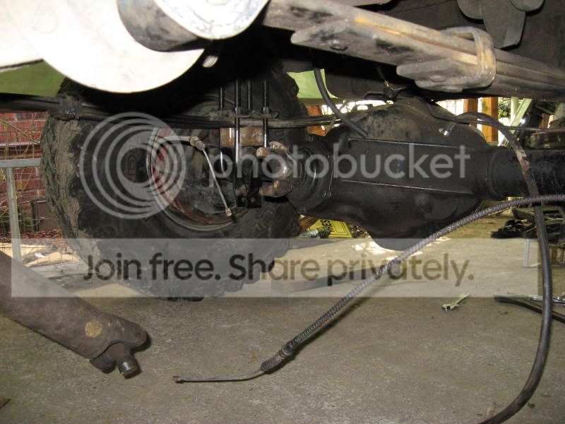

Thats how it sits right now. Wow it goes a lot quicker typing the work you did rather than doing it. i've been working on this for about 4 months now i believe. i currently have 4 rancho 9000's (15 inch travel) waiting to be installed and i hope to recieve my drivelines this week along with my short shaft kit.

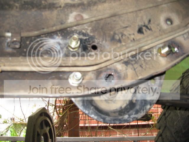

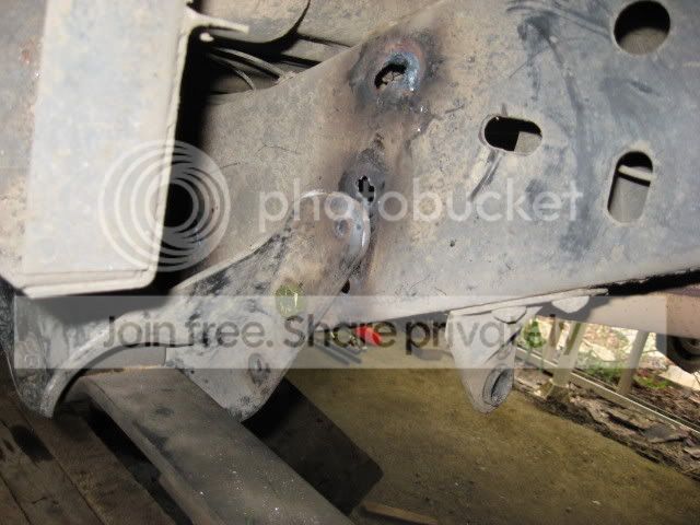

I had to cut about a quarter inch sliver off the edge so i could mount it flush with the body mount
Still looking for a right angle drill so i can put a 4th bolt in that upper hole

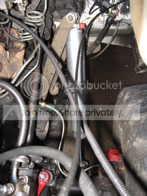

View from the inside

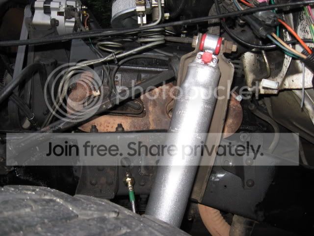

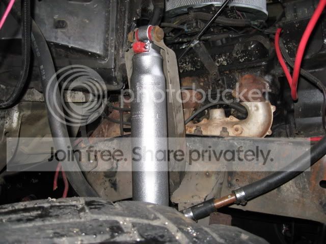

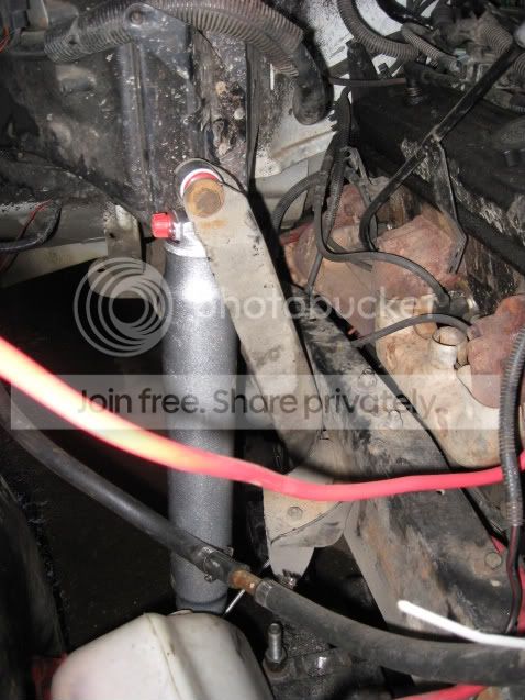

Well i got my shocks mounted. picked up some ford towers for $35.

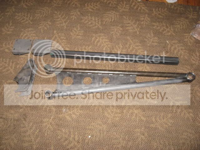

My drivelines should get here wednesday and i ordered a traction bar from ORD today. the plan is to go wheelin saturday but we'll see.

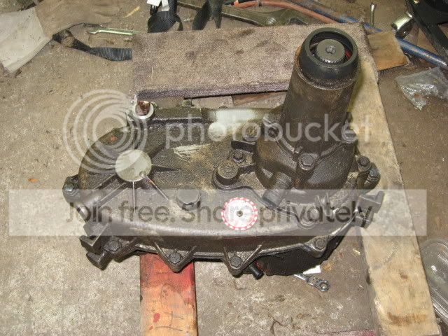

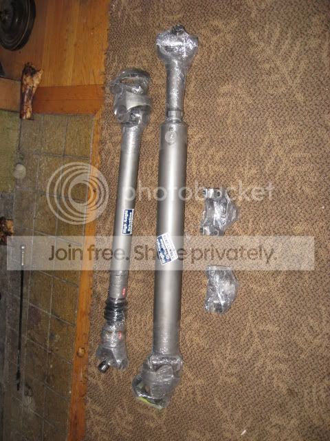

Finally i got my drivelines, shortshaft kit, and my traction bar in the mail.
ORD Tractin bar

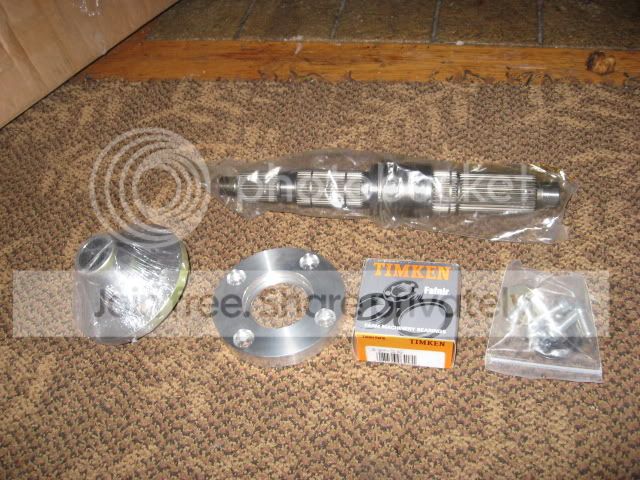

SYE KIT

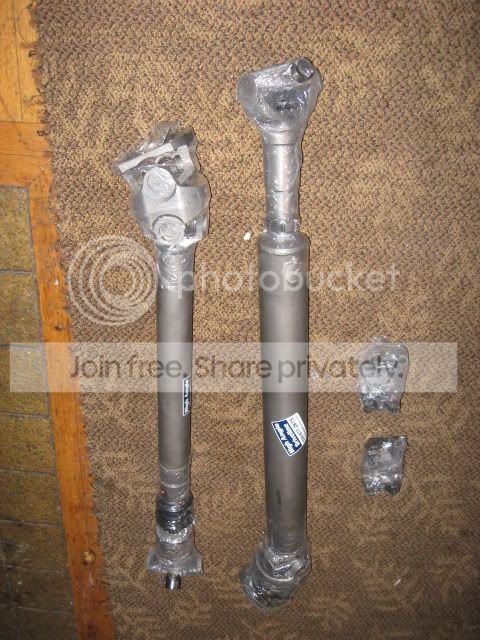

Front and Rear 1410 High Angle Driveshafts $$$

It is kinda hard to tell from the pics, on the front hanger of the rear spring did you just pivot the hanger around the upper forward rivet, or did you have to re-drill that hole too?
Hey CC,
Are those 52 inch spring on the front end? The reason I ask is I didn't really like the shackle angle with those 6 inch shackles.
