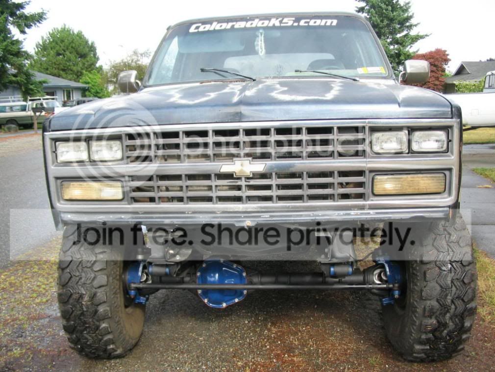

Well, here's what it looks like with a D60 and worn out CUCV tires. My wheels get in tomorrow so I can mount the tires and get them on the front. I'm also waiting on the drop pitman arm and my hydro assist kit from WTO.
What do you guys think about the darker blue color on the diff cover and the shackle? The steering arm is also that color but you can't really see it. I decided to use a darker blue cause I think a light blue accent could look a little queer if you know what I mean.
Looks good. You work to fast for me though...........

Progress at last. I was running out of stuff to tinker with while I waited for parts. I finally got everything in from ORD for the D60 cross over steering kit and the steering box brace. Also, I got the Stage 2 kit in from West Texas Offroad. I'm just not the type to take pictures as I work so there aren't any of those. Everything bolted up pretty nicely. I also replaced the springs and bushings in the kingpins. I kept my master cylinder and there seems to be a lot of petal travel but it stops really well. (I drove it down the road a little with the old axle in the rear and the new front axle).
I was worried that the drage link was going to contact my crossover exhaust pipe but no problem there. It does just barely touch at one point in the arc but I think a bottle jack while it pipe is really hot will help relocate it a couple millimeters.
I didn't hook up the ram yet. I'm waiting on a welder that my father-in-law is sending me. When I mocked it up though, the weld-on mounting tabs seem a little too big for the stock tie rod. So...I may be upgrading to a Rock Rod. And while I'm doing that, I may as well to high-steer. If it ain't one thing, its another.
Also, you can see the HMMWV radials mounted on the wagon wheels look pretty bitch'n too. I think they will make a great "all terrain" tire.
