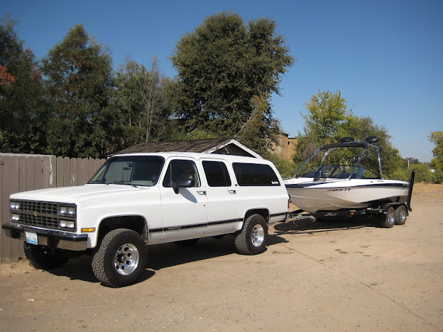

Here is it, the day i drove it home:
attachment.php
Here is what it looks like now:

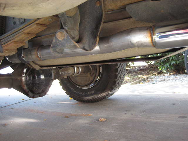

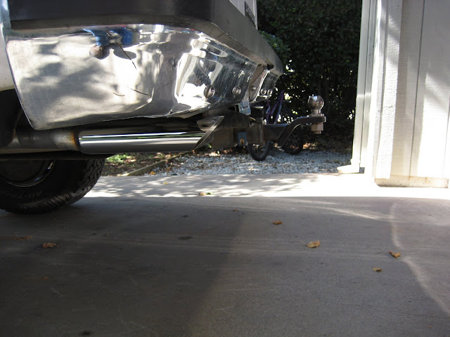

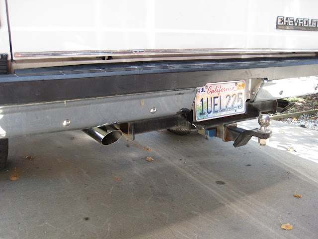

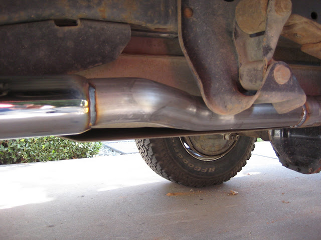

Ok, Exhaust Installed!
3" Cat to 3" tube to Flowmaster 50 series, to dual 2.5's, to 3" tips.
Wish i had known what size tips were on my blazer. If i was to do it again, i think i would go 3.5's on such a large truck. Oh well.
Sounds good, had a good tone to it, but pretty quiet overall. Wish it was louder, but didn't' want the deeper 40 series tone. Cost me $525+ tax, 200 being the converter, and 325 for muffler/exhaust/tips .
Got it done at Muffler Express on West Capitol Ave. in West Sacramento. mufflerexpress.biz
Pete did the work. Real clean job, quick and easy. Even tucked the exhaust behind the shackle hangers one each side, so if i decide to shackle flip it at some point.....i won't have to mod the exhaust.

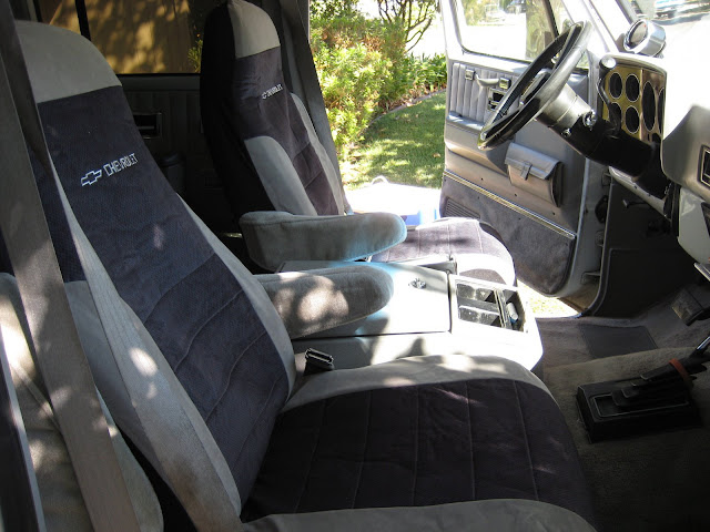

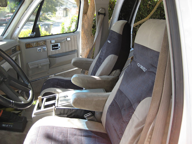

Ok, so my ebay chevy seat covers have sat around for a couple weeks. Don't really like the material, or the fact i had to cut for armrests, but they were only like $40. Ended up forcing myself to install them, cause the neoprene ones i had were toast.
In the above pic, you can see where i botched my first armrest hole, but at least its only seen from the drivers side.
They look ok, but really want some waterproof ones. Anyways, they will do for a while!

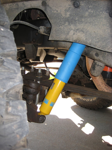

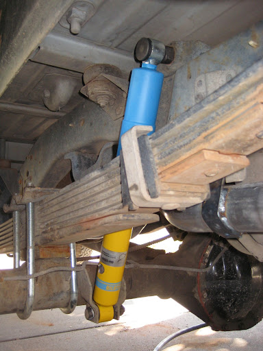

A present came in the mail from my friends at Summit

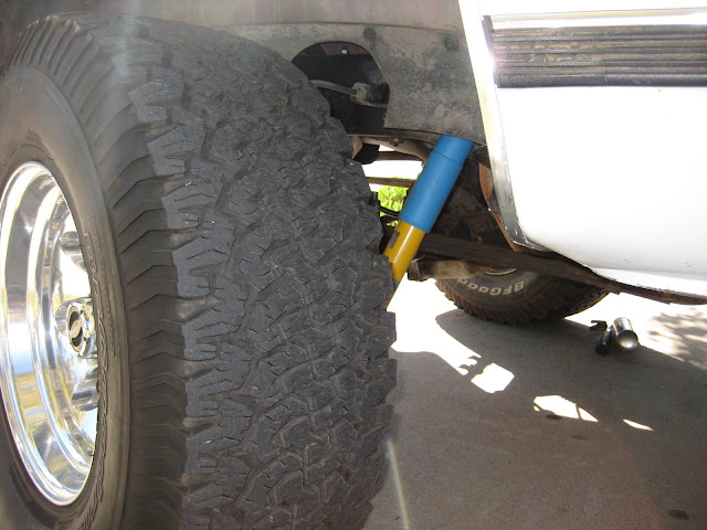

VERY impressed with these right out of the box! The germans sure got this boot idea right. Rather than a goofy looking boot, its more of a blue silicon sleeve, that protects the shaft w/o keeping mud and crap inside. The rear shocks also came with new mounting stud deals....i thought i would have to reuse the old ones.
From my last install, i learned to not use the long bushing they give you, the shock will slide back and forth and wear out its own bushing. Instead, i pushed the sleeve to one side, cut it short, and used the factory shock spacer.
The ride different is awesome. I only drove it a mile or so, but i was bouncing all over the road when i hit bumps, and these absorb so much better! Impressed so far, and get to hook up the boat and put some miles on them tomorrow, so stay tuned for more feedback.
Overall, im stoked on them!

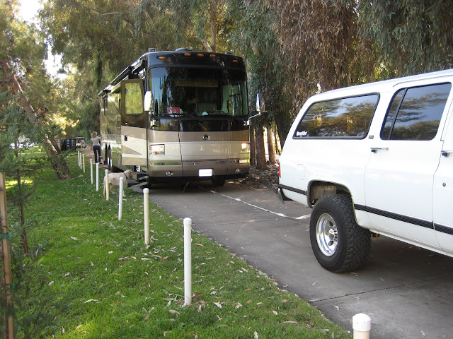

Went out to Collegiate Waterski Regionals, and someone got a 55,000lb RV/Bus stuck in the mud/wet grass. By stuck, i mean tires spinning, not like buried.
I had the largest truck around, and there was pavement close, as i knew i had no chance pulling from the mud.
Hooked up to the beast, dropped it in 4 lo, locked the hubs, and pulled him out. Started from a wierd angle, and dragged all 4 sideways, but then repositioned, and pulled him out without much trouble. Pretty surprised it worked. Anyways, ordered a real tow strap after trying to unloop all my loops.

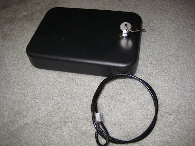

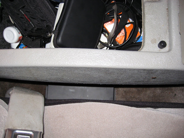

Lockboxes
Ok, don't have the lockboxes installed yet, but here they are.

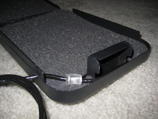

Tuffy:
I still can't believe how strong this sucker is. You can see the couple small holes in the top, that is the trade off for buying off of ebay
Grade 8 hardware included, along with long (10 tumbler? ) keys.

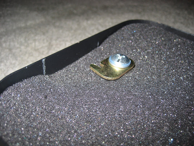

1/8" Latch Plate
1/8" latch plates to put the locking arm in double shear (IIRC).
Overall, super impressed with the tuffy box. Made in the good ol USA.

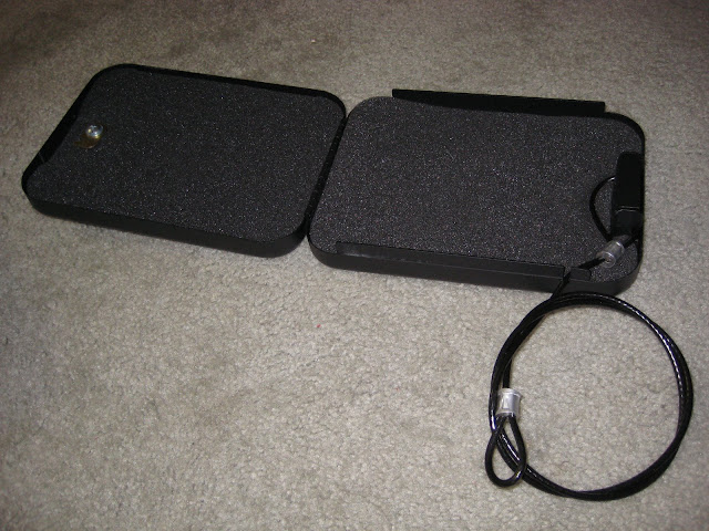

Ok, on to the medium gun locker.
http://cgi.ebay.com/ws/eBayISAPI.dll?ViewItem&item=160367387751&ssPageName=STRK:MEWNX:IT
Decent product for the money. Not nearly as strong as the tuffy, but the way its designed, and the location i will have it mounted will make it enough of a deterrent. Probably fairly easy to pry open. Made in china, still smells like chinese ppl (No offense to anyone here).
I considered exchanging for the larger one, but its only 3/4" larger one way, and 1/2" another way, and would cost me like $30 more after shipping.
Part of me wants to order another Tuffy and return this one, but my radar detector doesn't fit in the Tuffy. At all. So haven't fully decided. Want to do it right, once, but also haven't found that perfect solution. Tuffy doesn't' have an in between size that i need.
My radar detector fits in the gun box, and allows me to put some larger stuff in there, so i'll probably hang onto that one. Kinda want to take advantage of this tuffy deal on ebay though. Anyways, just rambling at this point. Enjoy the pics!
EDIT: God, days at home hurt my bank account. I ordered a second tuffy box, and am going to cut the side out to fit my radar detector. I also ordered a matching lock cylinder and keys from tuffy. Cool to think i'll have 2 matching tuffy's, keyed alike, when they are normally about $100 retail. Both will get mounted in the center console. Probably going to hang onto the other box, and use the cable to secure it to the seat rail. That way, i can remove it and use it in the bmw when needed.

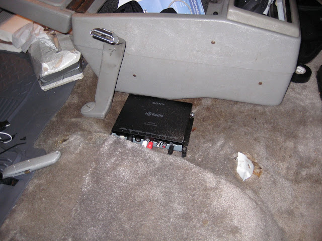

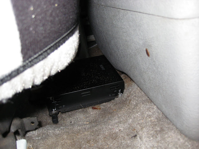

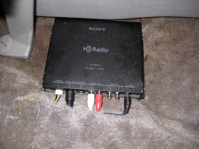

Next Package, HD Radio! First of all, i have always liked my sony head units, but some of the add on's suck . The Ipod controller was absolute garbage. So i was a little skeptical. Especially after i realized i disconnect the antenna from the head unit, so i was worried my old radio tuner wouldn't' work.
First, many mfg's have the HD tuner built in, so i was disappointed how large a unit was required for the add on. I originally was thinking under the dash somewhere, but when instructions recommended under the seat, i got to thinking. There wasn't much room under either seat in the burb, and cables weren't long enough for farther away. Then i stumbled on the somewhat flat spot just inboard under the front seats. Between teh seat rails and the console. Since i put a bunch of crap next to the drivers seat, i mounted it on the passenger side. Easier to explain in pics. Excuse the stained carpet down there....gross.
Overall, happy with this mounting location. I ran signal, etc wires forward a little, over the hump in front of the console, then up the floor to where the stereo was in the dash, along with some other signal wires i had run previously. For power, i ran the wires under the seat, then forward under the carpet, and then up in the dash. Basically trying to keep power away from signal. The signal, unilink, and antenna extension were just BARELY long enough, although the power wires were easy to extend. Now, knowing the cable length, i would mount in the same place on the drivers side. Yes, i roughed in the cables before i mounted everything, and knew i was close, but thought i would be ok.
When i got it all hooked up, i was pleasantly surprised. The old 'Tuner" mode no longer works, but the HD source tuner works just like the regular one . Tunes stations quick, just like the regular tuner. But after you are on a station for a few seconds, if there is an HD signal, you hear a brief skip (sometimes), and the display will show HD. If it shows HD1, it means there is more than one HD broadcast on that channel, and when you skip to the next station, it goes to HD2, or HD3, and so on. Works pretty good. You definitely hear the quality increase, especially with a couple amps and a sub, etc, when it switches to HD. Haven't taken it for a drive, just listened to it quickly in the driveway. So we'll see how i like it in a few days.
