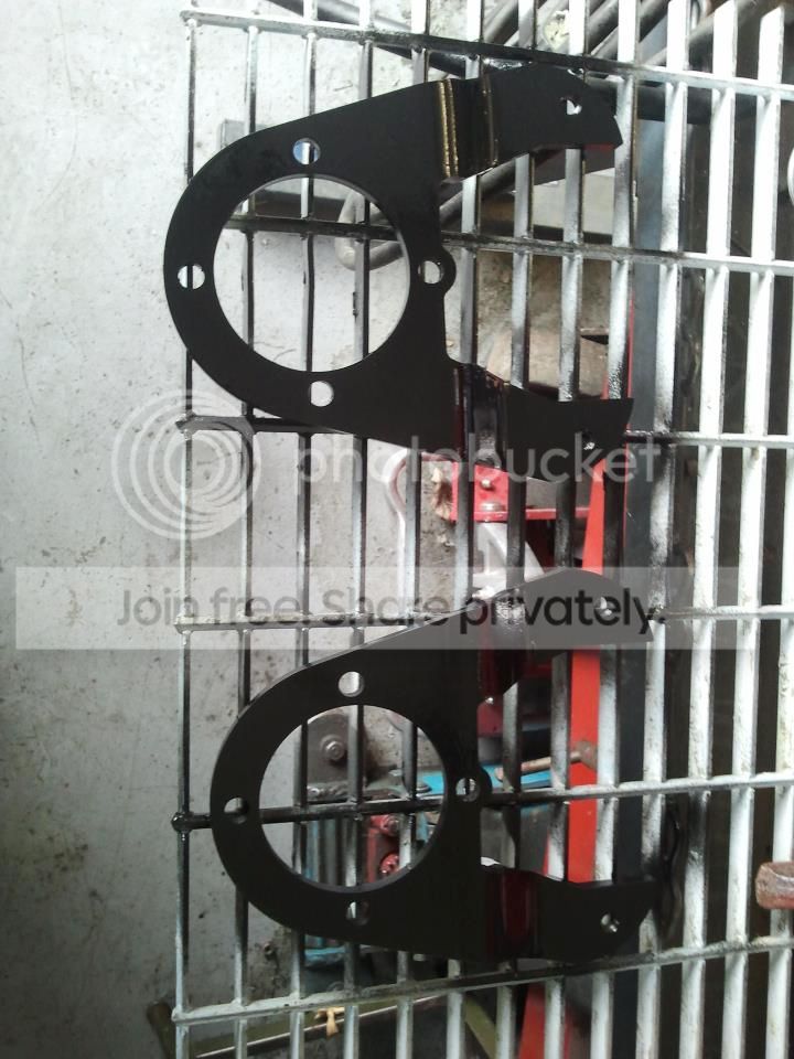

Now its time to put it back together. I used RuffStuff 14BFF disc brackets hardware included:
I reused the original lock washers because the kit did not come with any, but here is the assembled product, the bracket should face out with the bent portion out. the placement of the caliper mount should mount the caliper at the 2 O'clock position.
