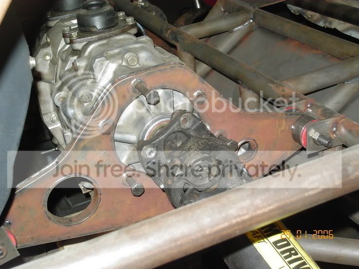

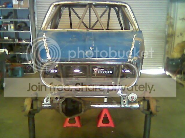

    Even though its not a chevy. Here are some pics of the toyota.
    [​IMG]
    [​IMG]
    the case mount
    [​IMG]
    [​IMG]

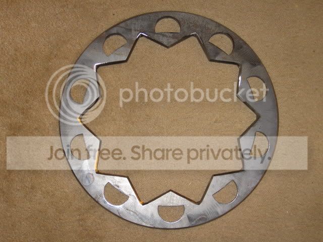

    I will be running 20" Stazworks wheels. My buddy had me make some rings that weld on the outside lip to help stop the rim from bending.here are the rings. Mine will be bigger though. they are .375 HR and I chamfered them all around to help break it up a bit.[​IMG]

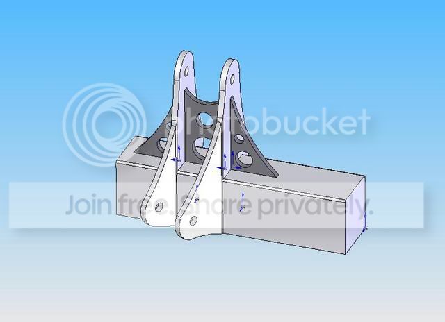

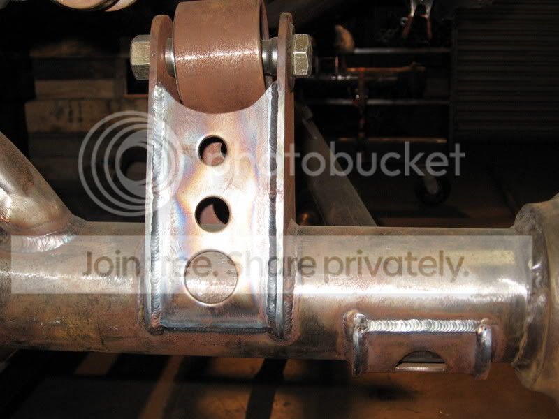

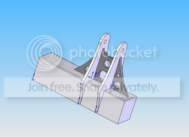

    well i just finished designing my 4 link brackets for my axles. now i will move on to my frame skidplate/lower mounts.they will be out of .375 HR[​IMG]
    yea they are like bluetorch brackets but without the gay spiderwebs:D
    heres a front pic
    [​IMG]

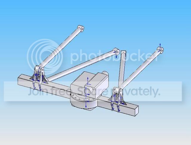

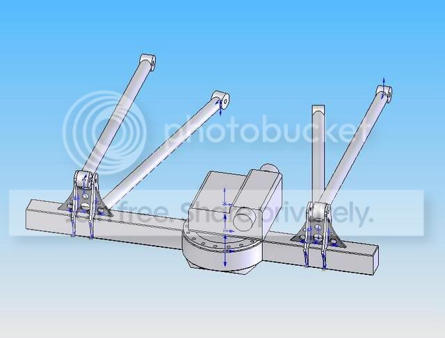

    Here is the drawing for the 4link. the lowers will not be this close. i need to take some degree out of the brackets. other then that im happy with it.I never use to draw stuff until recently. it takes a little more time and might be annoying,BUT it will save me time and material when i start building my suspension.
    [​IMG]

    well fixed my link brackets. Now off to the shop to clean up the axles. will post pics later of progress. should have the brackets and the diff skids burned out by monday.:D [​IMG]

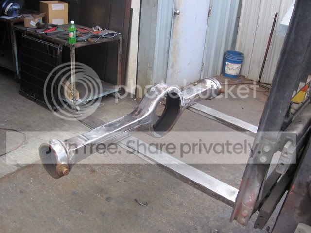

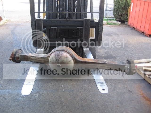

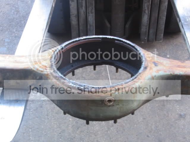

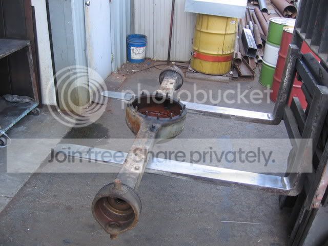

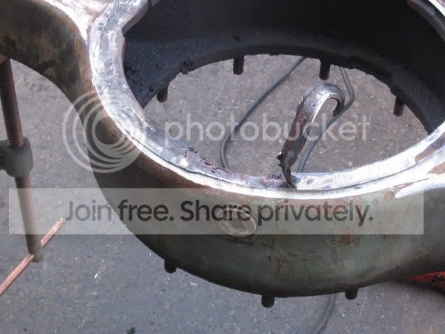

    Alright well I just finished cutting the bottoms off the rocks'. what I found to be the easiest,was cut the dome off with a torch, then grind the weld with a hard wheel, and use a air hammer to get the base off. Its probly excessive but im anal about stuff. Enough chat, heres the pics-
    Before-[​IMG]
    [​IMG]
    After-[​IMG]
    I cut the dome off first with oxy-acy-[​IMG]
    Then came through with my air hammer, cleaned up pretty good.[​IMG]

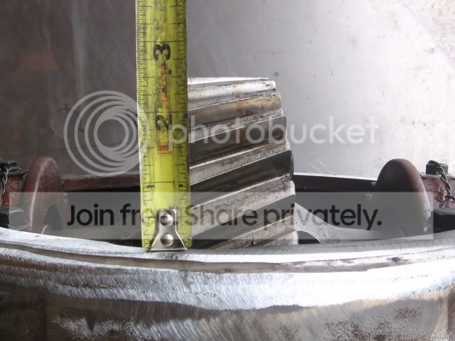

    Now I am going to draw up my diff covers. Now for those of you who want to do this Im going to make the out side of the cover at 3". This should clear the ring gear just fine.[​IMG]
    Thats all for now until I get the covers drawn up. Tomarrow I should have my 4 link brackets and the covers burned out. so stay tuned!
