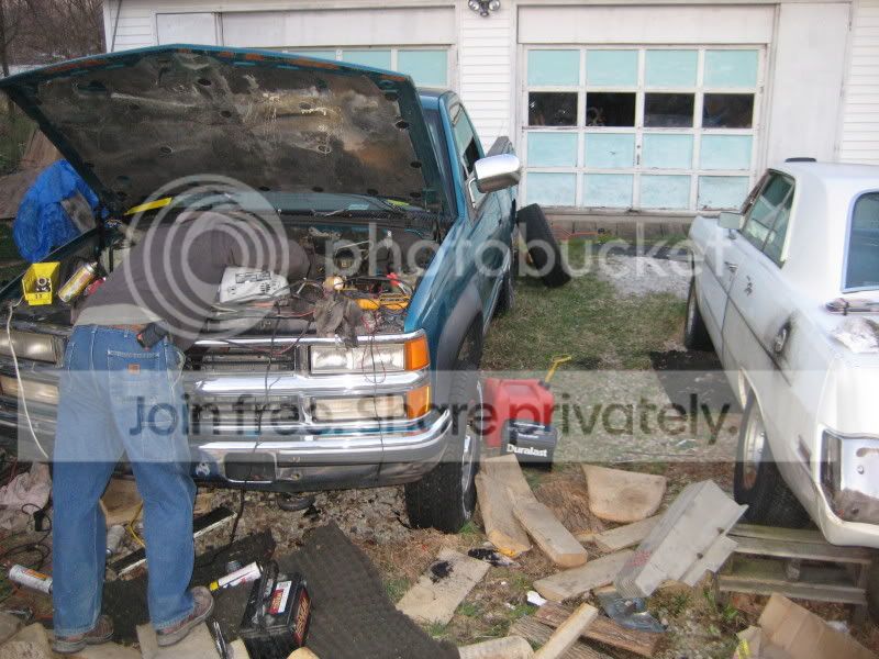

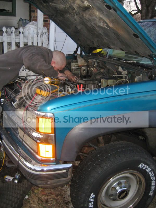

The guy who parked it (not my friend Jason) was driving it one day and it died on him. He was too lazy to try and fix it so it just sat. If you saw this guy's house you would understand. The whole property looks like a junkyard. We have been working on it in the dude's driveway.
Here are some pictures. See that '70 Dart Swinger on the right? In the front window it has passes to an all-mopar car show back in 2002, when it was probably show-worthy. Now it's been sitting outside so long it's fast-becoming a piece of junk. The interior is in near-perfect shape. Just taking a walk around this guy's property will make you understand that he values nothing.

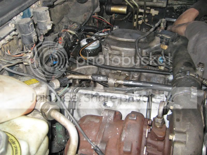

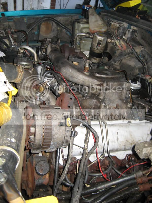

Since the problem that left it parked to begin with has not been addressed I'd think about common things like the PMD to start off with. They often failed quick like that since they were mounted on the side of the IP and heat kills them.
That would be that thing in the middle of the intake manifold with the lines coming out of it, right?
The injector pump is in the center, front of the motor with all the fuel lines coming out going to the injectors. The PMD is the electronic module mounted on the side of that.
I had a friend drop off almost the exact same truck here. He bought it for $800 with the intake and a bunch of other stuff removed. The owner had problems and began trying to replace the injection pump...then gave up, bought something new and sold the truck cheap. I re-assembled everything and added a new PMD with heat sink and remotely mounted it.
Got the truck running, and out of my yard.
Look at a new PMD, and unsure you have good cranking speed. Without good cranking speed it will start way harder than it should. It's not like a gasser than can catch with a half a rotation and a fortunate spark with a 3/4 dead battery.
