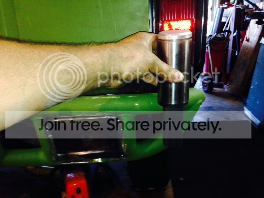

I did make a little progress on the hidden tube back bumper. At least I managed to mount the skin and go through a million measurements, making sure it will work for everything else that I have going on.

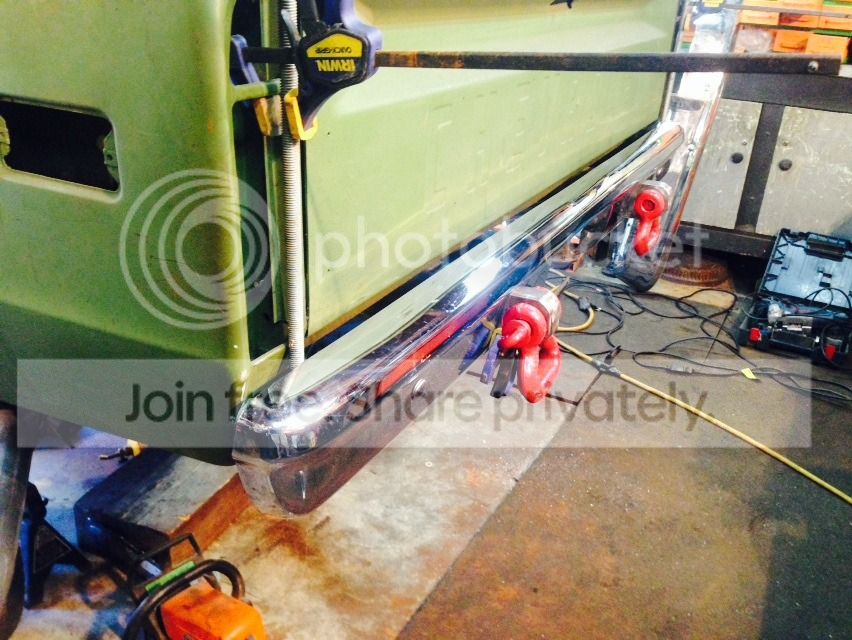

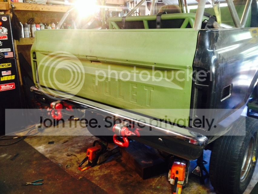

What I started with.

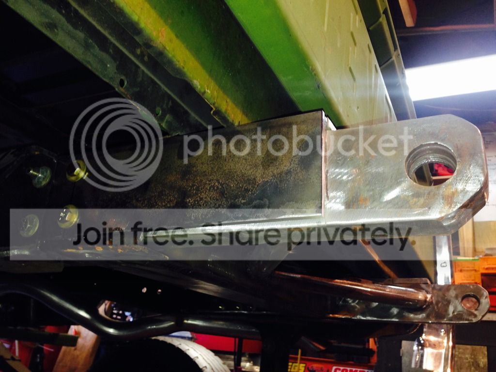

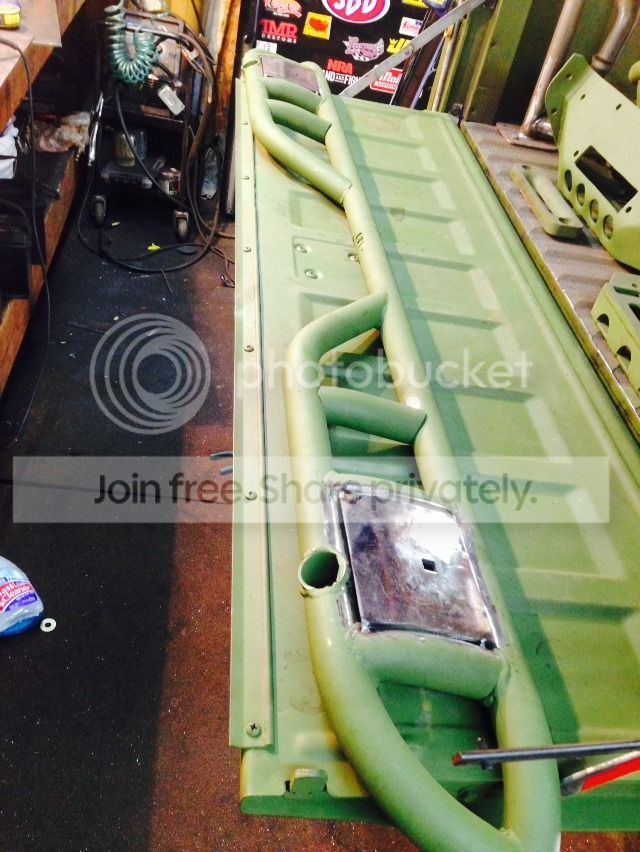

I built plates for the sides and was able to mount the rear most holes. That area was only two plates of 1/4" and the frame. I figured the rest of the bolts can happen when I take it apart again. It's 2" worth of steel back there now. Not very fun to drill through in that position.
Mocked up with clamps and spacers.

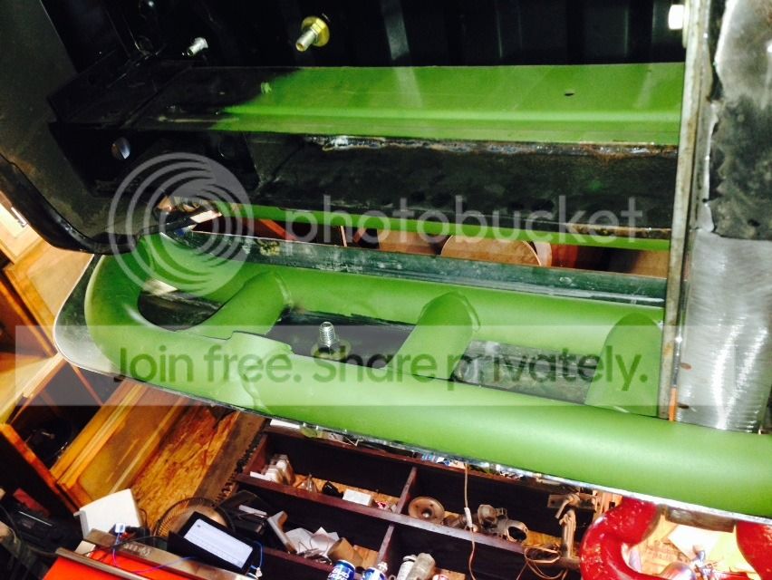

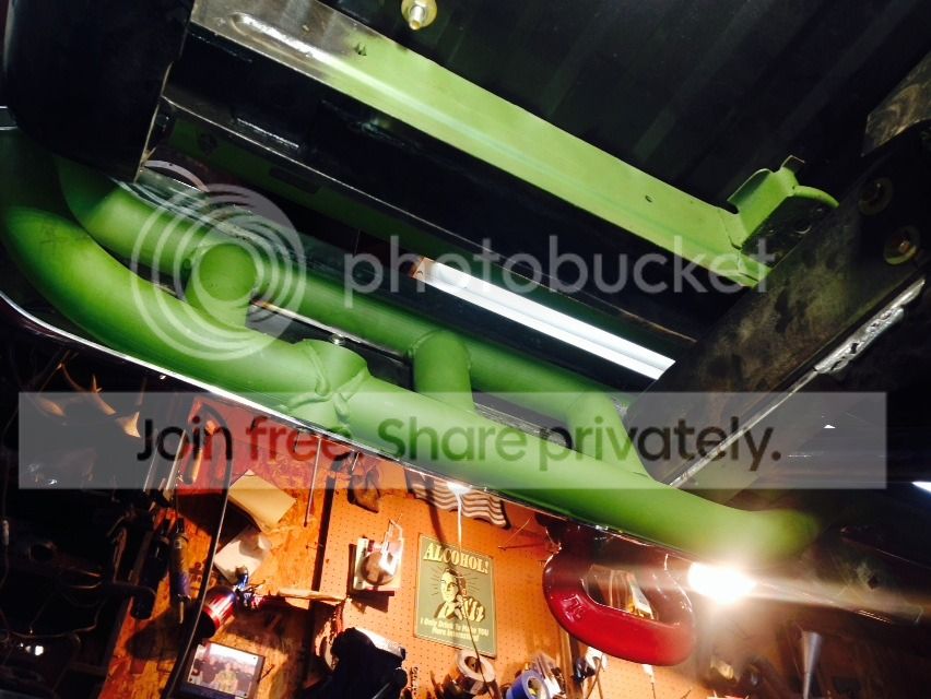

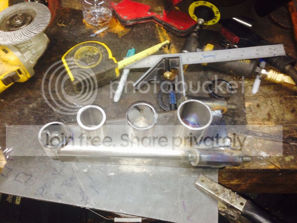

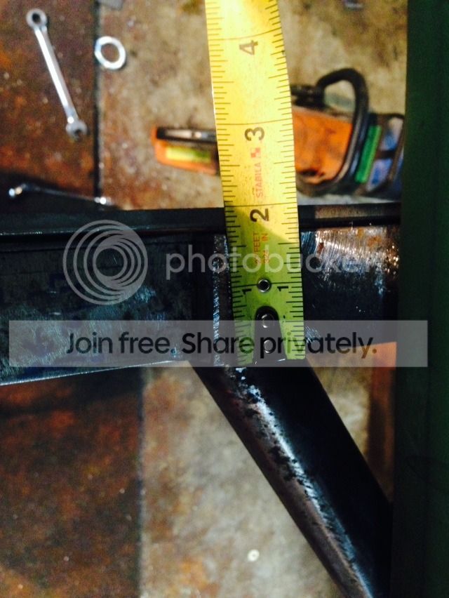

Here is the area that I need to figure out some. The tubes, I think, are going to come off the tube bumper at a "Y", then shoot back to the frame. The bumper is wide and I only have 3.75 worth of frame width to land it on. I don't want to just run single tubes from the center (up and down) of the bumper. I'd like to split it somehow so I have support at the top and bottom.

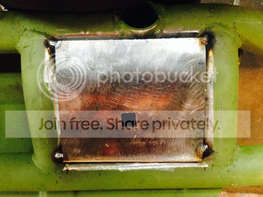

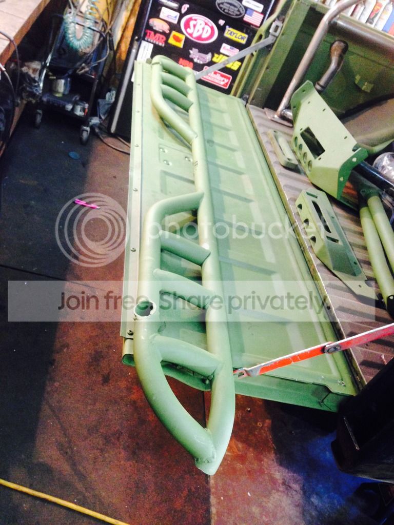

And started to make some skin mounting plates.

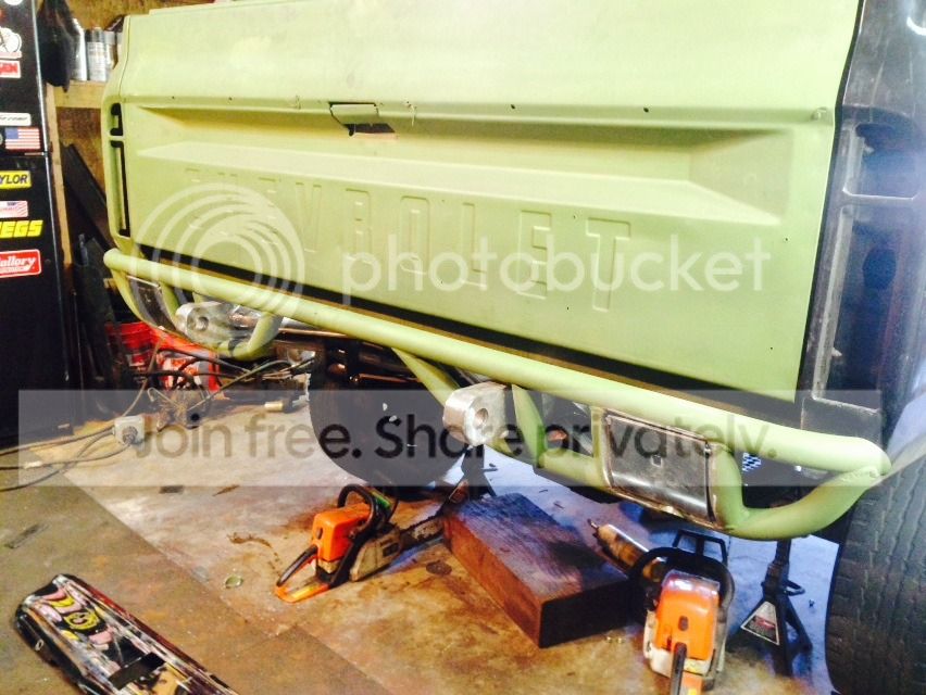

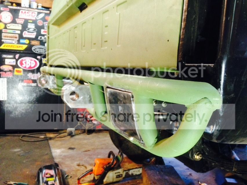

In the end, it came out looking like this.
Been waiting for this look for about three years. Glad it finally worked out.
Everything still needs a lot of love still, but I think that it's all going to work out nice.
