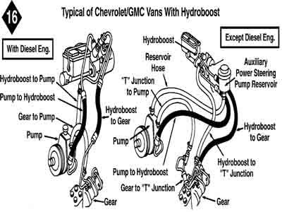

Anybody have a diagram of lines for hydroboost brakes, hydroboost steering , pump with an external resi?
Interesting. I don't think I've ever seen the teed return line setup before and I've had hydroboost for both gas and diesel. I've always run the returns from the hydroboost and gear box separately to the reservoir.
I think that is for running it with a pump with only 1 return line. At one point I was working towards that, but decided to replace the pump, so grabbed one with 2 returns.
