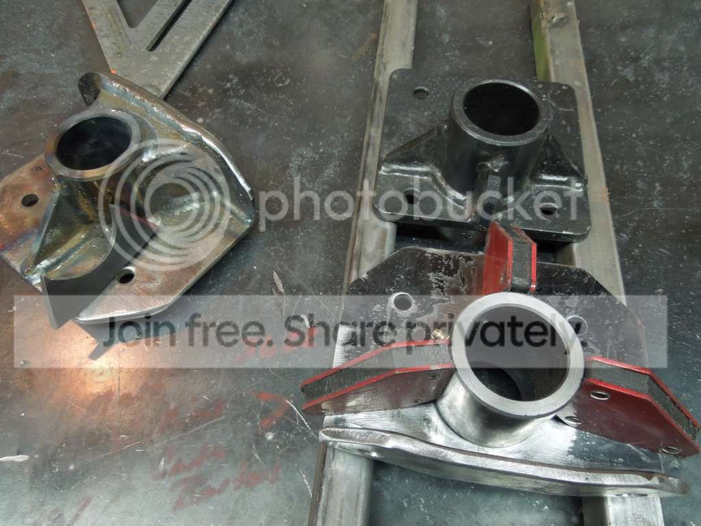

Front Upper Shackle Hanger.
I had to make some that fit a 2.5" spring for clearance. The ones that came on our rigs where designed for the 3" spring.
In this pics you can see the two that I made and the top one is for 73+. They just didn't work out.
Something like this..
I would have needed to get some super wide bushings in the back to make the shackles parallel to each other. I have ones on the front of the springs to make up the width for that hanger.
gotcha. thanks for the explanation. I remember looking at when you built those but it didn't register what you did. Nice work!

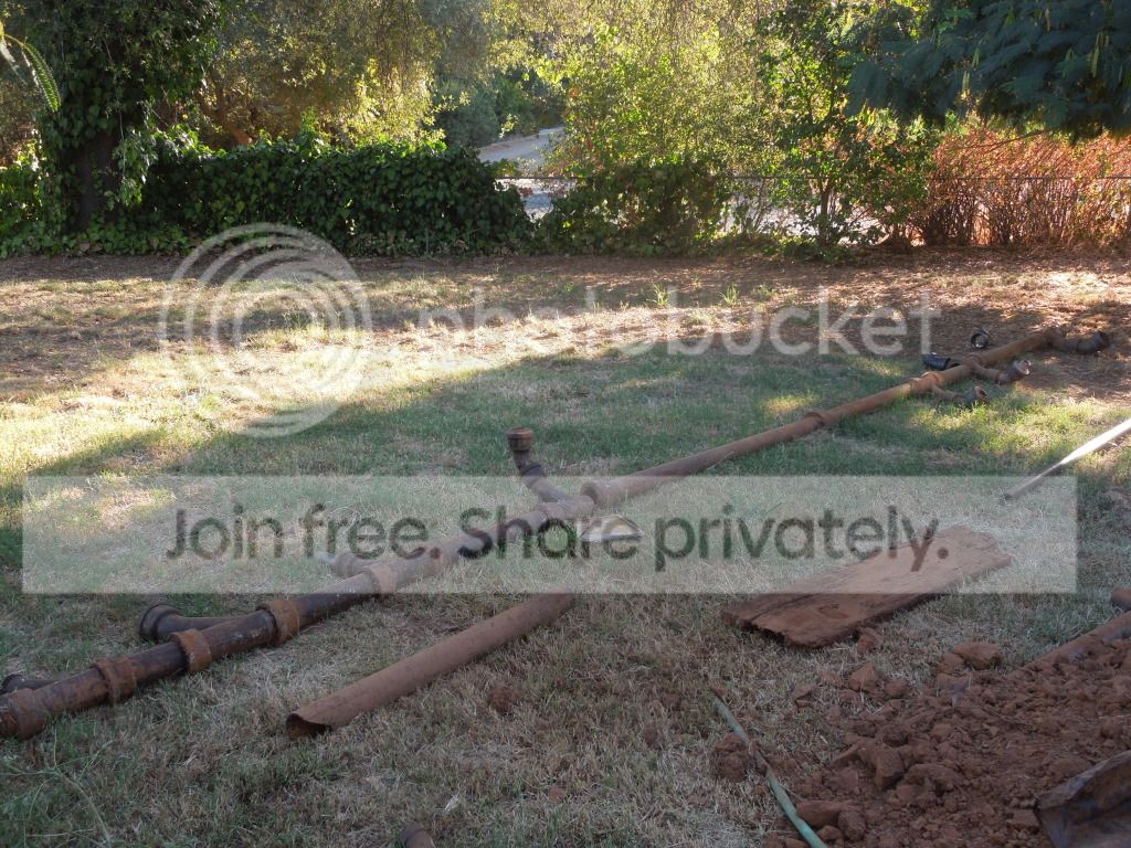

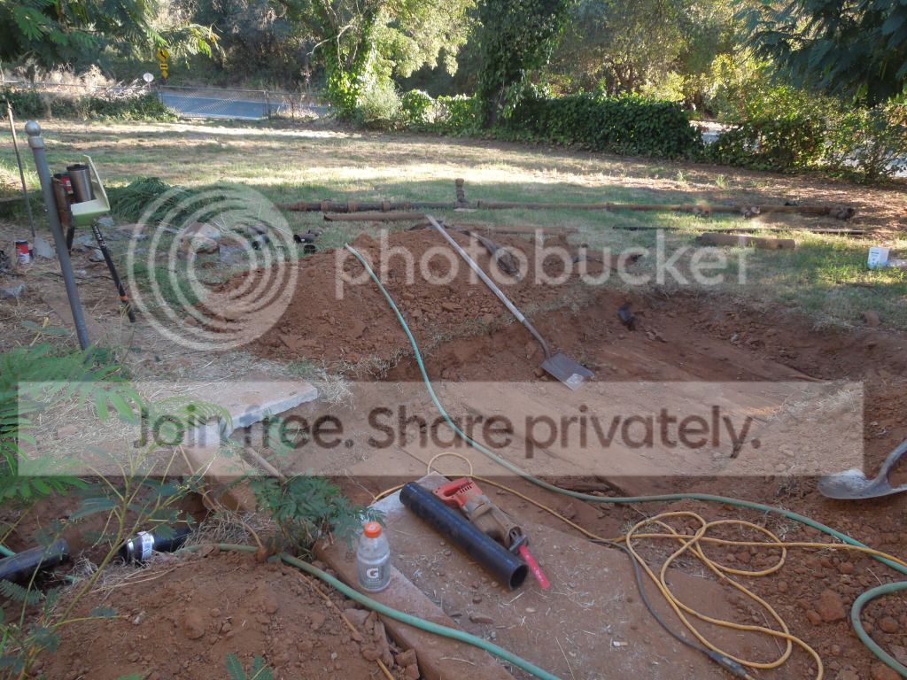

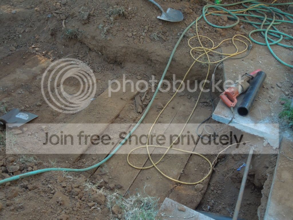

Well, absolutely no progress in the garage this weekend. :frown1: My toilets were acting up this past week, so I had to make a decision, engine cage, or working toilets. :surepal:
After my wife helped me make my decision, :screwy: :whistle:I headed to Home Depot and then to the back yard. Cut out all of the old cast and ran new ABS throughout the entire home. At that time, I had to start digging, and what did I find, a damn old redwood septic tank...Joy..
After getting that pumped out and coming up with a plan to reinforce that tank so I get a couple more years, I drank beer and ended my weekend.

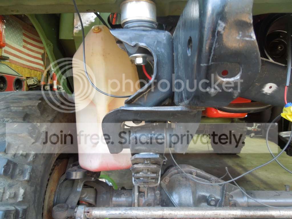

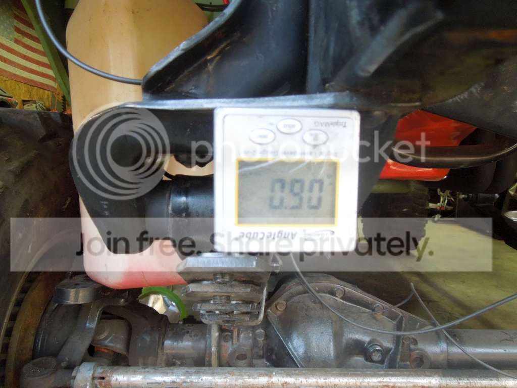

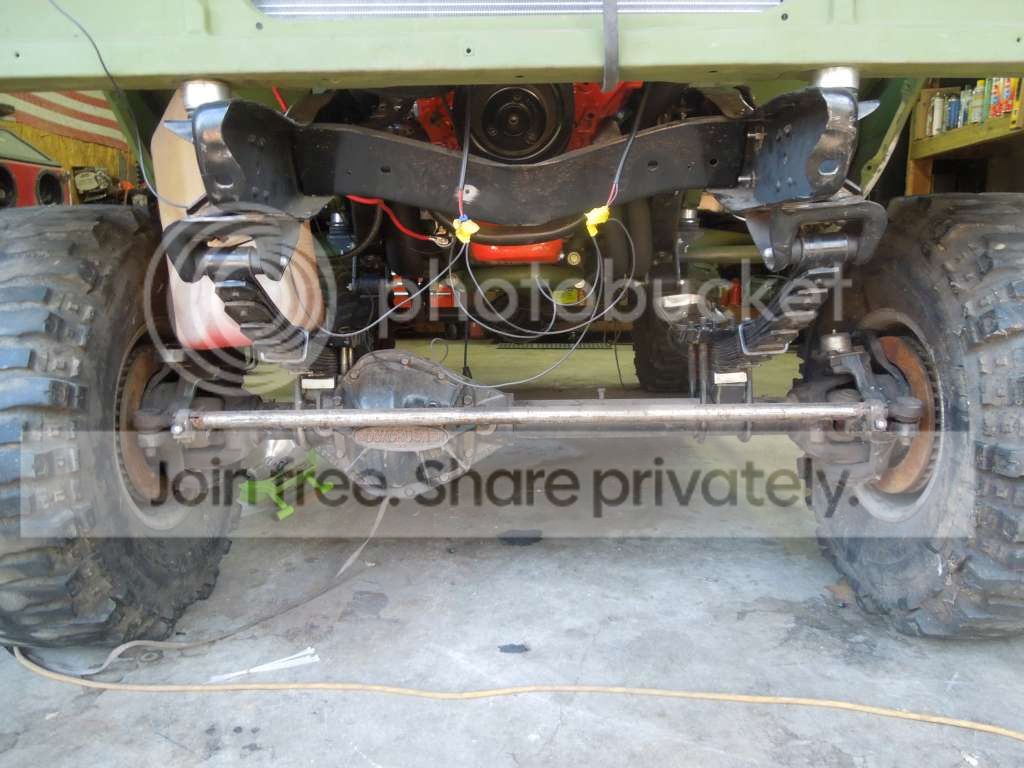

I think that I found what was wrong with the front end.
Any suggestions? The B2 looks like it's for 73+ again.
ps. Heath, I know that you're going to say links, if I can't find a solution......let's talk..:doah:

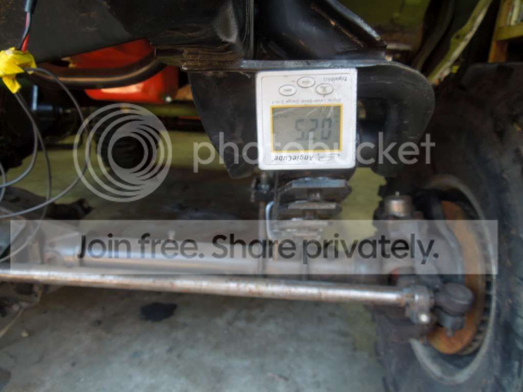

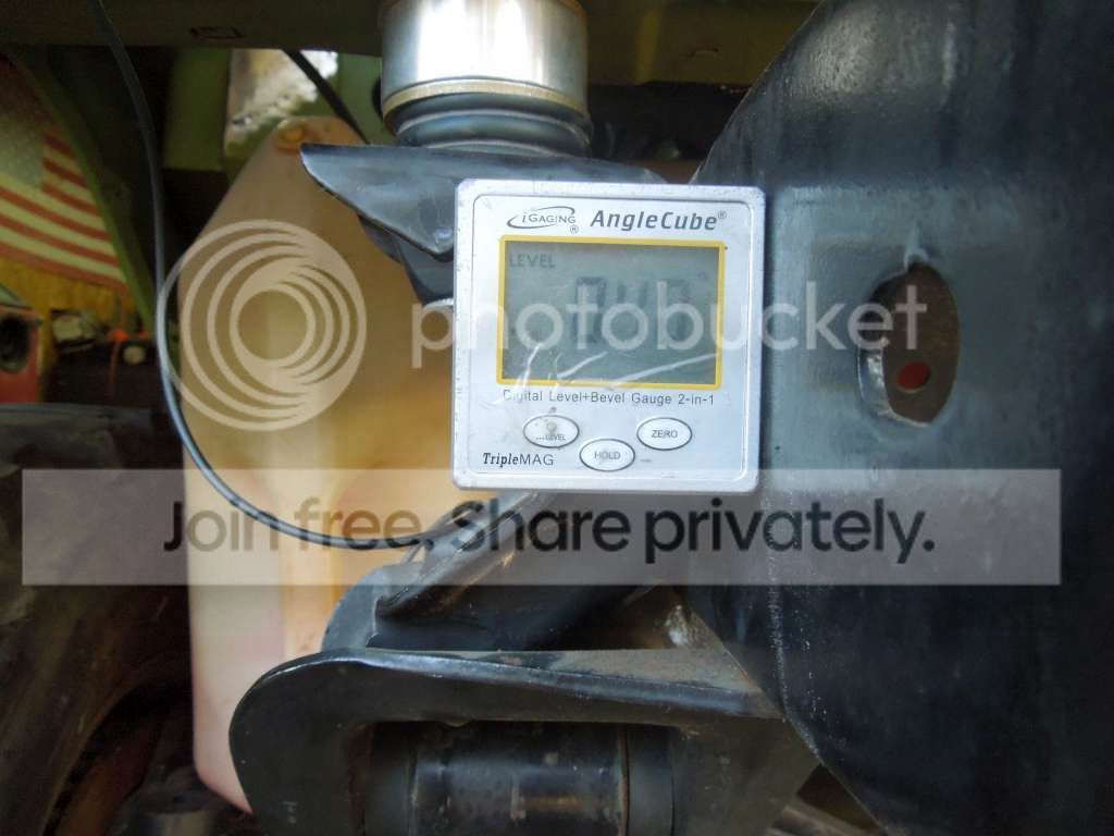

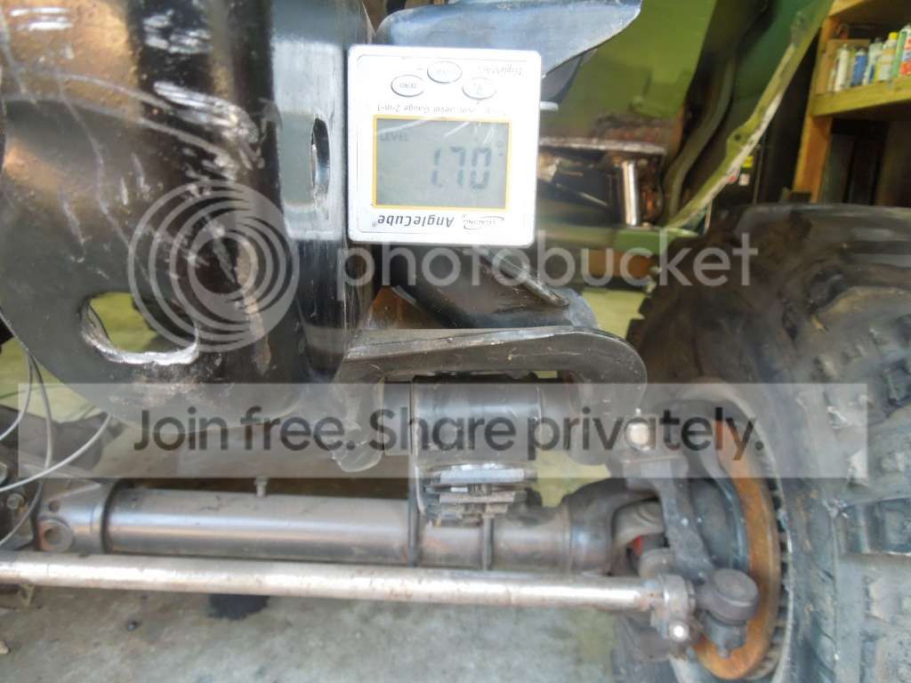

Oh.. this puts me out about 5/8-7/8" out (high) on the drivers side of the core support..
You know now that you mention it my "69" has been bugging me since I put it back together in the very same way. Just a tad higher on the drivers side, maybe even those exact measurments. I just convinced myself it was from me using my old probably UN-sprung stock rear springs. Now you got me wondering?

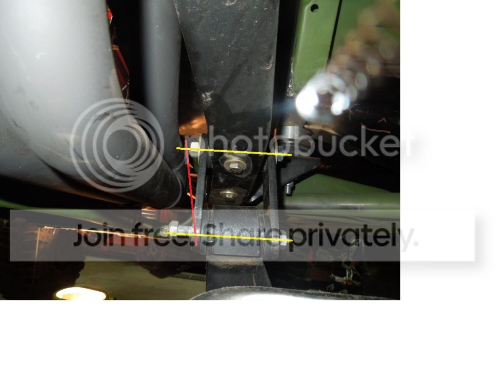

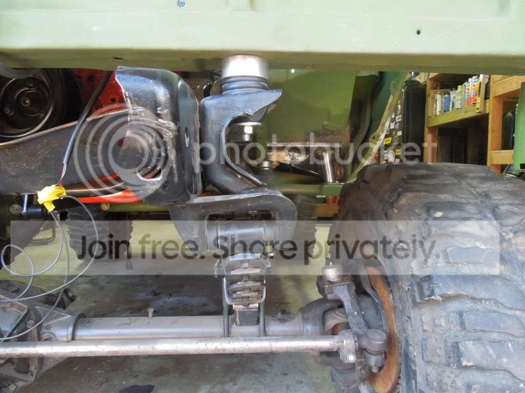

Now that I look at the entire front drivers shackle, it took a hard hit strait down at some time. The rivets are bent at the top and a gap at the bottom. Though, not enough of a gap to bring everything in right. :confused:
I'm at a crossroads of, find another drivers shackle from P&P and bring in the front square with tube for the winch, or call enough is enough. Plate these rails and with some with help, figure out a simple link.....or something...:dunno:
