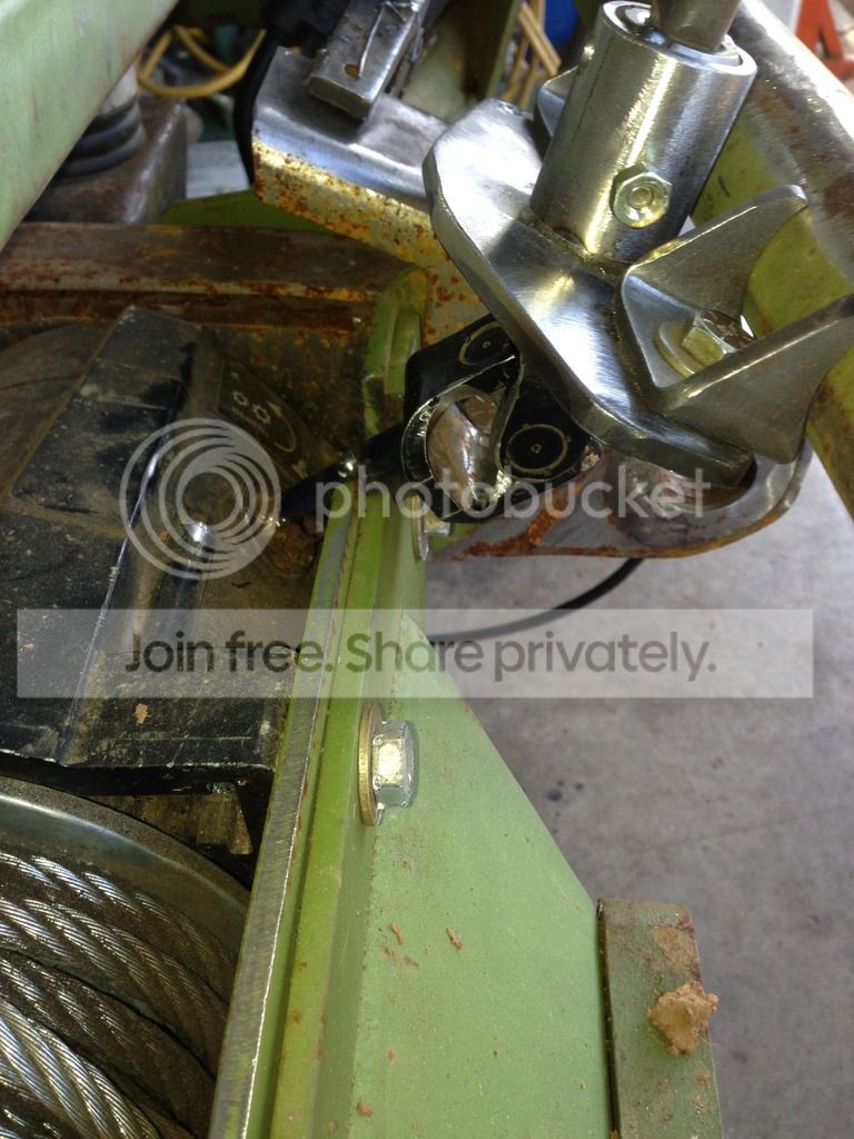

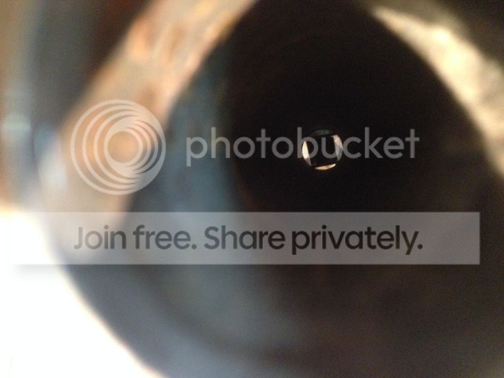

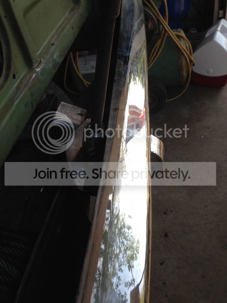

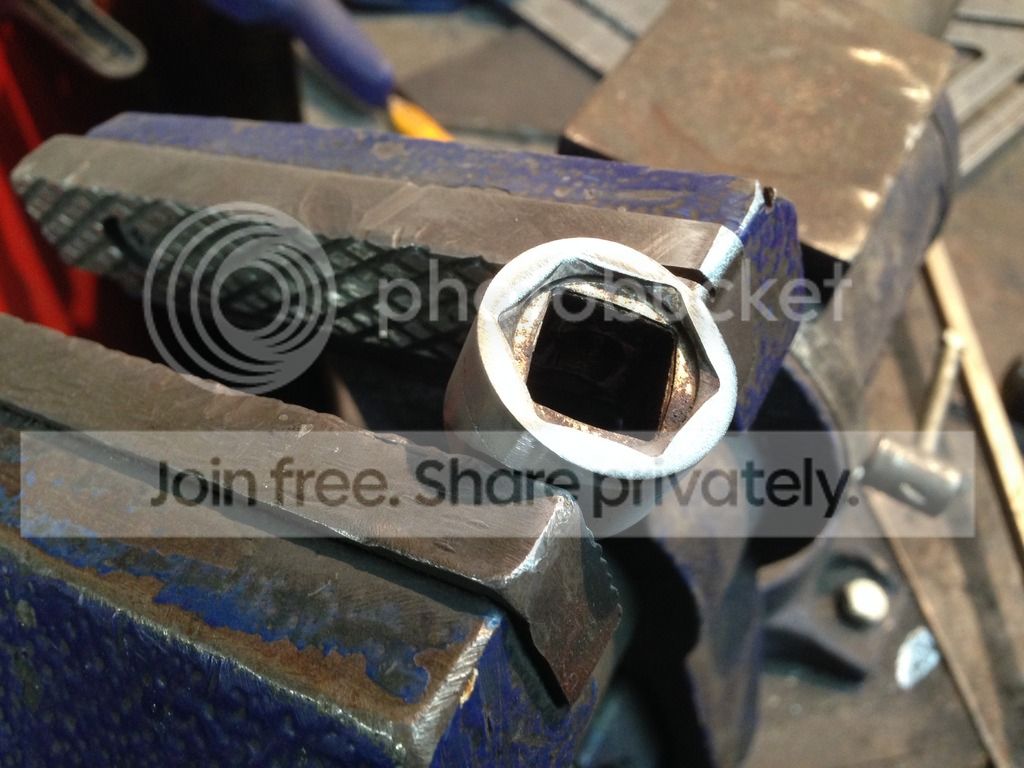

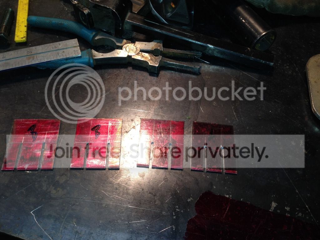

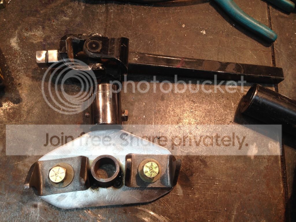

I picked my project, pretty much where I lefty off. Finishing the hidden bumper winch handle. I've been thinking about this thing for years ever since I built the front end. Never knew if it was going to work the way I had envisioned.
On to the pics, Gentlemen.....

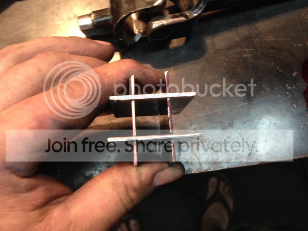

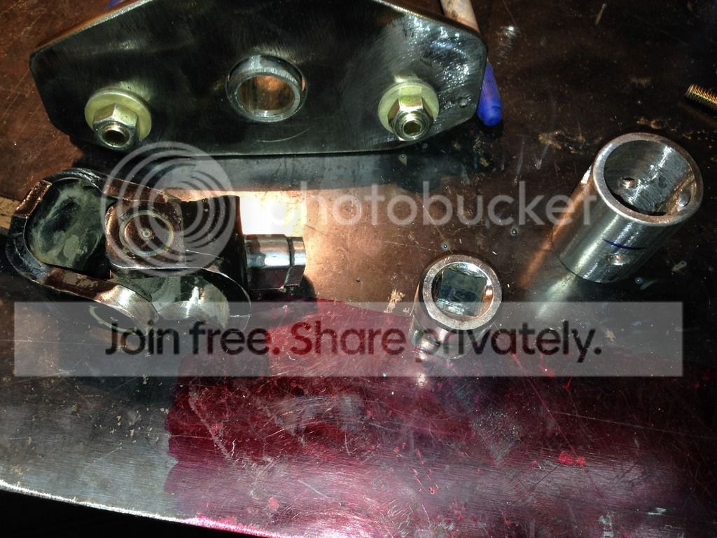

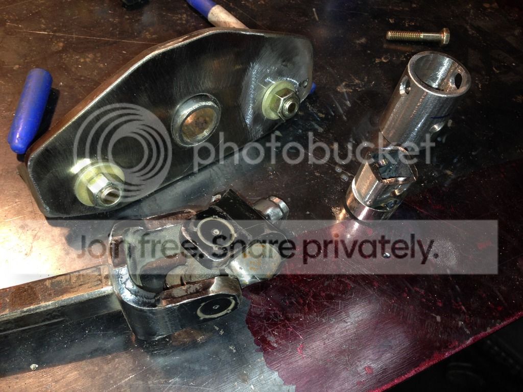

Started last weekend for a couple hours trying to come up with a proof of concept piece that I could hold in my hands.
I got to roll these around and see what might hit, Or, if it would even work. The spacing was going to be too small between the center hole and tube tabs. So I started over with everything this morning.
These are actually a very small rectangle. The steering knuckle only fits through it one way.

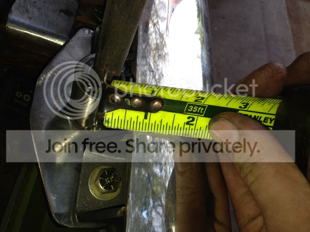

Looking down at my clearance...

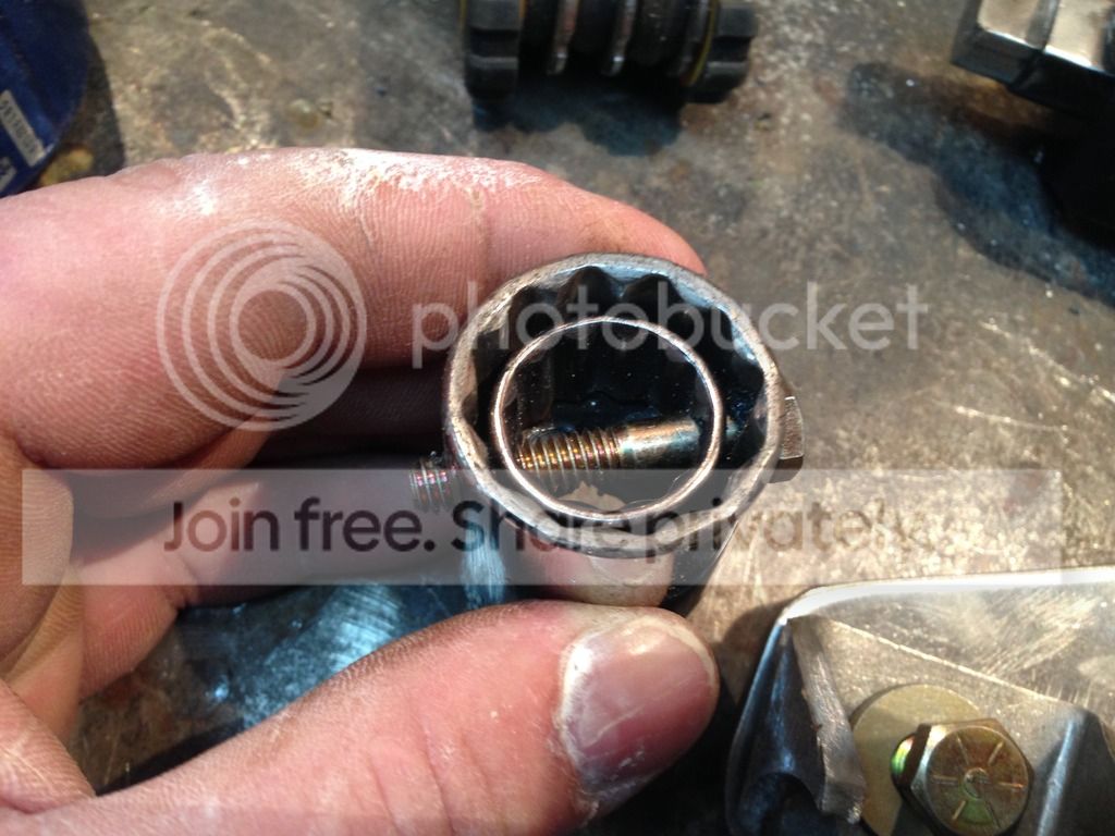

Cut down a 3/4" socket as one of the pieces.

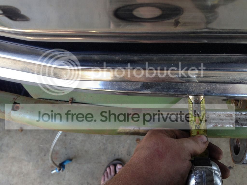

Put the grill on to see where everything lined up. It ended up at about 3/4" from the back of the tube bumper to the grill face.

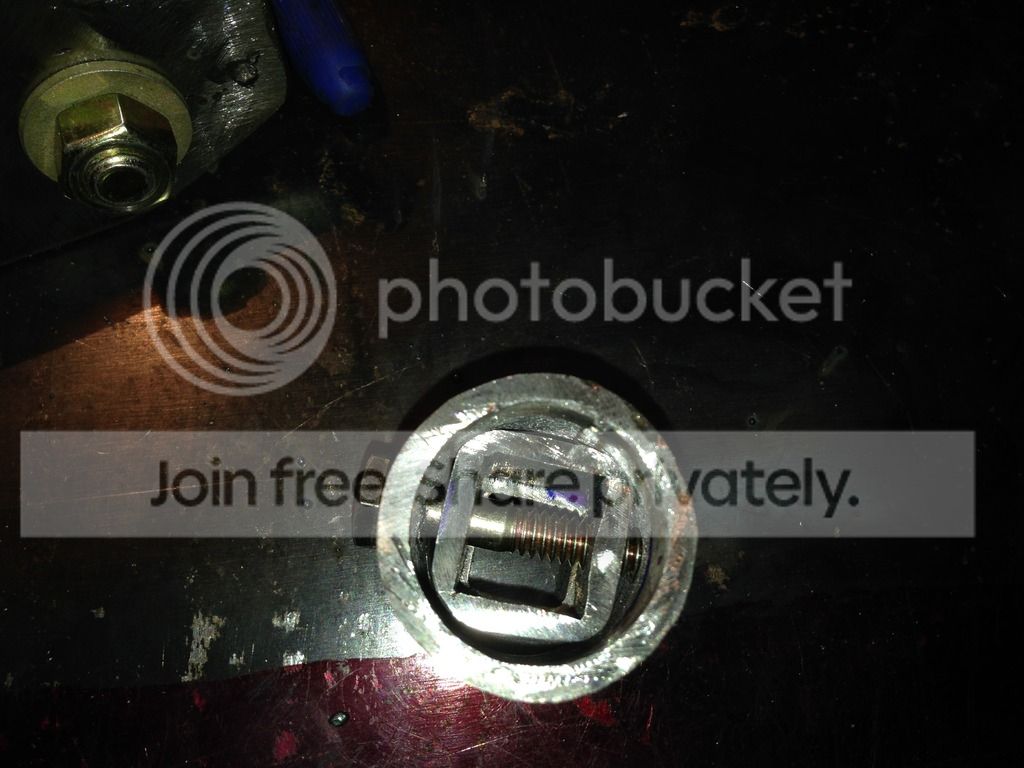

The parts..

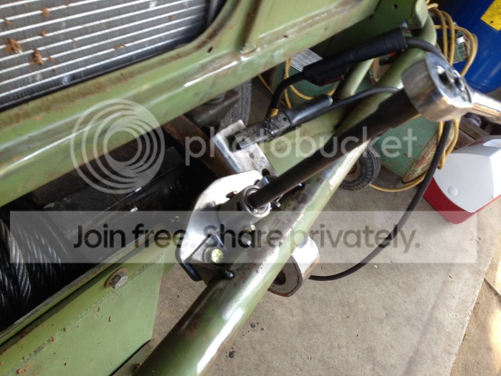

And what she looks like mounted.
And some of the winner shots. I'm still not there, but I'm close. I think with a little more finesse, a new bolt set up, maybe shims under the tube tabs, I might just make that 3/4's inch I was shooting for.
Well, that's the show that I brought. Maybe the first, 1st Gen hidden winch (Warn Zeon 12,000) with a steering knuckle handle to an inconspicuous access point that I've seen on the site.
