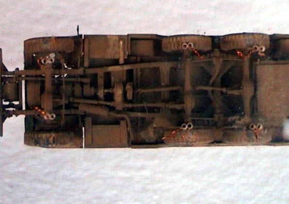

Rear axle set up is wacky. Not like highway tractors but twin drive shafts to t-case using PTO to drive rear axle!
This is a model but is extremely accurate to real setup.
Look thru this resto album and you'll get a good idea of what Dodge did.
